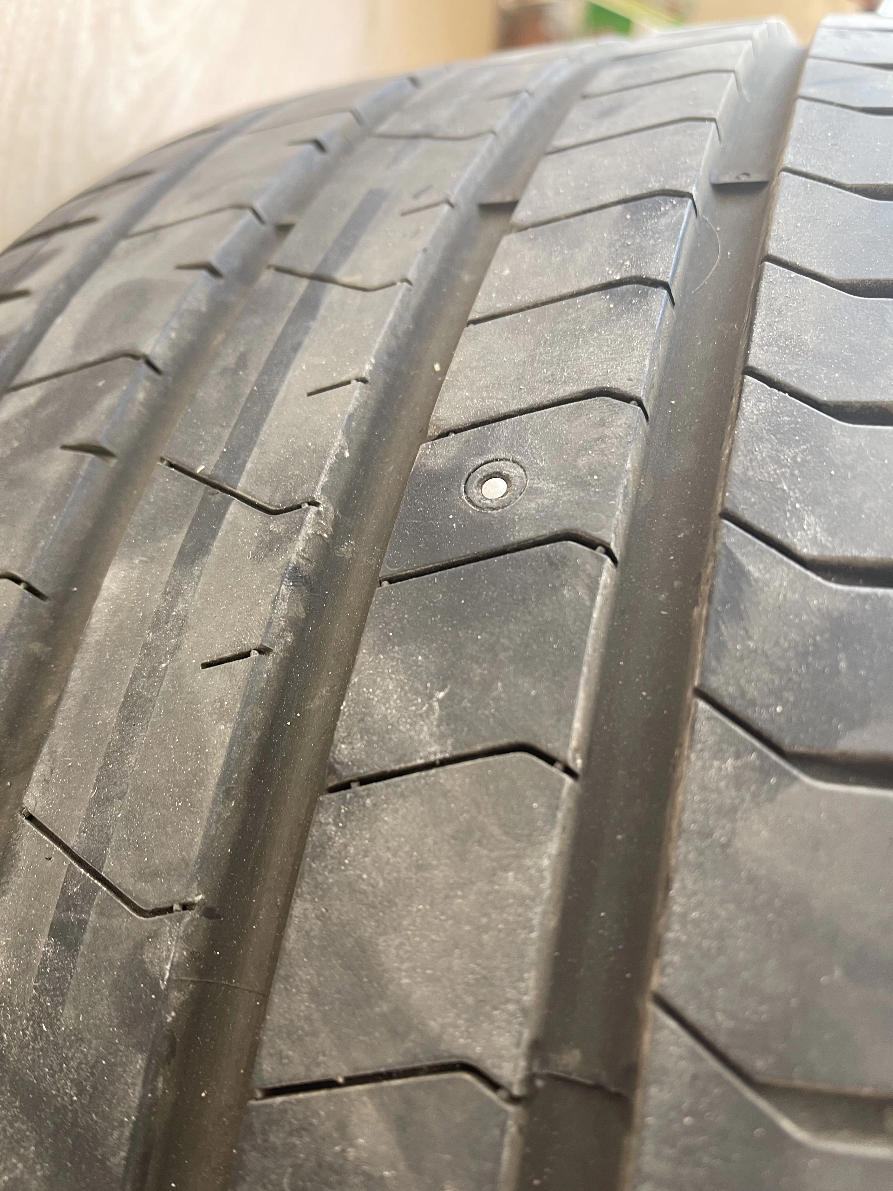

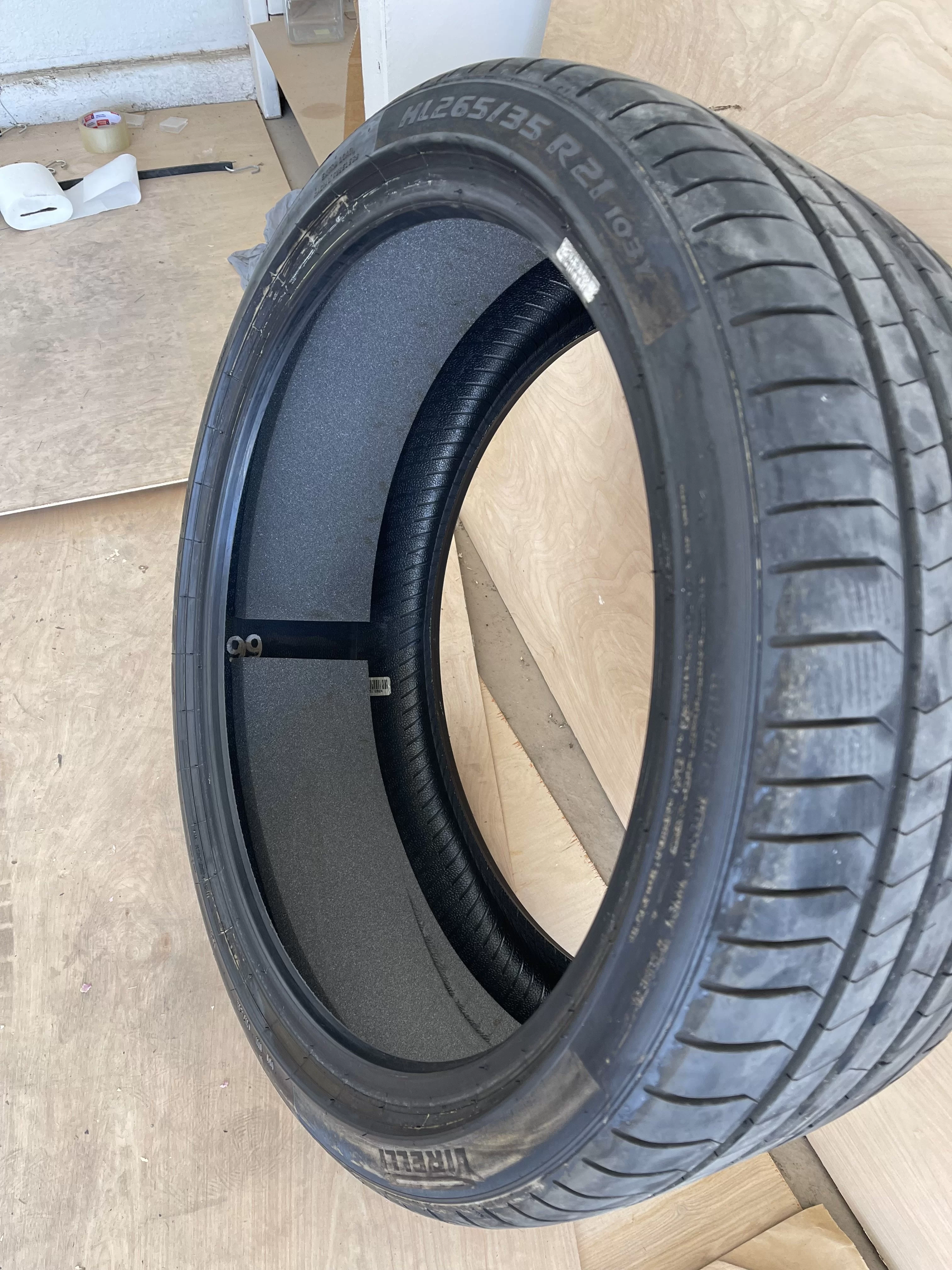

I thought the same thing. Lucid tire has 3cm foam inside the tire and the Lucid Service told me that the tires need replacement and cannot be repaired.
I will post a picture of inside the tire soon.

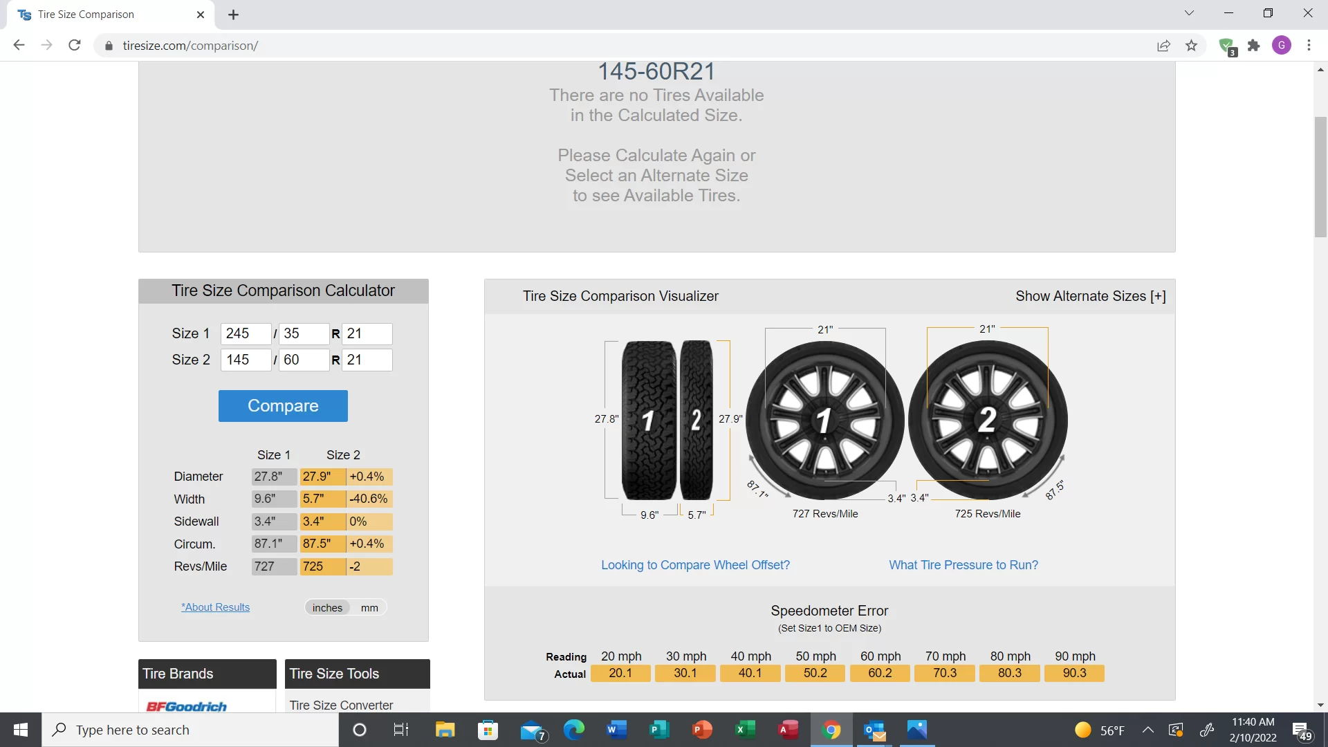

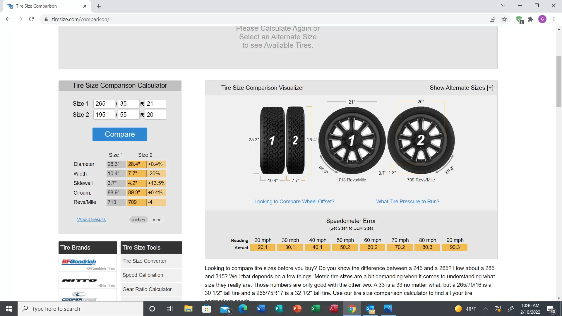

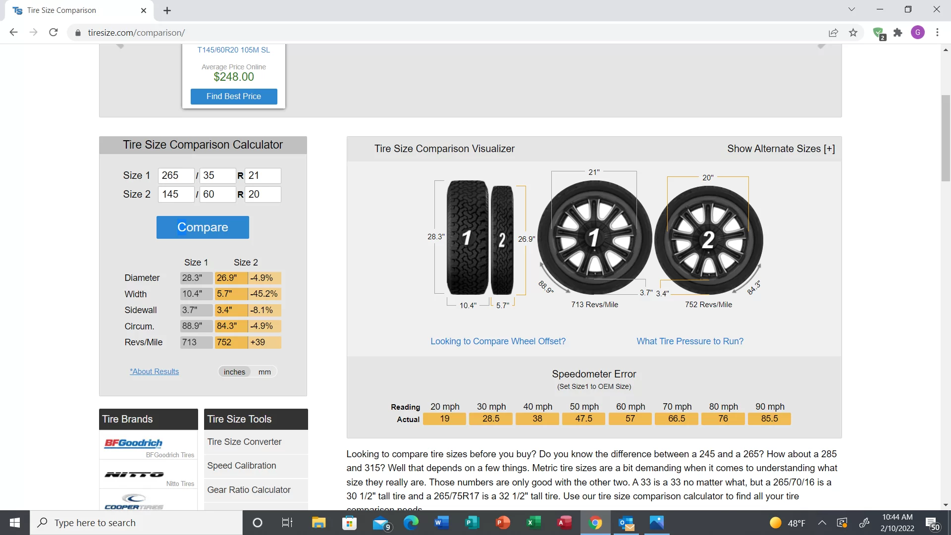

Hi , sorry for my delayed response, it’s been an insane week and your new car required some research. Ok, I am going to give you lots of info on your super cool new Lucid with two sizes of 21” wheels. I want you to open all the screenshot attachments as you have choices on spare sizes from us. Having 2 different tire sizes makes it slightly more complicated. We match our wheel and tire to the diameter of your factory tire in order to get an appropriate size for a 2022 vehicle that has very sensitive electronics to any variances in tire sizes.
I recommend our 20” x 5” alloy spare with our Toyo tire size 195/55R20. See the screenshots, the (716) is an almost perfect match in diameter and the front tire(712)is a 3.3% variance, which the OEMs tell us to stay at 5% and below. This is a Toyo tire with a 15,000 mile warranty, is 28.4” in diameter by 7.7” wide.
Choice number 2 #715 rear variance comparison is with our 145/60R20 compact spare, it is less wide than the 195 is 4.9% variance. Screenshot 717 with your front tire is an almost perfect match.
Either way, you have a choice, both are $389 plus shipping and both are in stock, we have a 10 100% money back guarantee. Please let me know your questions and thanks for letting me know this car is now on the market.

So from her email, sounds like 716 is the way to go?

For DeaneG:
You can repair it temporarily. You cut out a small section of the foam and use a standard repair kit; I had previously confirmed this with service. It will just “thunk” a bit as it rolls and as such isn’t a permanent solution.
As for *permanent* repair, you can’t. For that you need a new tire, due to the foam.

Yes, I think the 716 would be the way to go. I have not ordered one yet as I still have no idea when I am going to get my Grey/Mojave that I confirmed mid-November.
