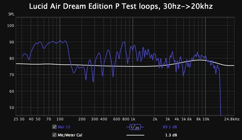

Below is the results of some test loops between 30hz-20khz. I used Room EQ Wizard on my laptop, connected to the Air via bluetooth.

  • Bass goes a long ways down, but has a -3db of 44hz before it levels off and then stays solid to ~26hz. This means a few of the deeper bass hits lack "oomph" but are not by any means missed.
    • This is something that could be adjusted for in EQ and I'm surprised they let it remain. I would have dropped the mid bass down ~5db and bumped up the absolute bottom to compensate.
    • The sub clearly rolls in at 150hz and has a lot of output. However, it isn't booming which means some tracks can feel light because we're used to overcompensated low-end in car stereos. This means you get a more "real" sound, but can lack a bit of excitement unless you crank it.
  • There's a dip after the sub where the mids roll in, rising to a pretty big hump at 700hz before rolling back as you go higher.
    • The midrange is very healthy. Music might seem more "full" than you're used to - that is how it should sound!
    • Lots of car stereos will lack output in several spots of 200hz-2khz range, resulting in entire instruments going missing on tracks (either due to DSP, reflection/cancellation, etc.) The lucid does not have this problem, despite the jagged response due to room modes.
    • The dip on the lucid at 130-200hz isn't that big of a deal as you won't notice it, except with very cello-forward or string-bass compositions.
  • The treble is a bit bright and could cause a bit of fatigue on long sessions.
    • That peak at 8khz is pretty noticeable, and some tracks might end up harsh.
    • The treble ends abruptly at ~16khz for some reason. This is probably the DSP as it definitely doesn't look like a natural rolloff on the tweeter. Since I was running pure 2ch output this could be Atmos' fault. It won't mess up your listening.

I'm guessing the y-axis in the graph above is dB. I'm not into designing audio amps but I'm an analog/mixed-signal circuit designer - feel free to get as technical as you want.
1. What is the input to the sound system and what exactly is the expected output?
2. The 10dB drop from 100-200Hz sounds like a lot. That goes back to my first question - what is the expected output?
3. You were referring to a 3-dB rolloff point of 44Hz. Ideally, you want that to be flat all the way down to 20Hz? I guess that is something difficult to achieve?

Hey @pam4_AGT - thanks for the questions. To clarify, I don't design the amps from scratch but instead use a lot of off-the-shelf components to build my systems, though I do design the crossovers for passive speakers myself. You're going to know more about the circuitry side than I am.
Answers:
  • Yes, y-axis is DB.
  • The blue is the recorded response from a miniDSP Umik-1 with calibration file. The white line represents the calibration file adjustments to output - effectively it shows the db bias of the mic which is removed from the recorded response
  • Input is a flat test sweep from REW from 30->20,000hz. Expected output is of course ruler flat.
  • The drop is pretty large, but also not unheard of when you have a lot of drivers in a system. I would expect a more gradual drop into the 300-400hz range instead of a big dip and rise beyond that. There's a lot of potential causes here, but nothing that can't be EQ'd out.
  • That shelf on the lower end below 44hz is pretty odd. Usually there'd be a much more gradual dip. A system like this should have a -3db closer to 37hz and a long slope downward below that. It could be caused by having two separate drivers on the low end.

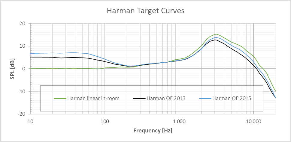

So that curve looks a lot like a Harman curve, except the peak at 8kHz is happening a bit late. But otherwise, it's got the nice bass bump, treble rise, and rapid fall off. 16kHz is fine. Most of us are too old to notice.

  • Good point about the Harman curve. I'm an outlier in that I prefer a flatter response, but that's me being a nerd :D
