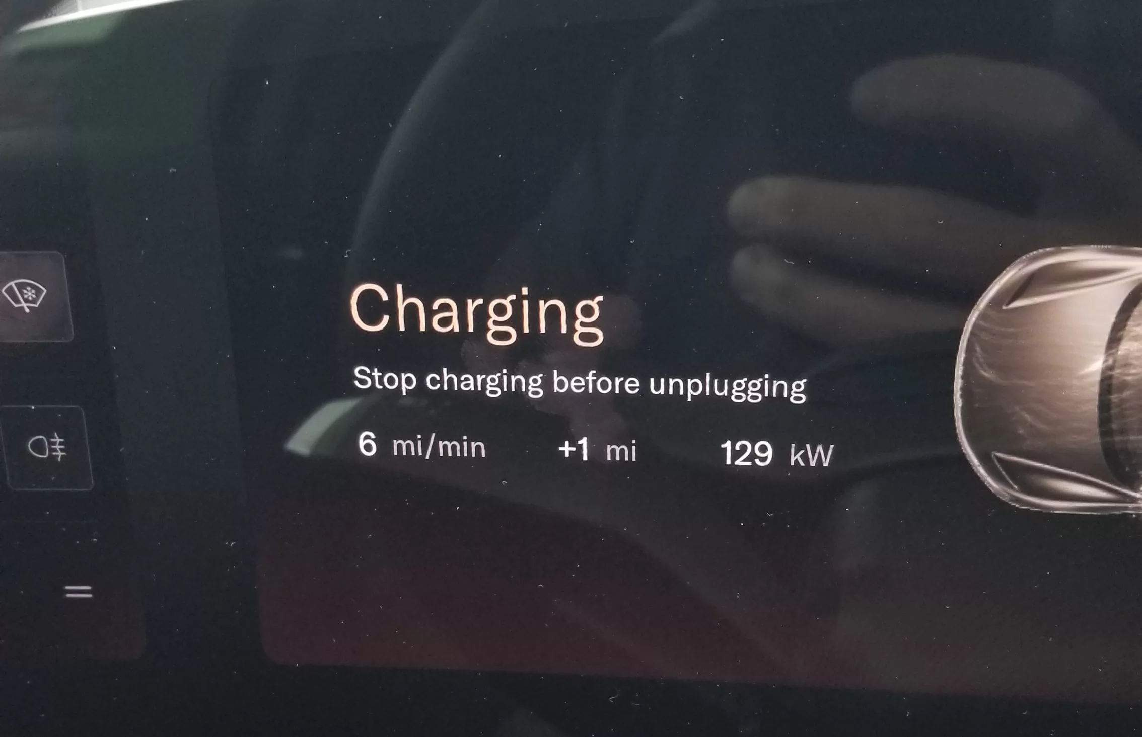

This is on a 350 after preconditioning starting at about 30%. Dropped to 123 almost immediately
This is on a 350 after preconditioning starting at about 30%. Dropped to 123 almost immediately View attachment 10526

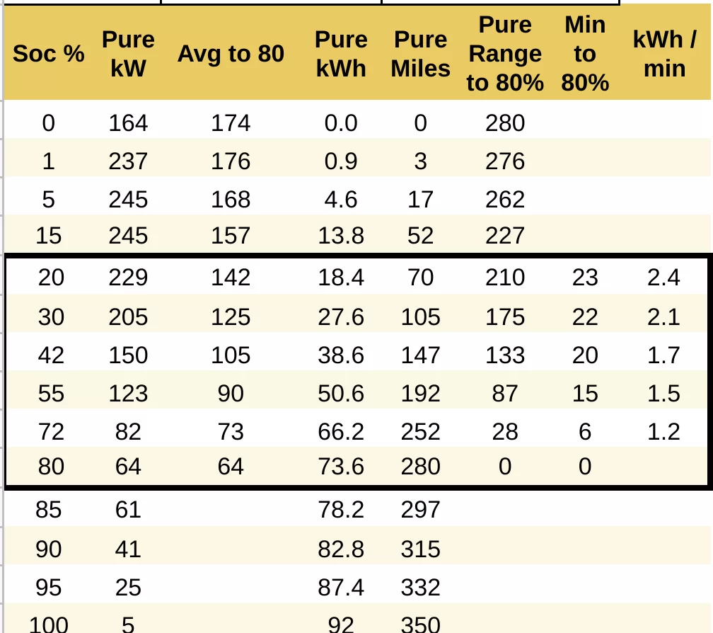

For Air Pure I used the publicly available charging curve and 3.8 miles per kWH I averaged in 2k miles 50% hwy 70mph HA average 60mph and 50% streets 5 over the limit.
On a 350kW charger this is the best I can expect. The fact is I am getting about half the expected speed on 350kW or 150kW in general.

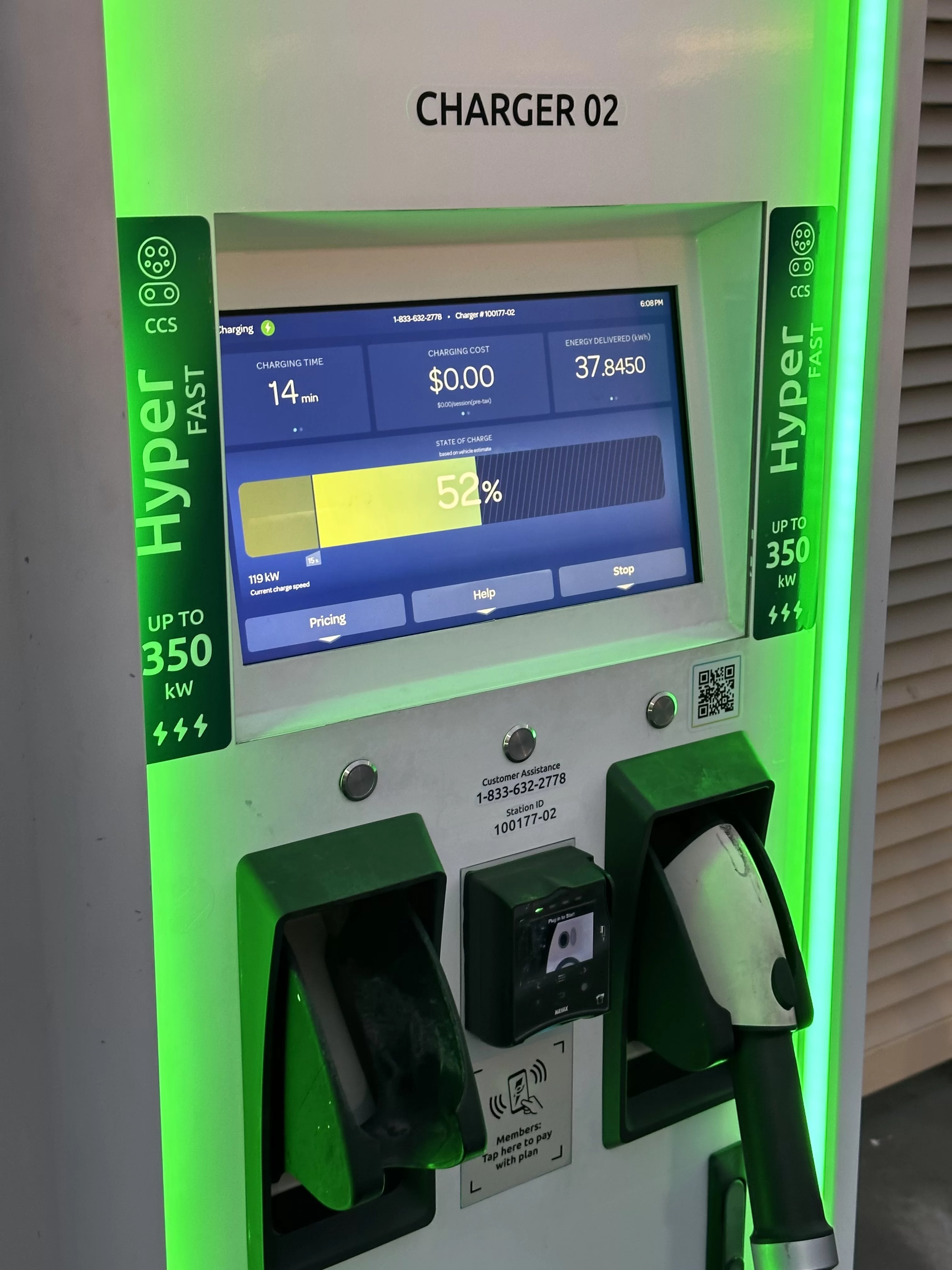

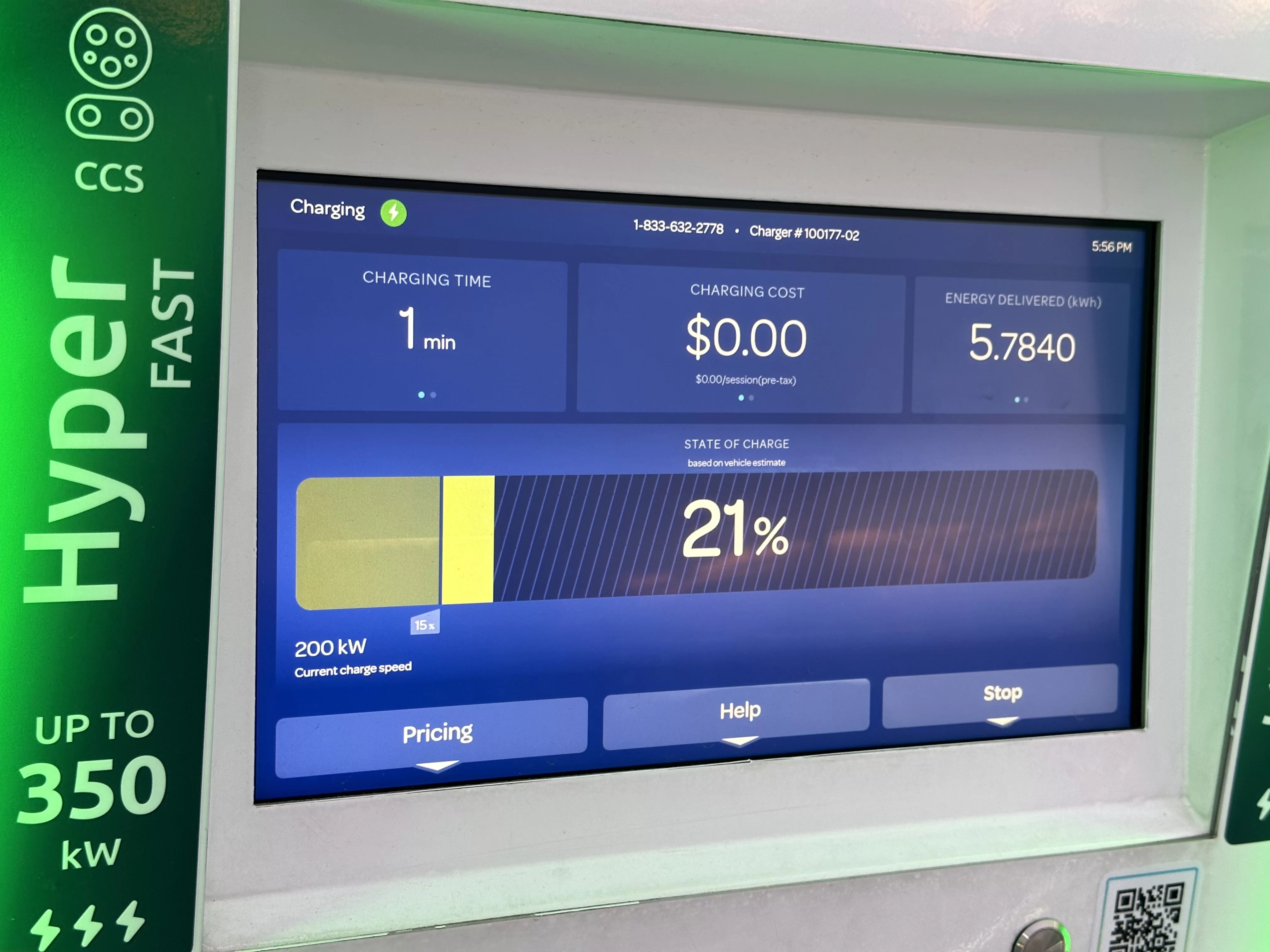

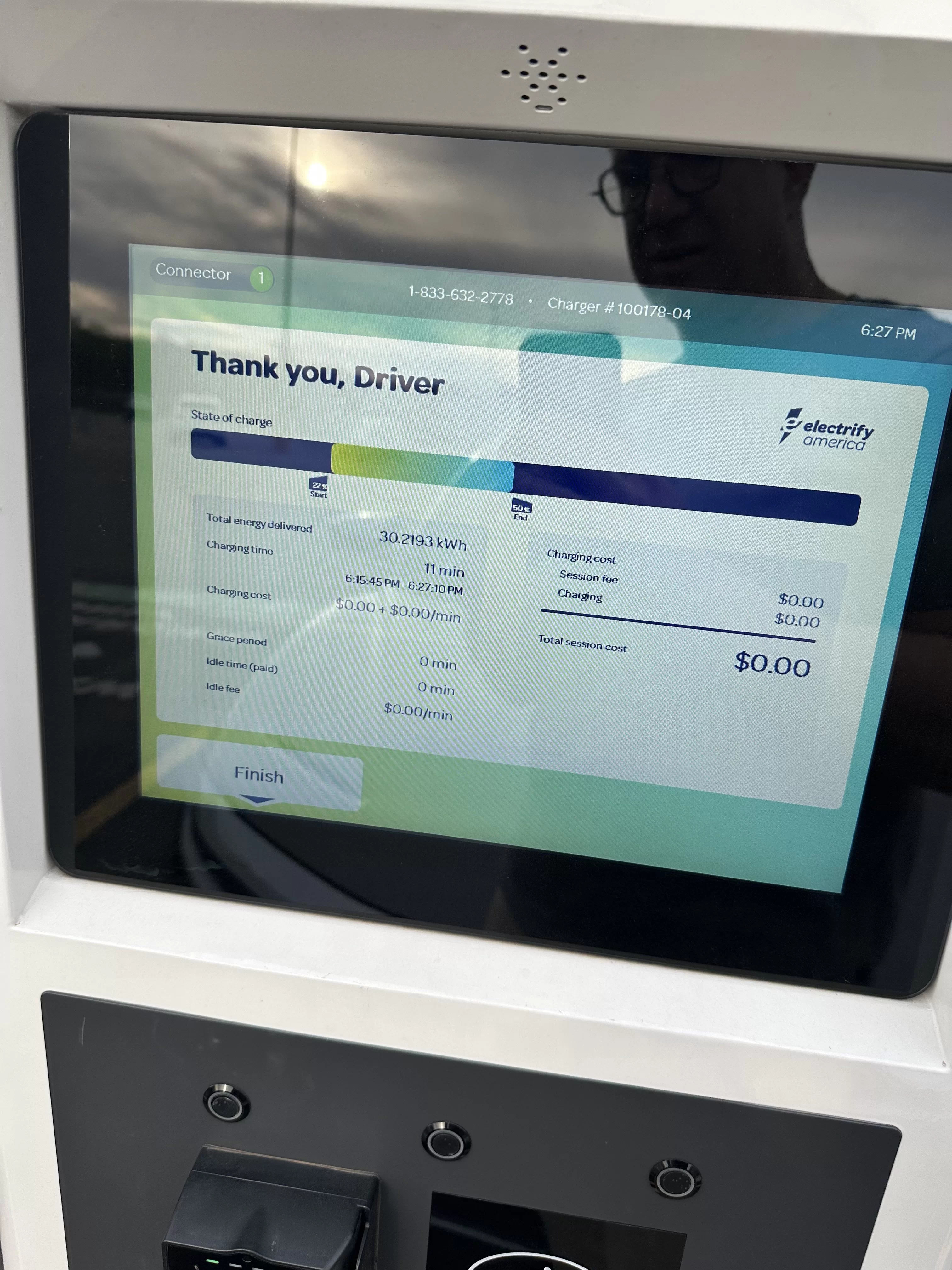

Hello all. I have to say this thread has really disheartened me about completing my order for my Lucid Air touring. The advertised charge rate was the #1 reason I’m getting this car.
A bit about me I’m an EV enthusiast. I had a Nissan leaf in 2015, BMW i3 in 2018 now own a Kia EV6. I road trip a lot between Austin TX and Florida as I own a vacation home in FL.
My Kia EV6 has been awesome, and I never duly appreciated until now. I regularly get 230kWH at EA (can’t remember last time I didn’t) and continue to get 110kWh even at 85%. I asked about this on another thread and a moderator arrogantly told me my numbers “can’t be true”. I’m attaching some photos of my Kia. Also, fwiw I already splurged and bought a lucid home charger in anticipation of my new car :(
I’m hoping someone.. anyone.. here can tell me what I want to hear which is that Lucid is ahead of the EV tech pack. If they’re not… what am I doing dropping 100k on a car when my 55k kia can do better?

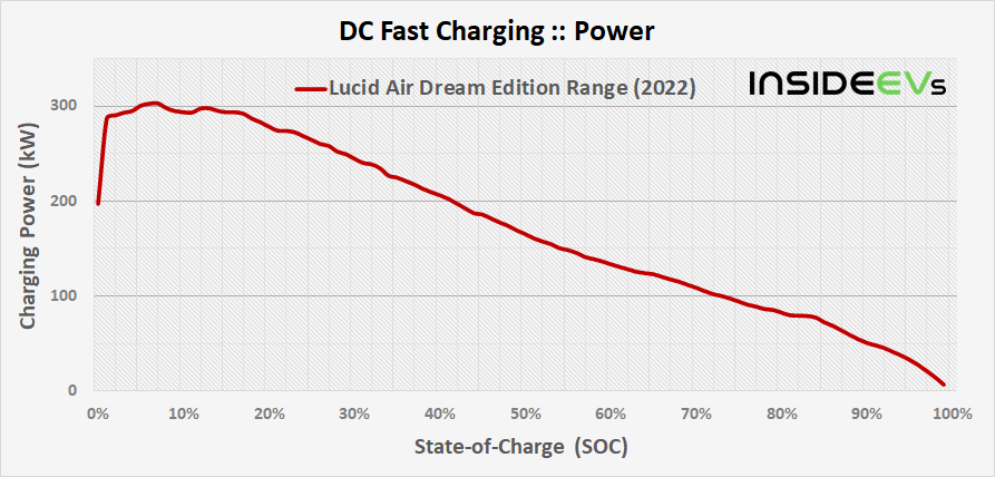

As an EV enthusiast, I am sure that you know that power is measured in kW and energy is measured in kWhr. Energy is power multiplied by time. The power coming from the charger or going into the battery is measured in kW. The total energy supplied to the car or going into the battery is measured in kWhr. Below is the charging curve from Inside EVs for the Lucid.

@HariK , would you happen to have a link to the Touring table data? Or otherwise direct me to where to find this table for Touring? Thanks
The battery of touring and Pure AWD are pretty much the same size 415 miles Pure AWD vs 425 miles Touring. So, you can use that table as a decent guide.
I basically de-rated the charging curve using the voltage differebce between Pure and Touring and my observations in driving 2k miles on Pure AWD since Dec 30th.
