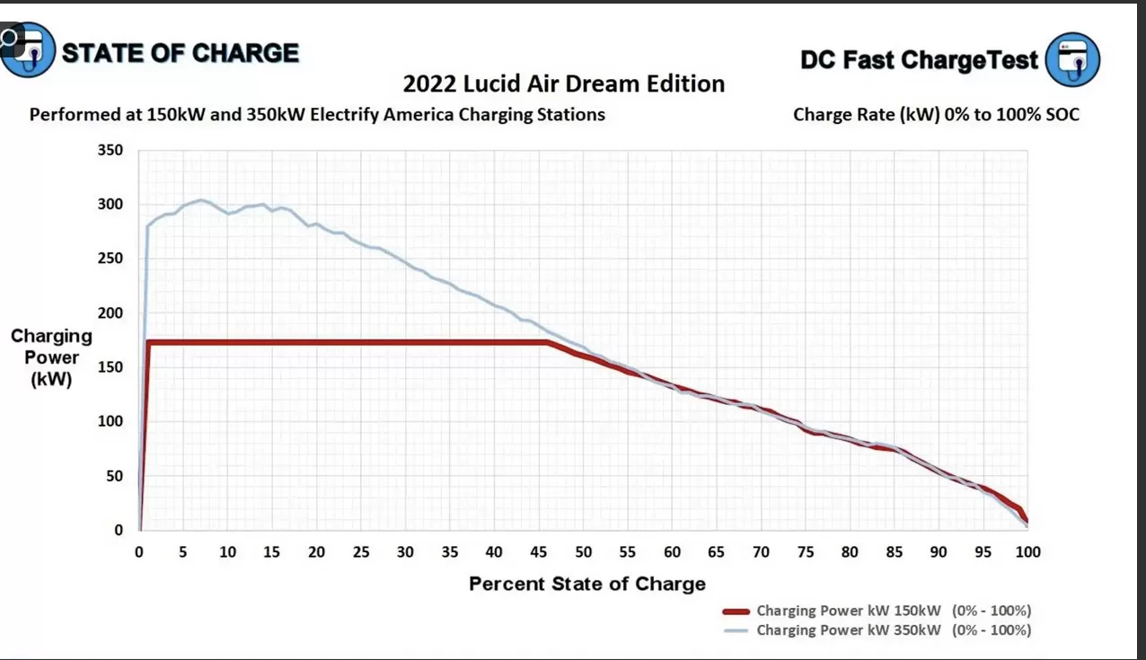

While you are doing better than I am, falling off fast from 300 is a sign of a problem. Your remaining charge sessions are very sub-standard.
Interesting. Could you explain how we know that falling off fast from 300 is a sign of a problem or that my remaining charge sessions are very sub-standard?
Mine charges typically at 160 to 180, but on two occasions it started at 220, but fell off within seconds. Even Lucid does not think that is good and is finally paying attention. Your 300 figure should persist for more than seconds. The fact that it hit that would tend to indicate the charger was capable, but your car stopped accepting the charge. Really, just open a ticket to discuss this with Lucid.
I am not there and not Lucid support. If you choose to ignore the symptoms, that also is your choice.
This curve is expected. Even under optimal conditions car will only charge at 300 kW for a short period.
Looks like most of the 300 kW charging is from 0-20 percent, when most people don’t normally charge. So the peak isn’t really to be expected on normal charges
Yep. I hit 301kw at 16% SOC with pre-conditioned battery. Haven’t got remotely close to that since.
So, just as with with many things EV, it’s a bragging right, and not much more than that in real world applications. You know, “rated range versus what you actually get when driving normally; high charge speed for sure but it’s only available at the very low end of battery capacity, and only for a very limited time.

Going from 20% to 80%.
From ~46%-80% there will be no difference between a 350kW and a 175kW.
Going from 20-45% the 350kW optimally takes about 9 minutes and a 175kW would take ~ 12 minutes.
At 20% charge the max the Air can pull is ~273 and it goes down from there. At ~46% your at 175kW.
31 minutes vs 34 minutes. At this point in time
A Rivian there would be no difference for a 20-80% charge. 37 minutes on a 350kW or a 175kW. At 20% of charge Rivian can only pull 160kW.
A Rivian there would be no difference for a 20-80% charge. 37 minutes on a 350kW or a 175kW. At 20% of charge Rivian can only pull 160kW.. I agree that teh 150 KW charger is just as goo

We are talking a difference of 3 min because it charges 40 kW less from 20-40%
Not sure where you got your numbers. Perhaps you can show your math. Agreed that if just topping off from as 55% is as good on a 150KW charger. What you are not taking into account is that my charge rate is low across the board and the whole 300 miles in 20 minutes is a myth for me. There are some I have talked to whose cars charge properly.
InsideEVs.com did the testing and they have the graphs on their site.
