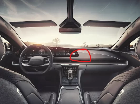

A few weeks ago we started hearing a new humming coming from the front of inside the car (see image) when the AC is on. It's definitely new because we both heard it when it started. It's a subtle hum, sounds a bit electrical hnnnnng. Only happens when the AC is on so definitely not from the screen. I'm guessing it's from some coolant or pump and perhaps the new sound is just from normal degradation/wear and tear.
I'm getting my car serviced for the wiper issue and a slightly detached A pillar on driver's side + some glass distortion on my windshield. I usually just wait and pile up minor issues that come up so when they check the car it'll save them time and money, but they want to charge me $200 just to check whether that new sound is normal or not. Also another $200 to check the louder than usual HVAC fan/motor coming from the frunk.
Anyone else notice louder noise and/or new humming from their HVAC?
