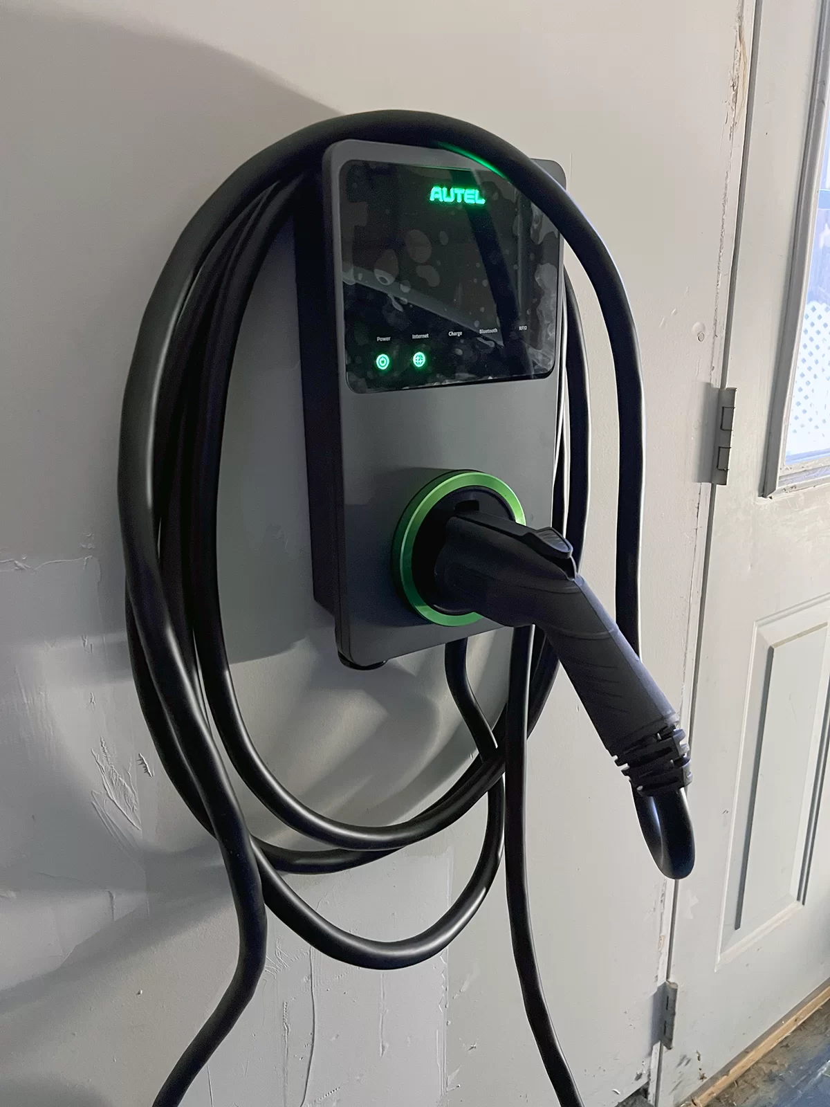

Lucid recommends 80% and to have it plugged into the charger when the car is not in use. I have the Autel Maxicharger wall charger and it is awesome with lots of options. Very nice app, long chord and you can program RFID cards to give to others in your house hold that or friends that have EV and need to charge when they come over.
Glad to hear you like this charger. I had Tesla chargers but switched them out when I got the Lucid. My first attempt was with the Clipper Creek 80, which is a beast and probably the best quality on the market. I didn't realize it would overheat my 60 amp circuit so I am going down to the Autel 50 Maxi. It's sitting on my garage floor waiting for my electrician. I'm bummed I will lose the 60 mph charging rate from the Clipper, but having the junction box heat up and potentially cause a fire obviously not sustainable... Clipper makes a lower amp charger, but I decided to try this Autel.

I am not sure, but maybe the Clipper Creek 80 you would need at rated output from your electrical junction of over 70 amps to achieve the 64 amp charging. And if the charger does not down the amp it's pulling due to that, it would make the wires extremely hot.
Yes, you are correct. The CC 80 needs an 80 amp breaker and wire capable of 64 amp draw. My circuit was 60 amps and couldn't be upgraded easily so I'm going down on the charger... Much less expensive than pulling new wire.
