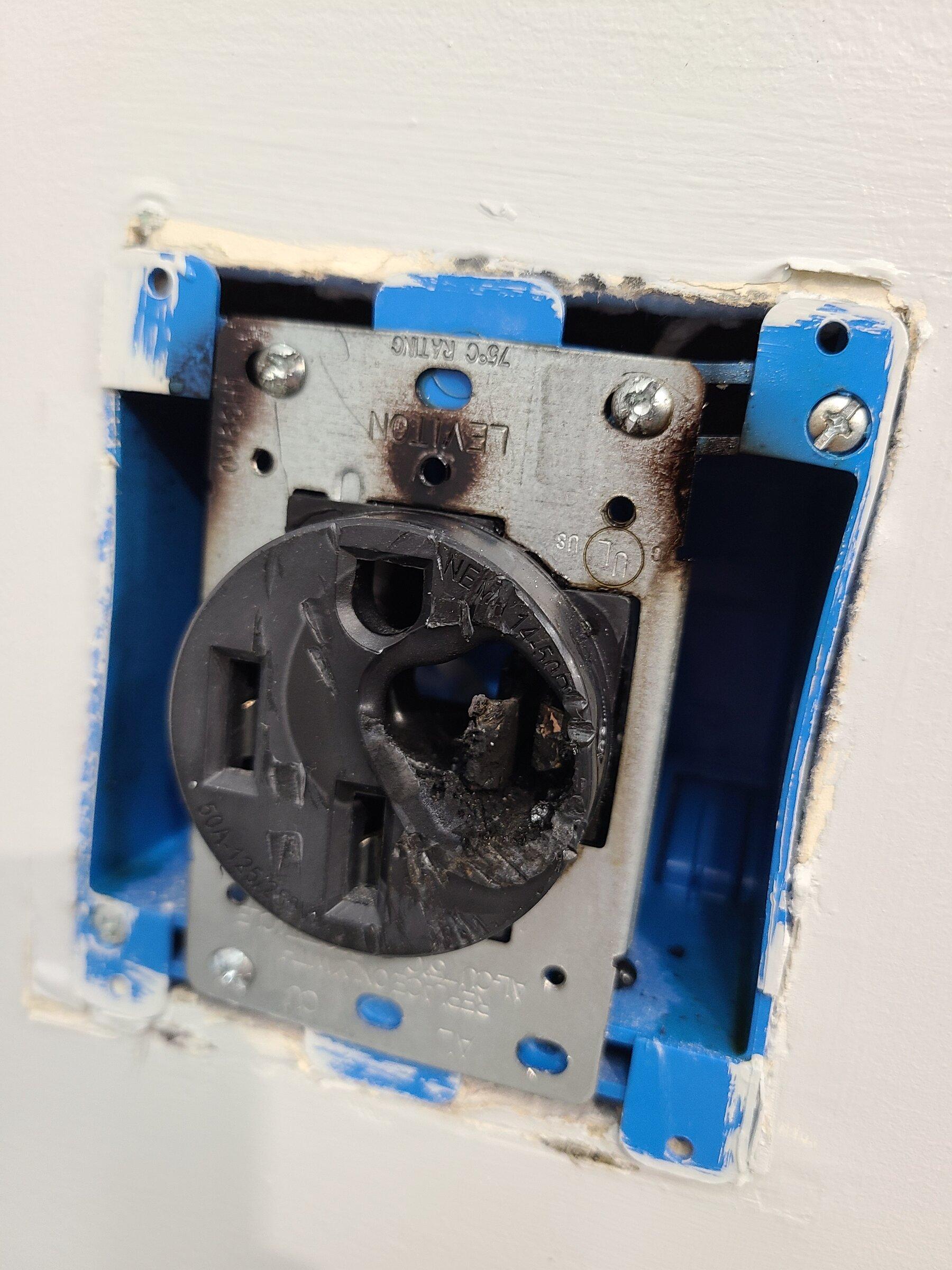

I agree work Dean-O, you might be better off with a 1/4 torque wrench. Most all the torque screwdrivers on Amazon are made for bicycles, which do delicate parts and which rarely need more than 25 in lb. Or 3 NM. Our required 75 in lb is 8.5 NM. And Harbor Freight torque wrenches are a great and accurate value for occasional use. They are consistent.
Remember, the 75 in lb torque setting is really the minimum requirement. You need to get at least that much torque to properly compress and hold the copper through repeated duty cycles. I am sure 85 or 100 are fine. The Hubbell receptacle is a sold block of glass reinforced nylon.
Electrical lug torque settings are not like torque settings cylinder heads bolts or brake disks, that require precision torque for bolt stretch and to prevent warping. Our goal is just to insure that the conductor does come loose over time and use.
All the warnings on electrical lug torque settings talk about the danger of not getting HIGH enough. I have never seen an over tightening caution.
