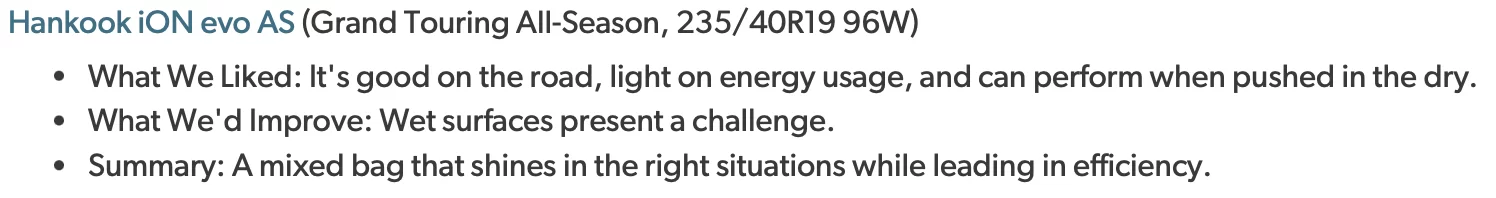

Here's what Tire Rack had to say:

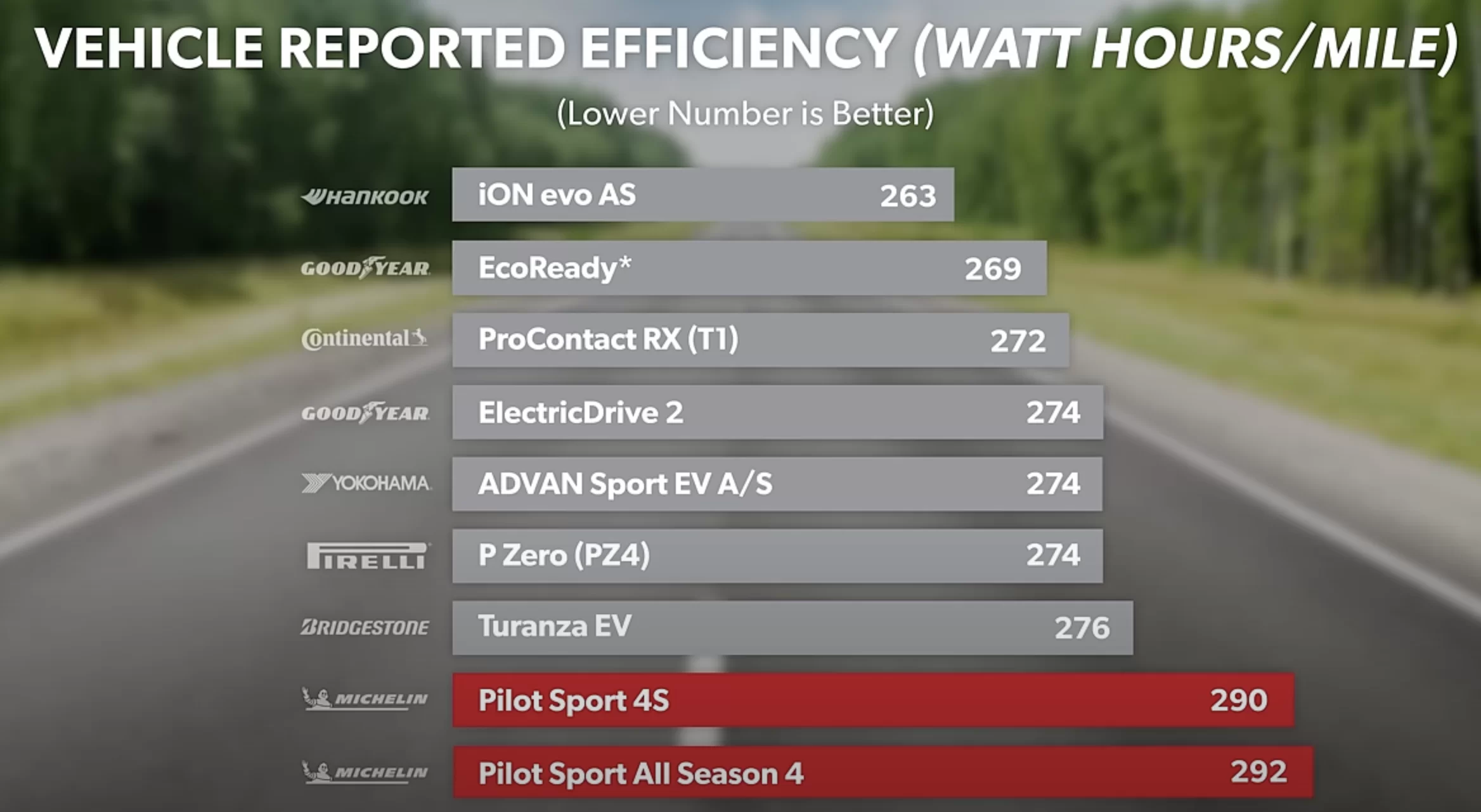

Here you see how efficient the Hankooks are, though. (Note that the max performance summer Pirellis that come on the largest wheels are also quite efficient.)

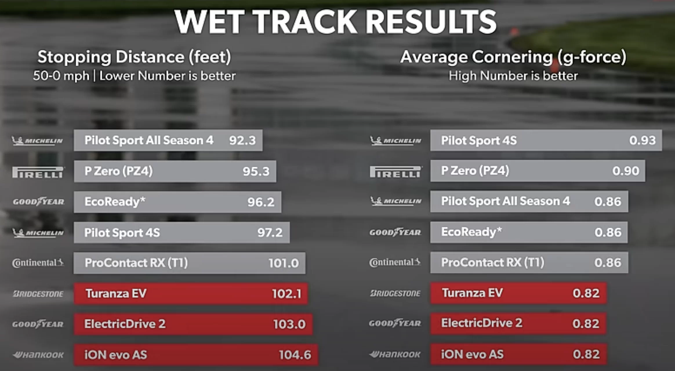

And here you see how the Hankooks fared in wet handling tests:

Unfortunately, tire tests are almost never done using SUVs or similarly-sized vehicles, so about the best you can do in comparing tires is to assume the relative performances of the tested tires more or less hold as you increase the size and weight of the vehicles. They may well not in some regards, but I doubt that it would meaningfully shift the relative rankings on most metrics.
What is interesting is that the Hankook website claims the Ion EVO's wet braking and wet lateral grip are above the "average of premium competitors". In fact, this is far from the actual "average of premium competitors." They derived their "average" from cherry picking only three other tires, two of which score particularly low in these metrics in independent tire tests. The tires that have tested best on these metrics in independent tests were notably excluded from this average. It leaves me with something of an oily feeling about Hankook's deceptive marketing.
I was a little perplexed when Kyle Conner said in his Gravity test drive video that the Hankooks were getting really good reviews, as I had not seen any such reviews. In fact, more the opposite. But looking at the Hankook website I now see where he might have looked to get the impression that the Hankooks were top performers. The only category in which they really shine is efficiency. Lucid gave up a lot of other tire performance metrics to pick probably the only tire that could have gotten the Gravity EPA rating above 400 miles.
Personally, the more I look at the Hankook Ion EVO, the more I conclude I wouldn't have it on anything I drive.
After rechecking my notes, I should amend the above statement. All three of the "premium competitors" Hankook used to calculate the average were tires that have been found by independent reviewers to come up particularly short in wet handling and braking.
