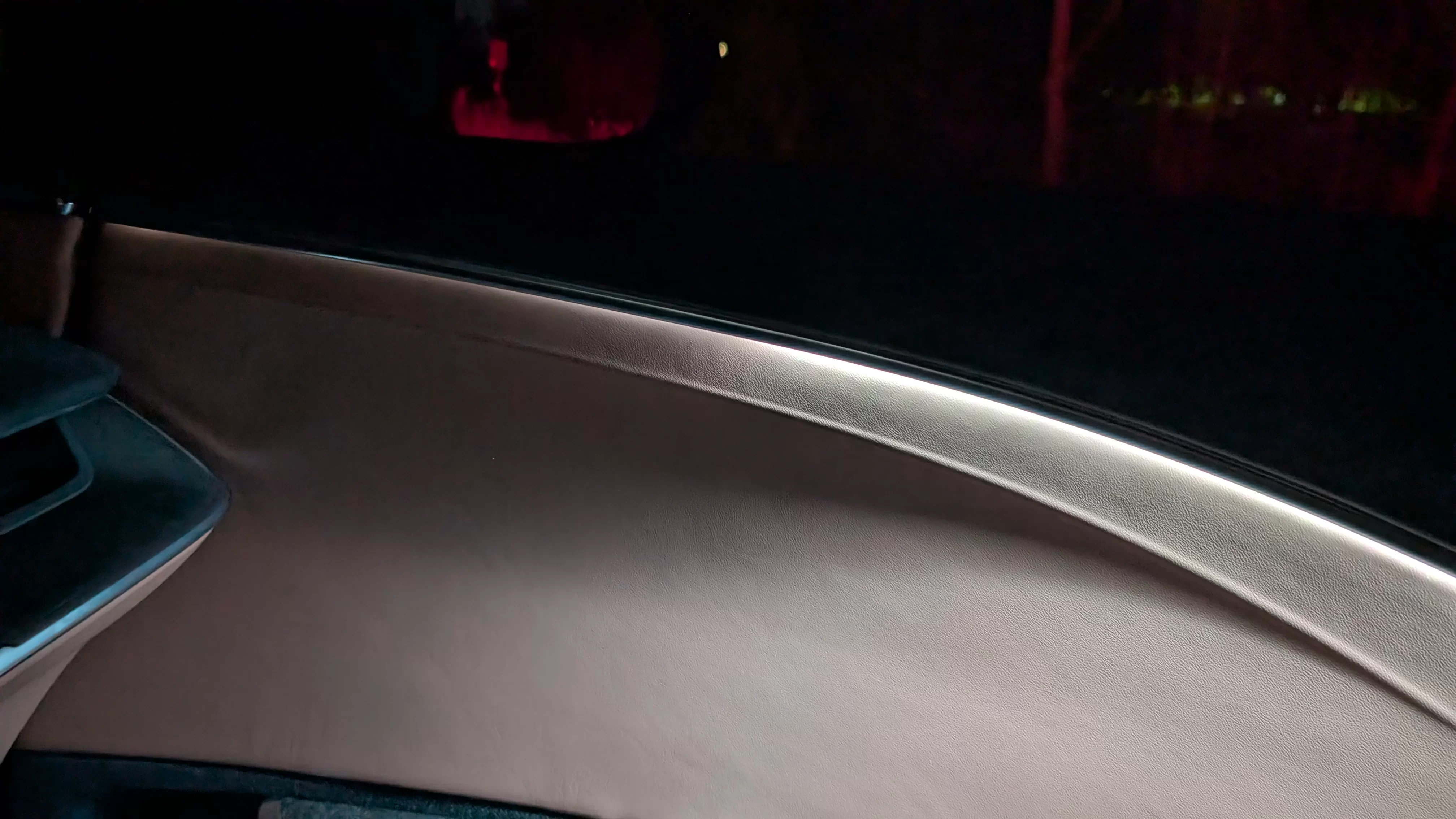

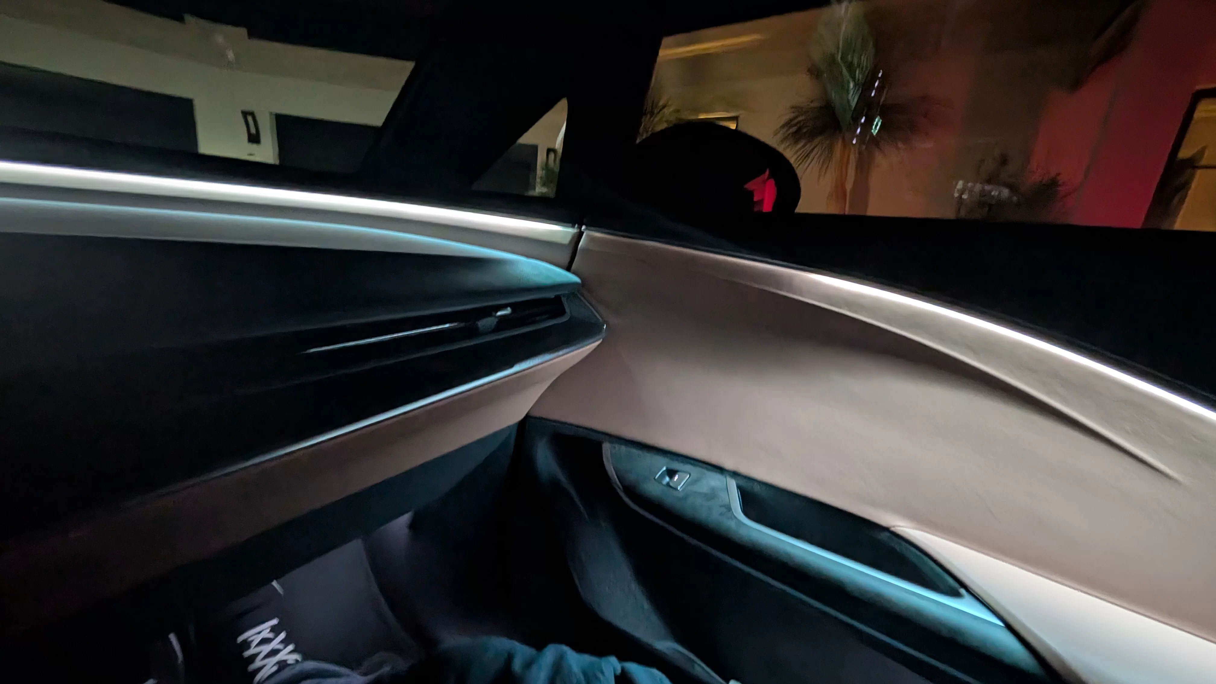

Well, another day, another issue (or two) with our Gravity.
We got in the car after dinner and noticed the first foot or so of the passenger door accent light was out. I thought I would do a reboot when I got home to see if that resolved the problem. It turned out I had to do the reboot anyway, because when I pulled into the garage and put the car in park, I got a red warning "PARK" light and an annoying bong alarm that wouldn't stop no matter what I did. The reboot terminated the warning (with no indication of its purpose ever given) but did not restore the accent light.
In short, it was a typical day with our Gravity: a wonderful driving experience darkened by a torture chamber of false warnings, software glitches, and feature malfunctions.
I'm now waiting to hear back from Lucid whether it's going to take yet another Service Center visit to resolve this lighting issue.
And I'm still waiting to hear from Lucid what they are going to do about the GPS system malfunctioning again. This car is on the verge of unseating a 1998 Corvette as the most chronically defective vehicle I have ever owned -- something I had not thought possible.

Yeah, I can confirm buggy lighting in my Dream Edition too. Occasionally, I’ll get in the car and only a small section of the trim lighting will be illuminated while other strips are dead. And sometimes that same strip will illuminate in one color whilst the balance of trim lighting illuminates in my chosen color (vibe). See pics.
Interestingly, a reboot doesn’t fix it for me. I must let the car sleep, then approach and enter again for all lights to function. Has only happened a few times, and is obviously nothing catastrophic, but still makes me roll my eyes in exasperation. Hope they keep the software updates coming, and that this issue is squashed in one of them.
