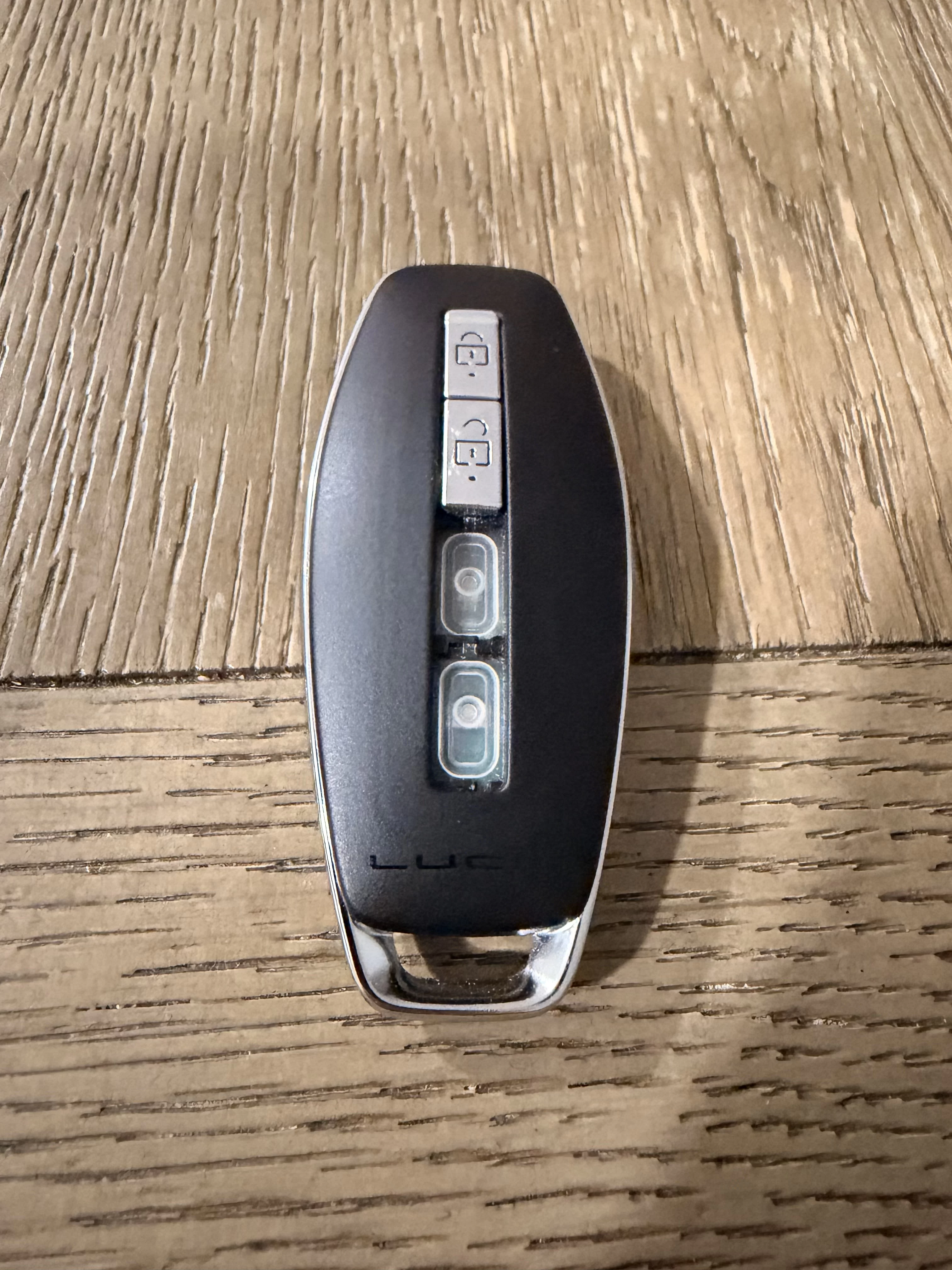

The buttons are glued onto the silicone and are prone to falling off once one is already off.
@Ron_Burgundy and I are not the first either.
LOL! If buttons are falling off everyone’s keys it’s a design, manufacturing problem. I wish Lucid luck in trying to keep providing poorly made keys and then say “you only get one replaced for free” 😂
Agreed. This is yet another known problem, with well known solutions. Many widgets with multiple buttons have a flexible outer layer with the buttons molded in. The advantages are that the keys are full captive and cannot fall out, and it also prevents debris or liquids from getting in.

Only the first replacement. Per my service center, any future replacement after the first free one will not be covered under warranty.

key fob button preventive workaround:
Oh do you not have the first fob update they did, not the one they just did for this OTA? That would probably explain it.
Would be useful if they gave us the version number of the FOBs… to help get this all understood better.
