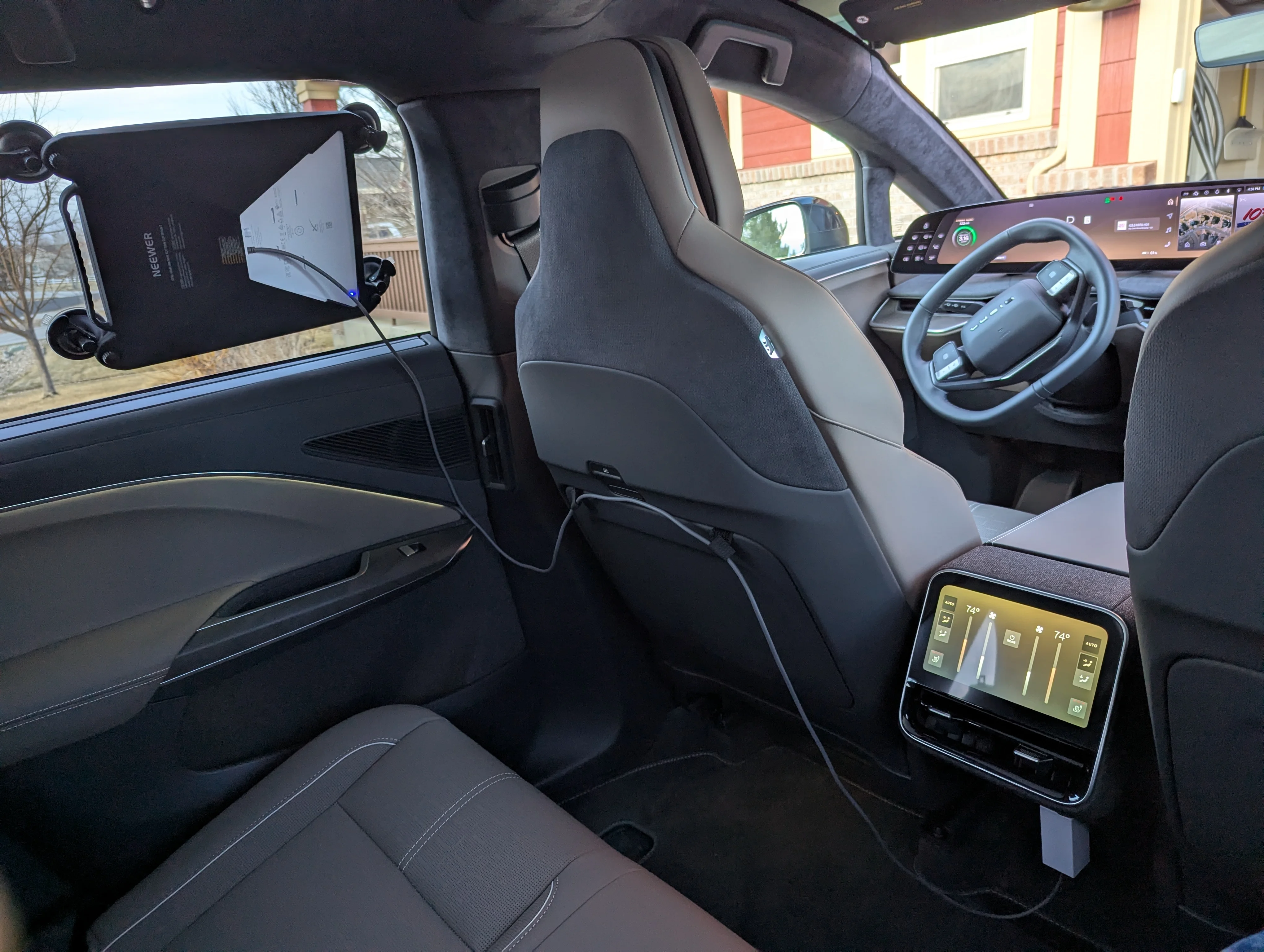

So what did you eventually figure out that worked? I used to place my Starlink V3 dish (the one with the kickstand) perfectly against the rear windshield dash of the Lucid Air and drive around with perfect connectivity and speeds. Now with the same dish, on the Gravity, tried sittting on the front dash againstt the front windshield and literally comes back with either no internet connection or extremely slow speeds at 20-30Mbps. Thanks in advanceMount ordered. Works through the second row side windows.since it would be a temporary solution for us when we travel anyway, that’s fine!
Like I said, side windows.So what did you eventually figure out that worked? I used to place my Starlink V3 dish (the one with the kickstand) perfectly against the rear windshield dash of the Lucid Air and drive around with perfect connectivity and speeds. Now with the same dish, on the Gravity, tried sittting on the front dash againstt the front windshield and literally comes back with either no internet connection or extremely slow speeds at 20-30Mbps. Thanks in advance
Only glass that doesn't have the metallic coating appears to be the side windows. I got a suction cup mount off Amazon and mount my Mini in a 2nd row window.So what did you eventually figure out that worked? I used to place my Starlink V3 dish (the one with the kickstand) perfectly against the rear windshield dash of the Lucid Air and drive around with perfect connectivity and speeds. Now with the same dish, on the Gravity, tried sittting on the front dash againstt the front windshield and literally comes back with either no internet connection or extremely slow speeds at 20-30Mbps. Thanks in advance
