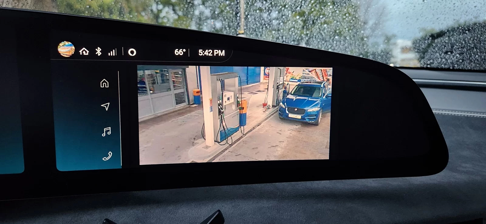

With some help from some forum friends, we are able to reliably get Android Auto in the car with a little workaround. Credit to @Bocabob for testing and @LucidDropkick for the guide and flowchart.
To achieve Android Auto in the Lucid you will need to purchase the following:
CarLinkit AI Box
Other AI boxes may work, this tutorial is specifically this product. The box runs through WIRED CarPlay.
Plug the unit into the car, either USB port should work, but this is being written running it through the USB-C. First boot will take a long time (several minutes).
It'll be recognized as a CarPlay device by Lucid. It should auto-open, if not, open from Lucid Home screen. You can enable CarPlay in 2 different places as shown below:
Next you should see the loading screen for the box is shown as such:
The screen now shows you some interface options. You don't have to touch anything. It will automatically size the screen to fit the Lucid screen.
