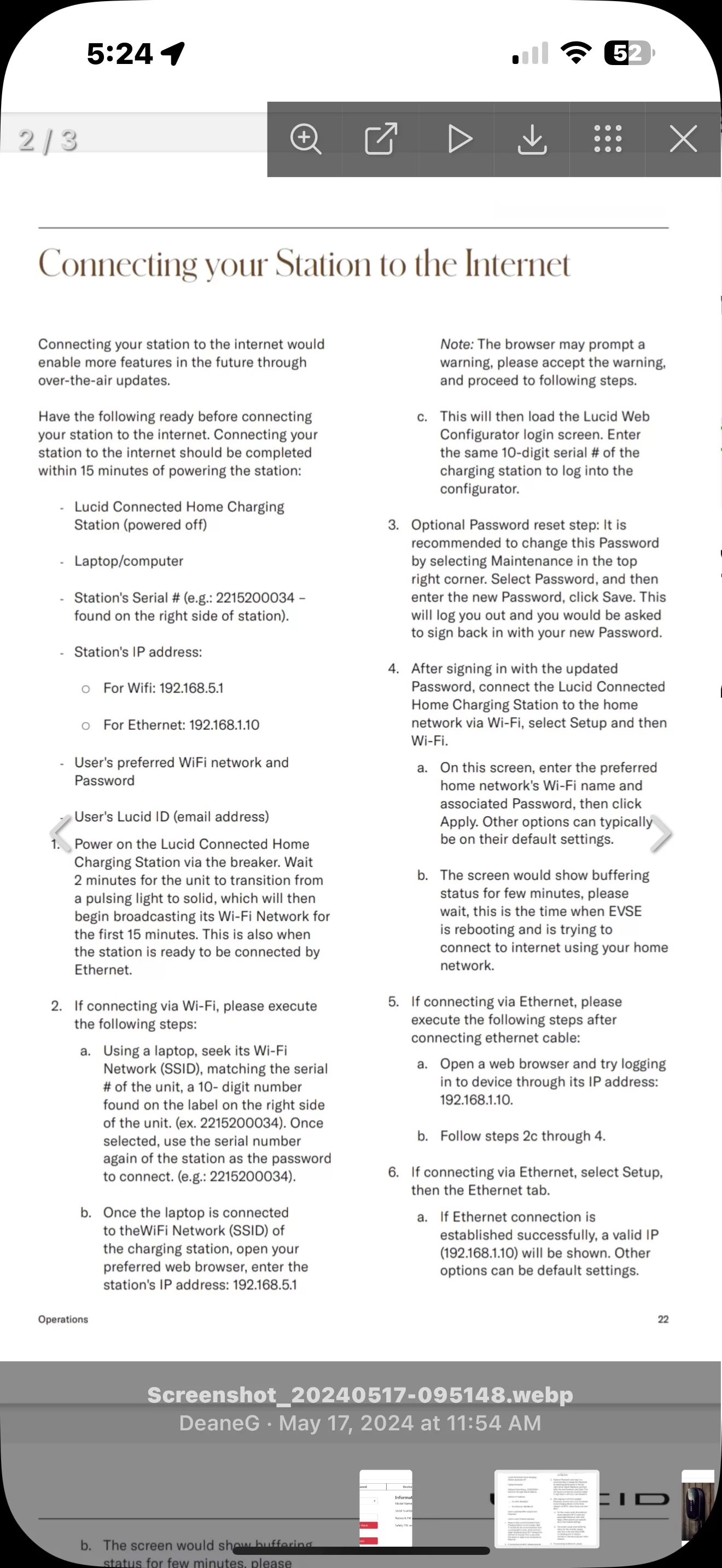

Like many others, I had trouble getting my WiFi working on my Lucid home charger (LHCS). I spent quite a few hours working on it. I have the latest firmware. I now have it working, although there's still a problem. I have to have a Ethernet connection for the WiFi connection to work. I've verified this in that I can connect to the WiFi, then pull the ethernet cable and the WiFi quits working. Then if I plug the cable back in, the WiFi starts working again.
I also set a static connection for the Ethernet. The DHCP option does not seem to work. In either option, the address is set to 192.168.1.10. My DHCP does not assign addresses lower than 192.168.1.60, so I know this is not working.
I have almost 50 devices on my WiFi. None of them have been as painful to configure as the LHCS!
Network FW version: 01.01.25
Safety FW version: 02.14.54

Why bother if you have ethernet there?
This. Ethernet on the LCHCS is 100mbit, which is far more than necessary for it. Ethernet is also more stable, as it is hardwired.
That said, the wifi definitely works without Ethernet; I’m not even sure how that would work from a technical perspective. I suspect you’re doing something wrong in the setup (which, to be clear, is not your fault; it’s a UX issue, as the setup shouldn’t be as hard as it is).
I’m happy to help sometime (we can do a call or something, after the holidays), but honestly, I’d just leave it plugged into Ethernet.
