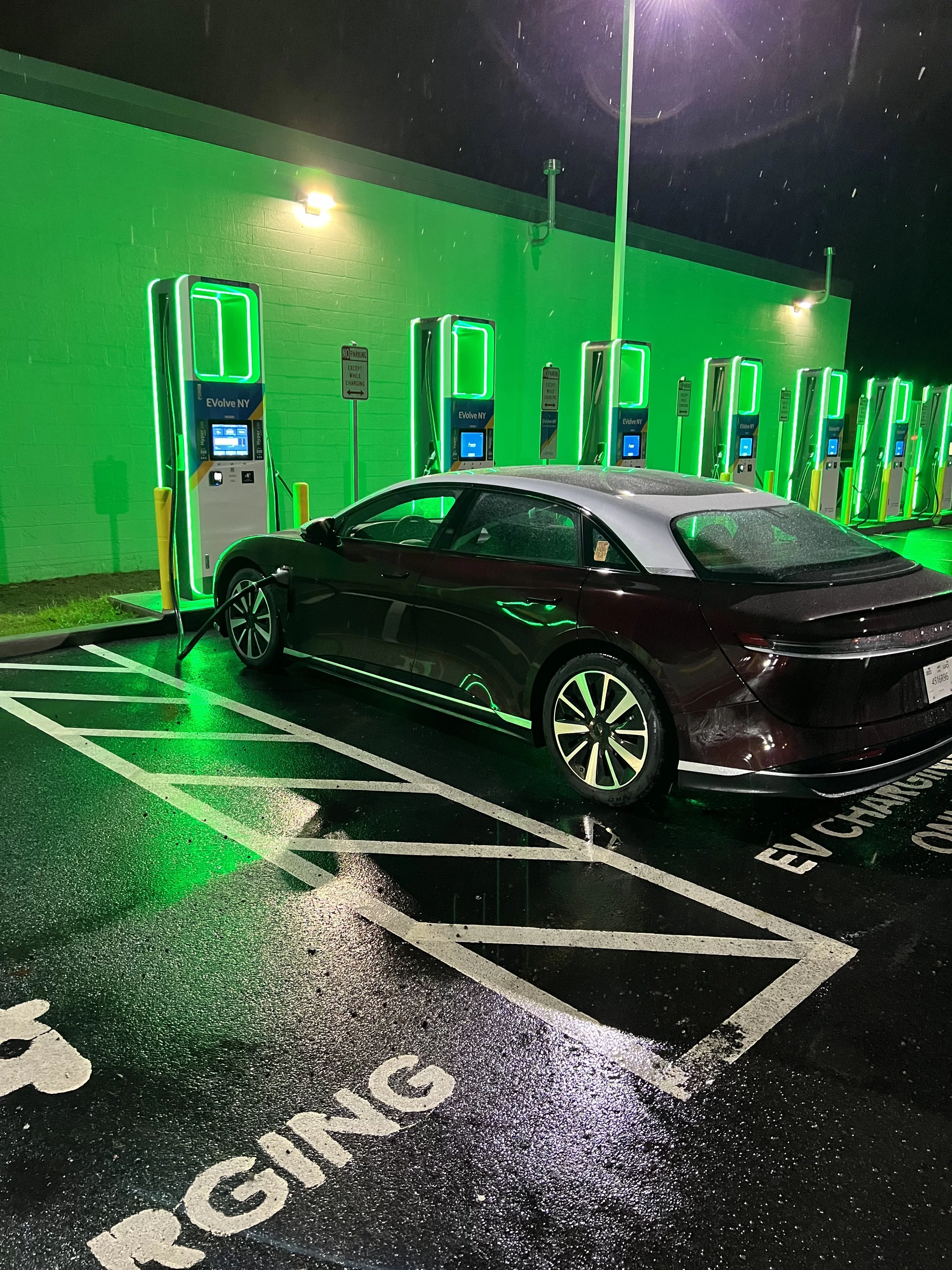

I was curious about that. So are you saying the EvolveNY branded EA stations don’t honor the Lucid free charging agreement?

So I can confirm that the EVolveNY branded EA stations DO honor the Lucid free charging agreement. I tried the EVolveNY station in Hancock, NY last night and it worked flawlessly.
So I can confirm that the EVolveNY branded EA stations DO honor the Lucid free charging agreement. I tried the EVolveNY station in Hancock, NY last night and it worked flawlessly. View attachment 8916
