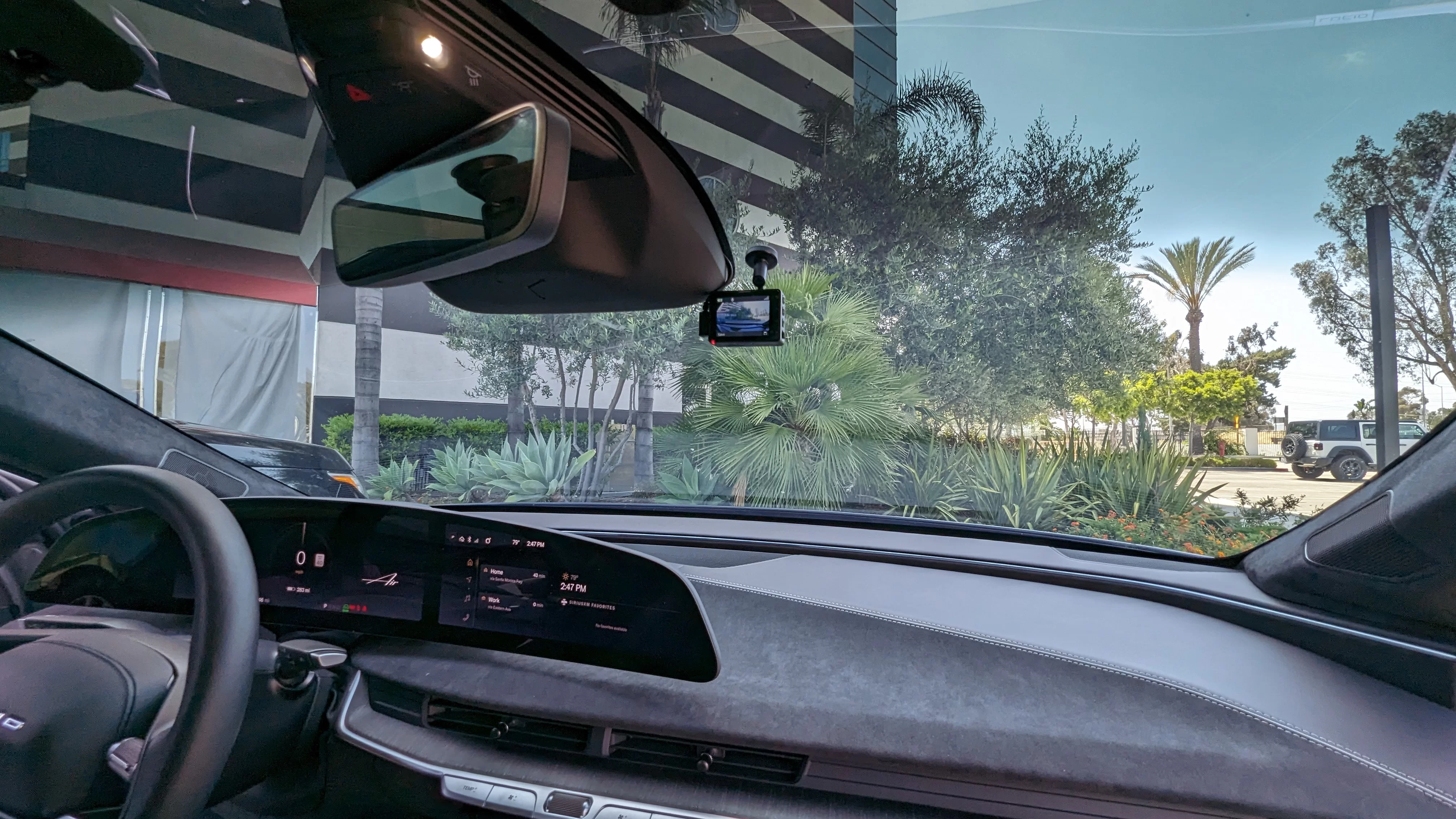

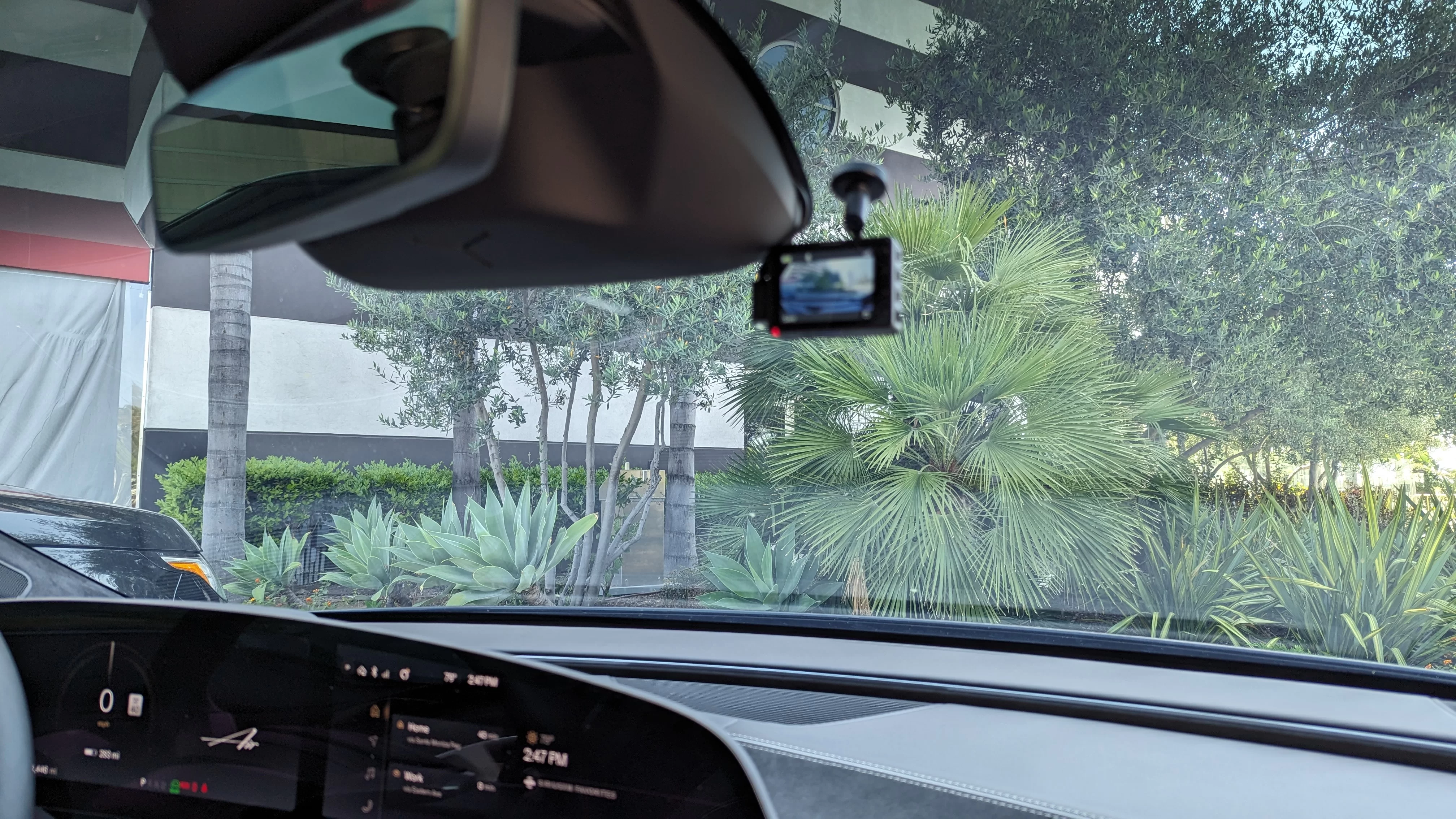

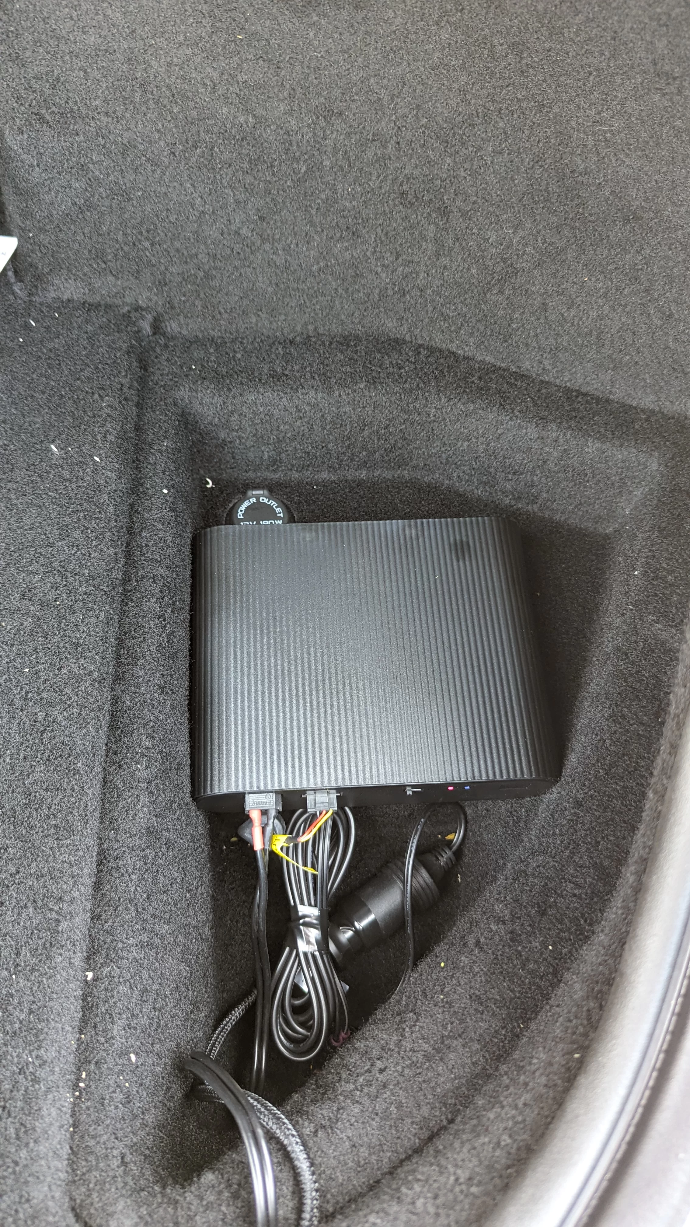

I had a professional installer mount a Garmin 57 and a Thinkware battery extender today for when it's parked. Installer spliced the wire underneath the plug so I can still use the 12 volt power for something else. Nice and neat. Barely any wire showing near the camera.
Installer is in Los Angeles.
Here are the pics. I'll report back if I have any issues. View attachment 13098View attachment 13099View attachment 13100
Would you have the picture of the splice beneath the storage area?
Have you taken the pic of popping off the cover to the fuse box and identifying where to connect for dash cam?

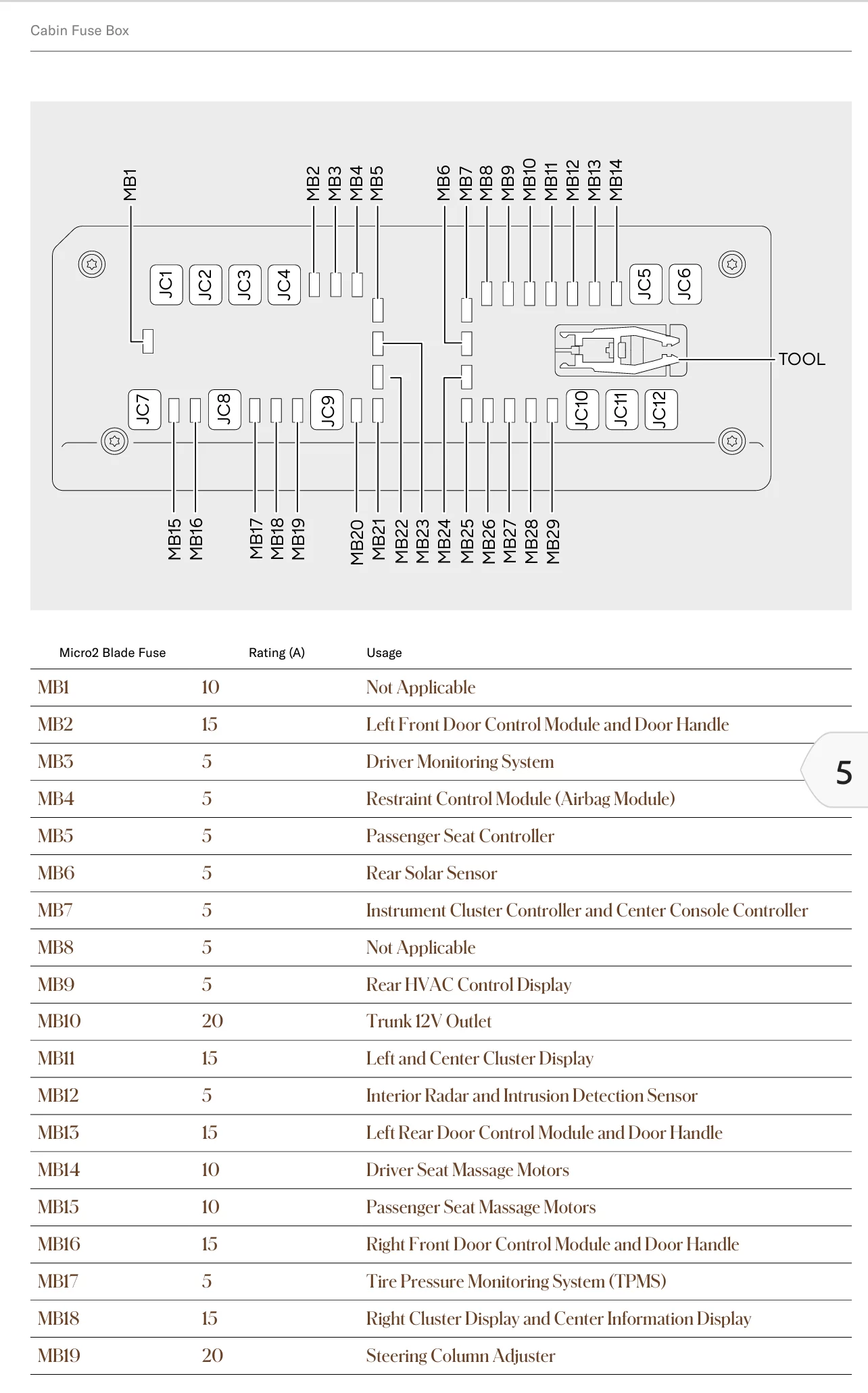

I used MB1 and MB8 as they are unused fuses.
They are not unused. “Not Applicable” means Lucid doesn’t want to tell you what they’re for, not that they’re unused, afaik.
Well they work just fine non the less.

Also the fuse layout you posted is only for one of the 3 LVJB’s in the car.
Here are the fusebox layouts: https://lucidowners.com/attachments/lucid-fuse-information-optimized-pdf.11519/
Keep in mind that’s not fully up to date; for example, the rear 12v trunk outlet fuse is now in the rear LVJB, not the cabin LVJB.

Is there a fuse in the front cabin box that is always on and can be used for parking mode?
Wanted to post an update. I setup my vantrue 4 Pro dash cam today hooking it up to m1 and m8 fuses in the front cabin fuse box. It was easier than expected. Thanks everyone for the posts on this forum - it all helped.
Hi Jammet, fuse MB12 is working all the time even when the car is in deep sleep.

No mb1 and mb8 do not have power when the car goes to sleep. I will check out mb12.

Swapped in mb12 and have parking mode working.
