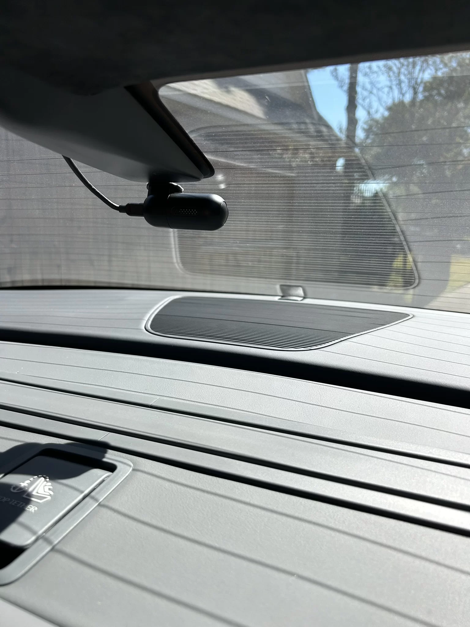

So I installed this setup in two of our cars this weekend (one our Lucid Air GT). What do you set in your dashcam under the Parking Mode menu? There is Auto Event Detection and certain time lengths? And as I think through this-the dashcam will always run and record until the battery is completely drained, right? Then the cycle starts over when car started/you drive? As I think of my normal commutes they are very short so this might not allow the extended dashcam battery to charge back up...? I am not sure if I can set some limits via dashcam menus to change this. Appreciate any guidance you or anyone else can chime in with.
I was charged $280 for installation of 2 dash cams and an extra $30 for the technician to come to my house to do the installation.

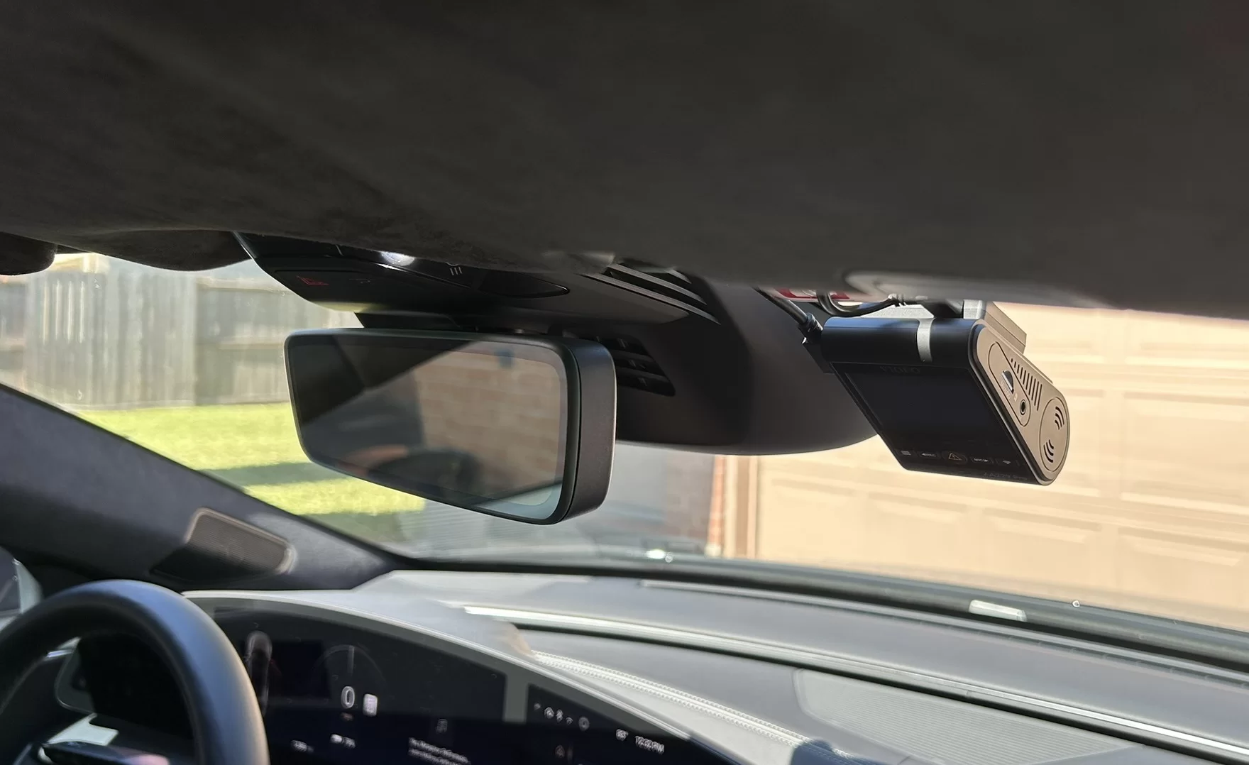

Here are my dash cam locations, though I can't recall if this was the original spot for the rear dash cam. I had to take it off when I got my windows tinted so I just guessed where to place it back; I could probably put it closer to the corner to save space but this hasn't really bothered me.
I installed a Viofo A329 in what appears to be a similar position on windshield as you did, but a large percentage of the view on drivers side of camera recording is obscured by the rearview mirror housing. Is that not the case for you? Maybe yours is lower than it appears in the photo....
The Viofo build-in screen makes it really easy to find the best camera position before peeling off the protection and attaching it to the window. I have no obstruction on the image at all.
Here is our camera on the windshield when taking the pic at roughly 90 degrees. No impairment of the image besides the bad weather ;)
