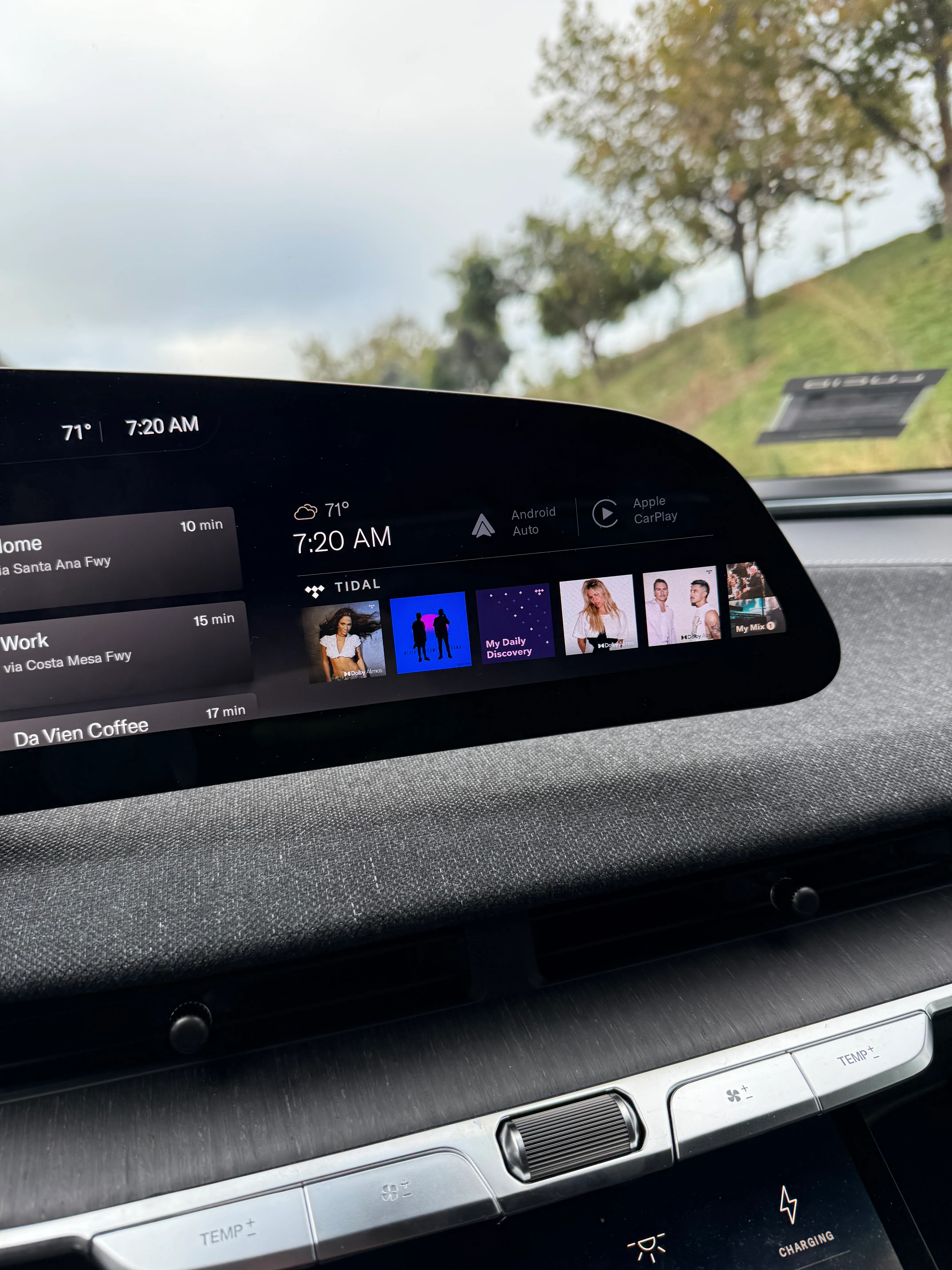

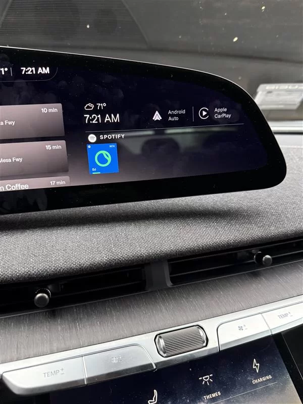

The other spotify weirdness is that the row of spotify tiles on the home screen does not update. It works for Tidal but not Spotify. I've tried to remove the app credentials / logoff Spotify and log back in with no fix. I have a feeling that's an issue for everyone? I just have the DJ icon on the home screen for some reason.
attaching images of spotify vs tidal on the home screen.
Same issue here... the tiles don't update. And I still get the random pauses every other day or so. It's annoying.
