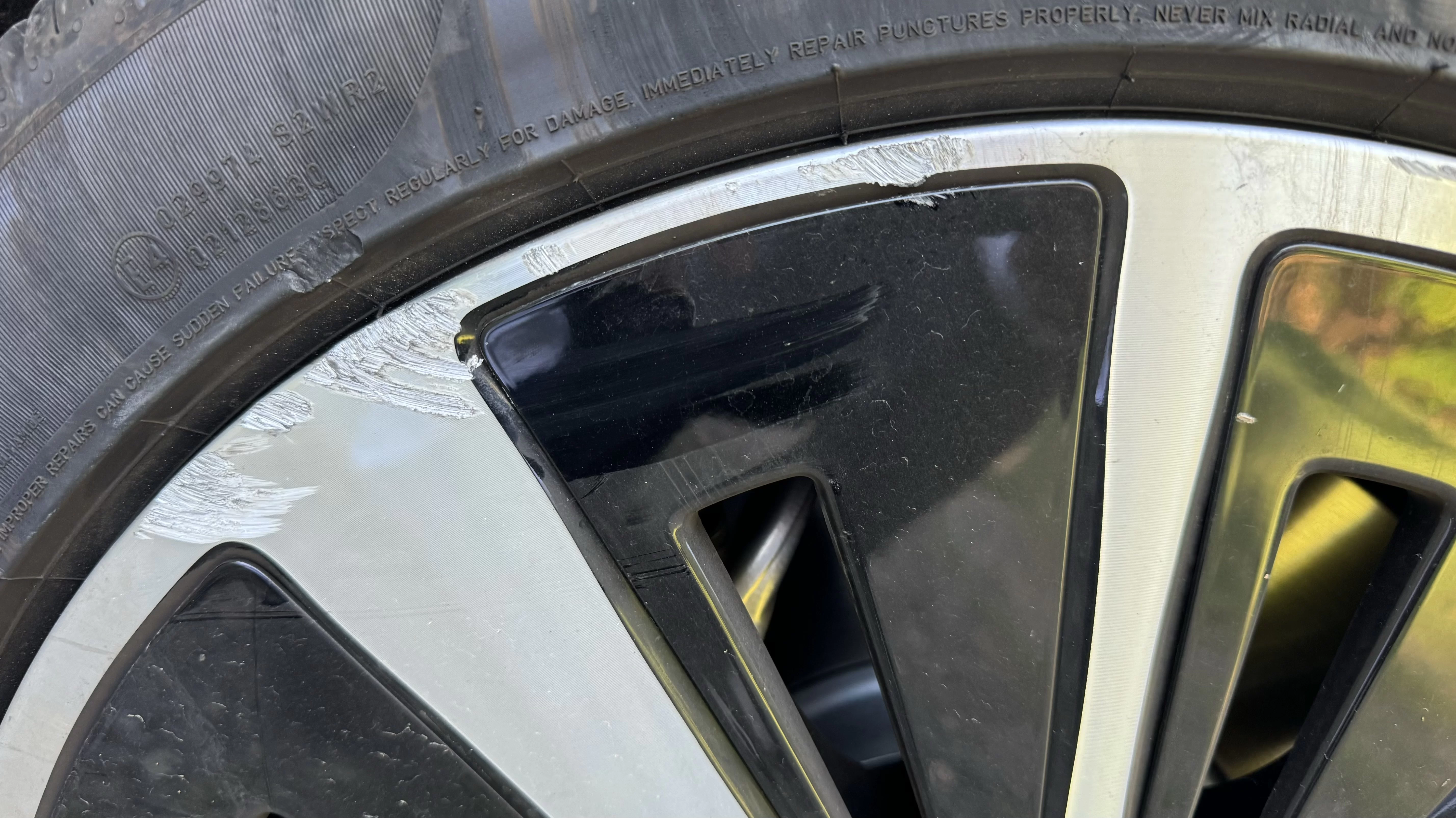

No bueno. This one will hurt on the lease return.
You might be surprised to see how much of the rash you can take care of yourself. I started with a Dremel sanding cylinder, and worked my way up to 1000 grit wet/dry sandpaper followed by rubbing compound and metal polish. I could probably make it perfect with another 30 minutes' effort. Take it slow and careful, but it's doable.
View attachment 22920No bueno. This one will hurt on the lease return.
You can get it refinished before a lease return, and I recommend you do. Just collect them through the lease, and get all of them refinished at once. It will almost certainly be cheaper than whatever the damage will cost for the lease, but you can assess that later.
