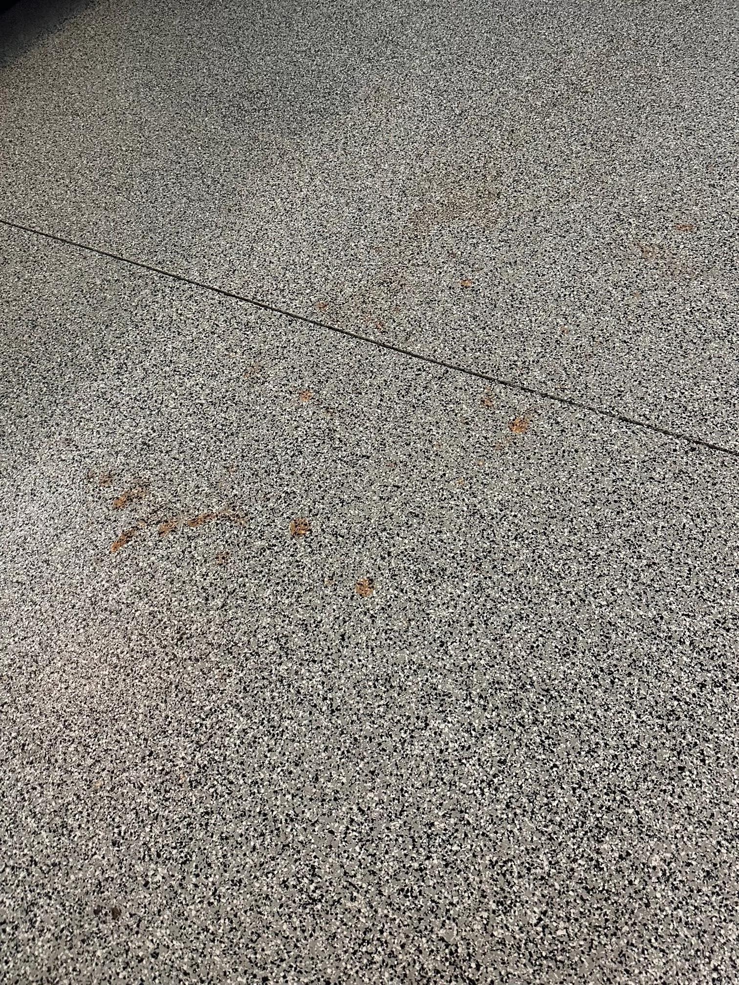

Found these spots on the garage floor where I parked the Lucid:
Looks very, very familiar. And I don't mean I have the same epoxy floor, mine has less fleck. Looks like a coolant leak. I had much, much more volume, but I think most of my fluid was dumped in the garage as my drives at that time were quite short, grocery store runs. I did not get to the point of having to replace the drive unit. I think I caught it early enough. You look to have been dumping more fluid and driving more with low coolant though.
I wish you luck and hope the coolant leak is the limit of these issues, but, like you, I am not sure how that would impact software.
The errand I was running yesterday was an 80-mile round trip of mostly high-speed interstate driving. As I never made it back home, this fluid must have been on the floor before I left. The leak was probably already affecting the car on the trip out, as I noticed first the abnormally high charge percentage drop on the way up, and the yellow triangle warning appeared near the end of that drive. As Lucid Customer Service told me the warning triangle -- which gave no information about the reason for the warning -- probably did not indicate a serious problem and that the car could be driven safely, I made the return trip driving normally (i. e., at 80-85 mph on the interstate) and made it to within four miles of our house.
I'm concerned now about the health of the battery pack, even if it stayed within nominal temperature range up until the "low coolant" warning finally came up. I really don't know what the purpose of a "low coolant" warning is if it doesn't come up until the point at which the car is already being sent into power limiting mode. This car was losing coolant long before any warning displayed indicating that cooling was the issue. A generic yellow triangle is virtually useless. Even though it caused me to call Customer Service, they told me it was safe to drive the car until they could schedule a Mobile Tech in the next couple of days to run a diagnostic.
When you drove the car, what was the temperature? Was there any driving you could call "spirited," in that it would make the battery pack heat up?
