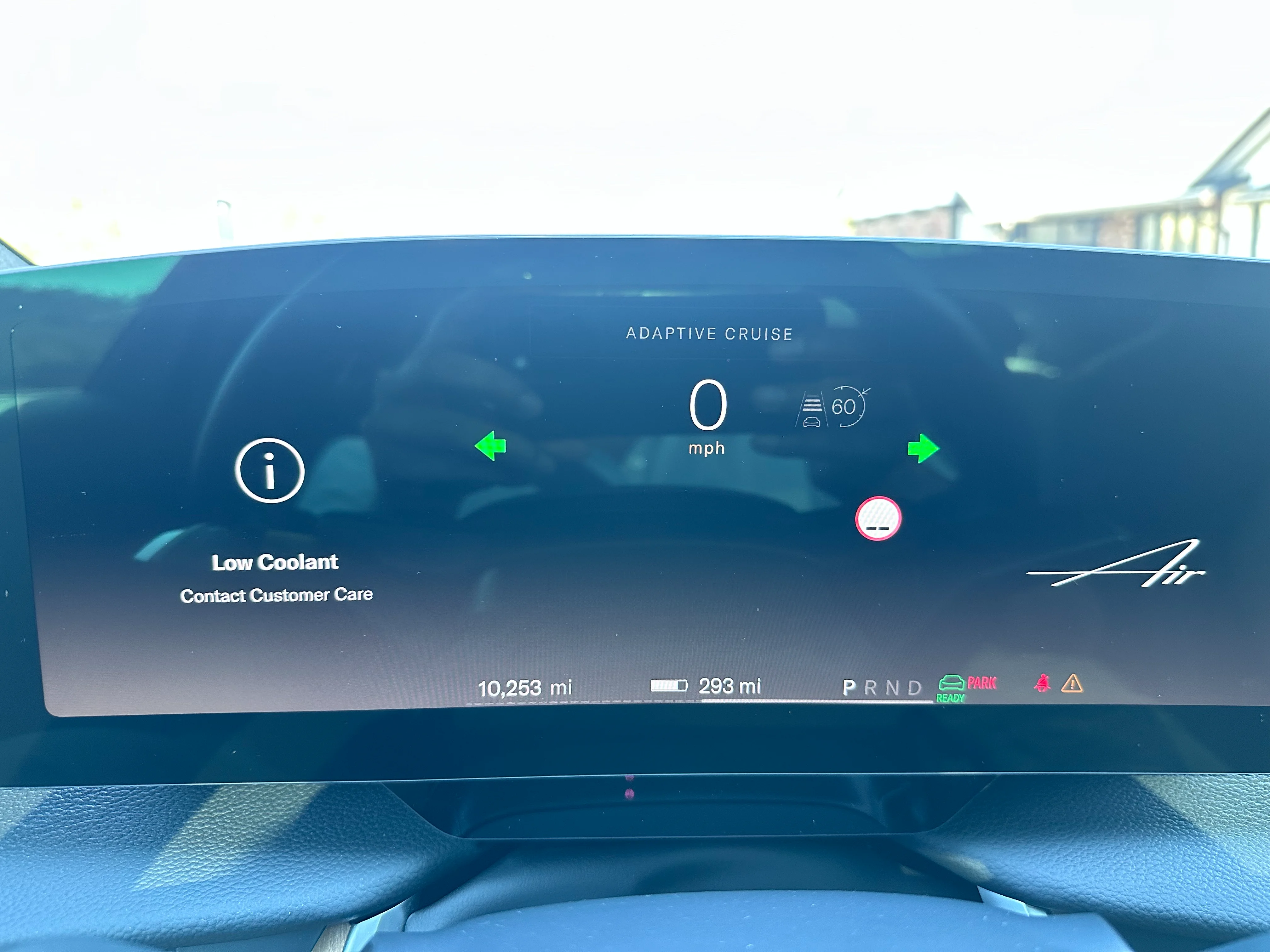

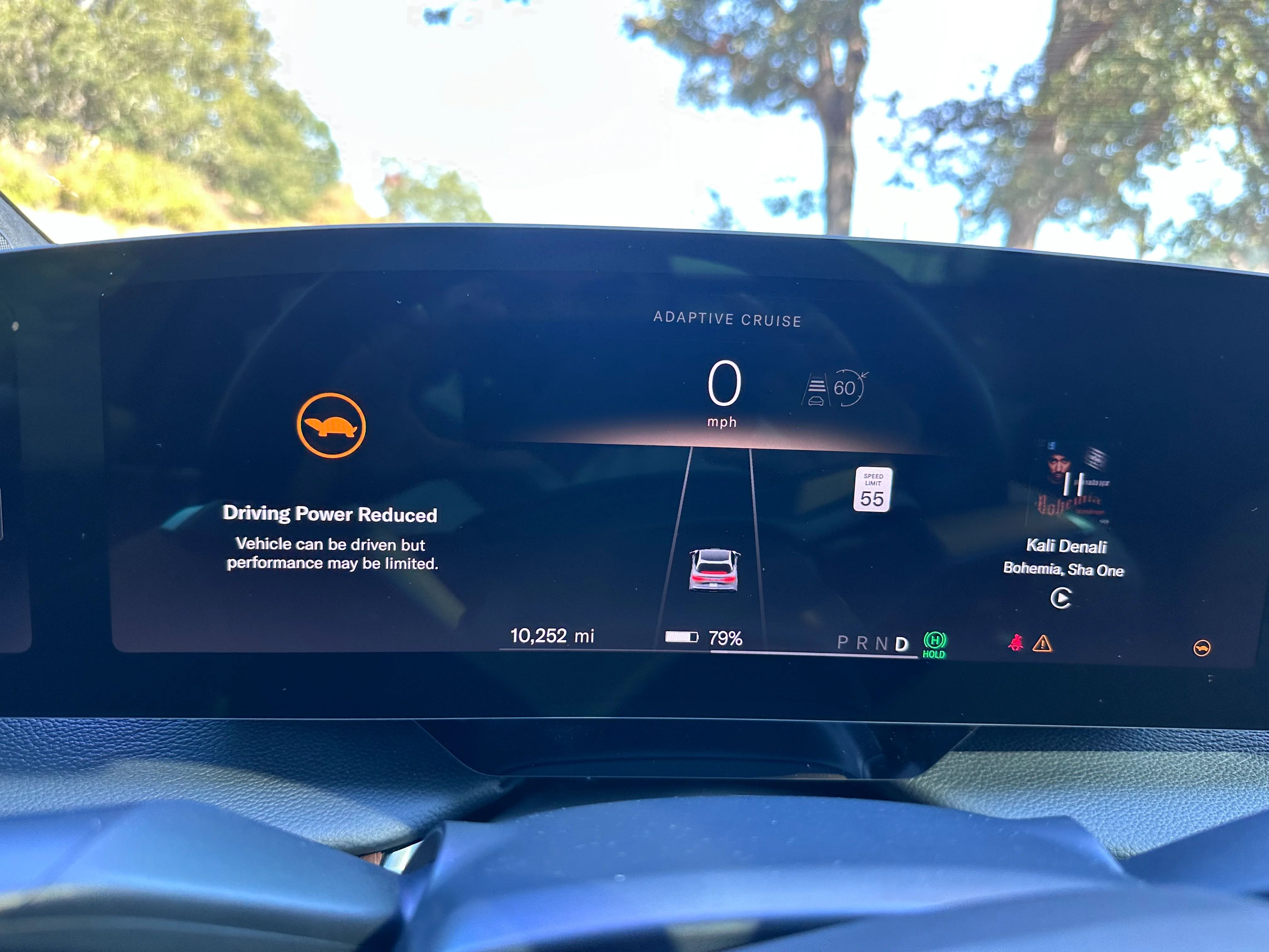

This issue happened with my car last Friday. I had picked up my car from service on 8/18 for minor vibration and seat leather issues.
Went on a roadtrip from Washington to Oregon and on 8/22, 30 mins after a DC charging session at EA, I started noticing loss of power when pressing the accelerator along with bumpy sensations. Started receiving the turtle icon with power limited message on the screen shortly. Few mins later, the car stopped accelerating at all. Had to pull over to the side and call customer service. They made me reboot the system and after that I briefly saw the Low Coolant error message on the screen.
Was lucky to get a rental at an Enterprise nearby (it was almost 6pm and they were closing and initially they were not allowing inter-state drop off). Had to book a hotel nearby to stay the night. Since it was Friday, Lucid told me they will setup a tow on Monday. I was headed to Crater Lake in Oregon and was lucky that the car failed near a small town named Roseburg and not near Crater Lake otherwise I would have likely got stuck in the middle of nowhere with very less cellular reception.
My concerns:
1. Since my car had been in service and released on 8/18, why did they not check this issue for my car? I saw regular complimentary health checks listed on the service invoice.
2. Worried about battery/drive unit damage because of this coolant failure.
3. Although Lucid will arrange and pay for the towing. I am hoping, they will also cover the rental and emergent hotel stay.
