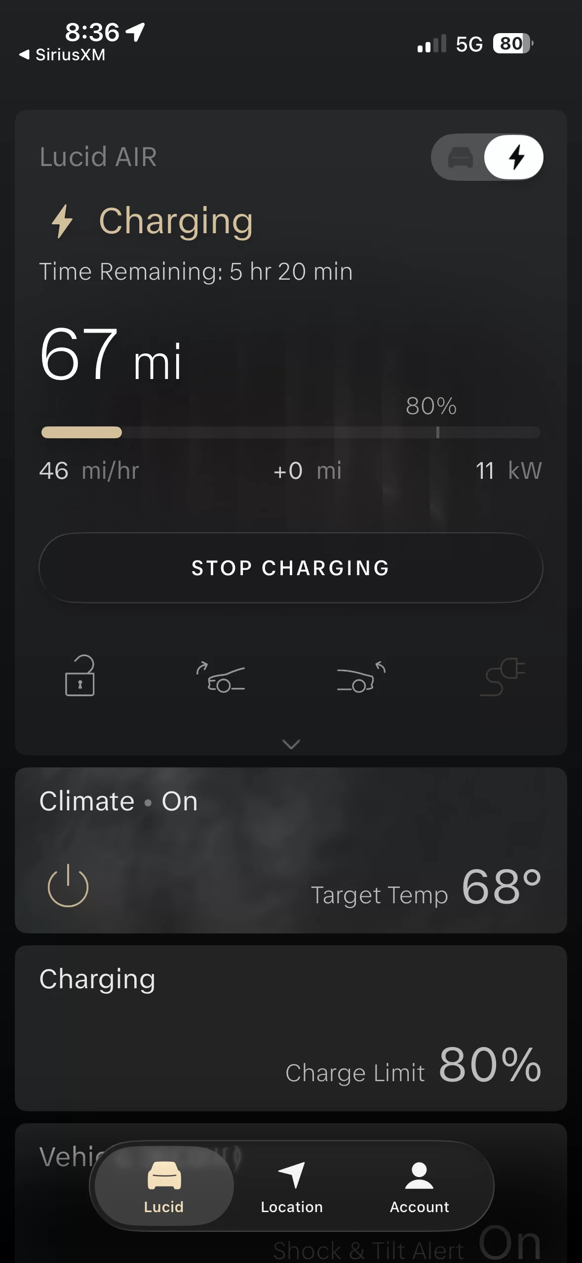

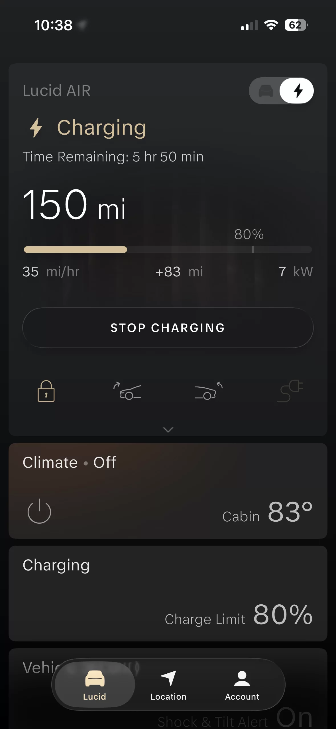

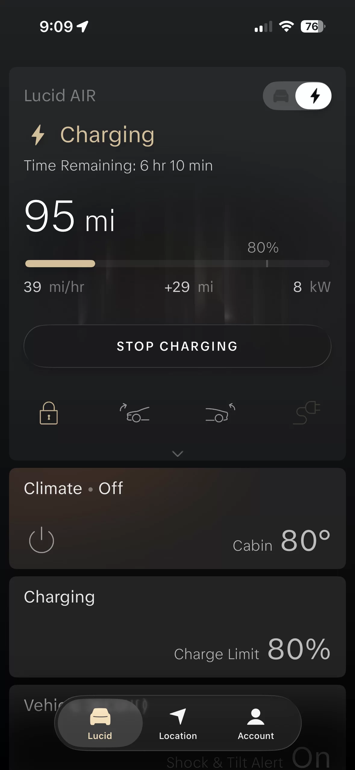

Update and it’s not good. I received the new Lucid branded home adaptor today and fired it up at 8:36 pm in my completely normal winter garage temperature in Miami. Low humidity as well. I was cautiously optimistic as I noticed that when I plugged in the new adaptor it took a second to “handshake” with the Tesla gen 3 wall connector. Maybe things would be different. With the Lectron it started charging instantly. So now I’m about 45 mins in and the 11(.5) kw reading is, as usual, down to 8 kw. I know from experience unfortunately that it will never regain the full 11.5, as has happened since the May software update under unchained circumstances before and after May.
@marqie I am tagging you here so you’re aware of this latest troubleshooting. I know you can’t comment on specific charging issues but maybe you can point the appropriate individuals at Lucid to take a look in light of the Lucid adaptor having no effect here in solving this issue.
I am more convinced than ever this is a software issue.
Anyone else try this with the new adaptor?

If you haven’t done it I strongly recommend reaching out to customer care. As far as I can tell it’s the temperature of the wiring and the connector. Hopefully lucid has performance data from other brand chargers.
I know one person that has the LCHCs on a 48a breaker and he sees throttling. I’ve given him the same recommendation if he ever follows through on that I’ll post the update here.
It’s not the wiring. I’ve been using this charger for 5 plus years on a Tesla without any issue. I was using it on my Air since March without issue until the May update referenced in post 1 of this thread. No change to my setup pre and post may update.
