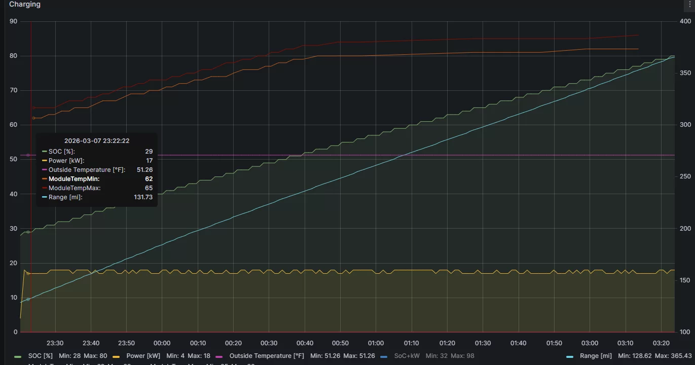

Charging rate is relatively constant on the bottom, 17-18kW over a 4hr charge. This was after replacing the LHCS with a new revision.
