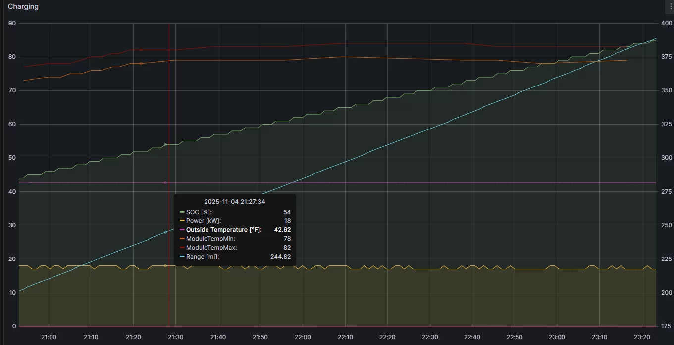

In case this is useful for anyone from Lucid, here is data from today's charging session courtesy of TeslaLogger. Power [kW] is in yellow at the bottom, you can see the 18-19 rate dropping to 8, then back up, then dropping to 1 (when I tried the mobile charger briefly per Customer Care's suggestion, then back up to full speed for around 45 minutes before throttling back again. This is with a LHCS hardwired with 80A setting on 100A breaker.
And here's another one 2 days prior:
And the day bfore that:
Yup. Exactly what I see if I try to charge at full amperage. If I drop it to 42 amps, it will pull 9.6kW just fine constantly

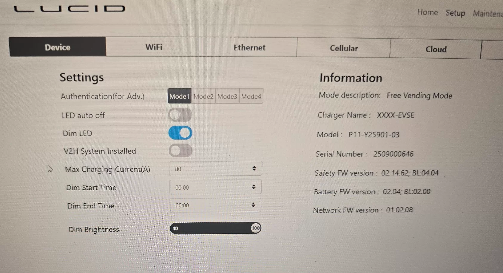

Electrician was able to swap out the old LCHCS for the new replacement, which does have a new part number (rev 3 vs rev 2). First charge at 80A has been going for 2hrs without issue, will post update tomorrow.
Promising. But I wonder what this means for those of us using non-Lucid chargers. Looking forward to your update.
2hrs 20mins (I let it run to 85% so it would take a little bit longer) without any drop in rate. I simply haven't been able to do that in the past, so the initial solution appears to be working.

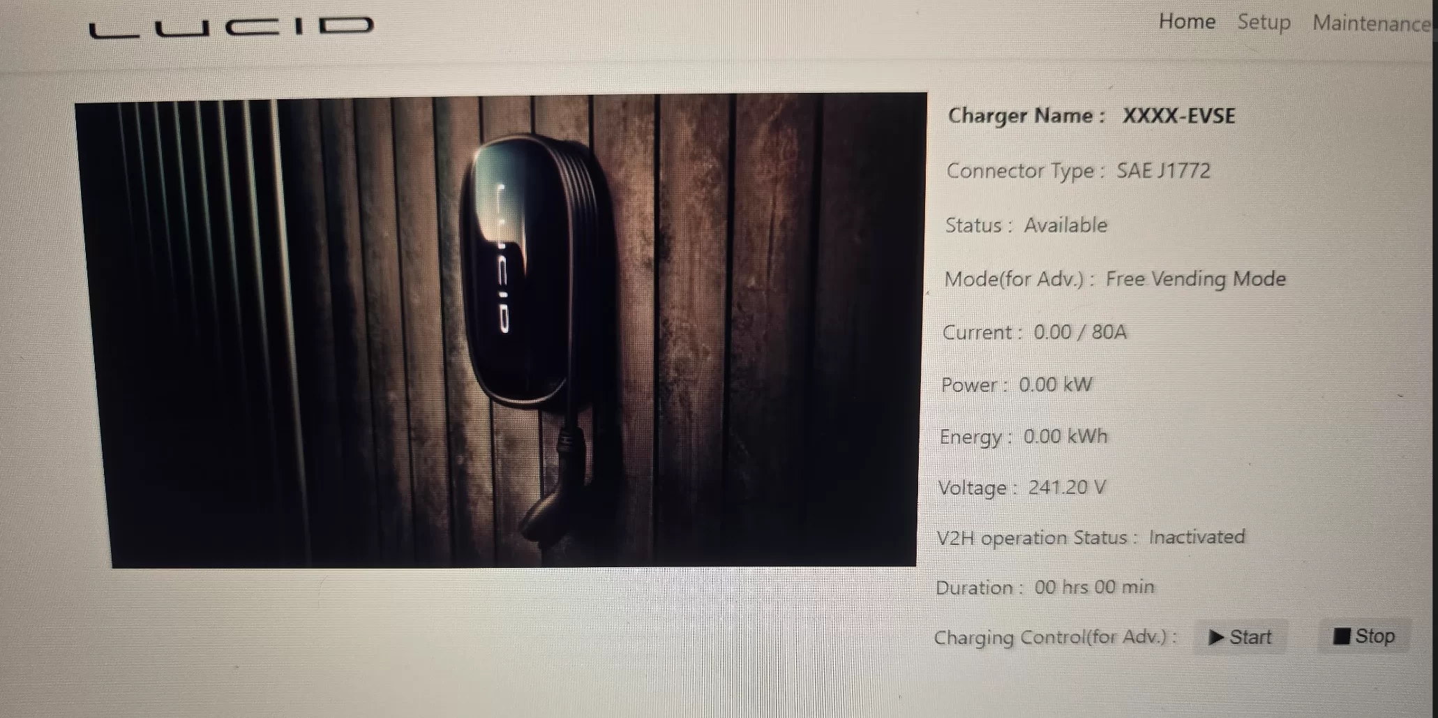

The UI for the charger is quite different as well, I'm seeing V2H options and quite a few additional fields that weren't there in the rev 2 interface. It also initiates the charge quite a bit faster (at least, when it wasn't connected to Wifi, I haven't tried it again since then).
...The UI for the charger is quite different as well, I'm seeing V2H options and quite a few additional fields that weren't there in the rev 2 interface. It also initiates the charge quite a bit faster (at least, when it wasn't connected to Wifi, I haven't tried it again since then).
Your LCHCS has newer firmware version numbers than my three year old unit. Something has been improved.
