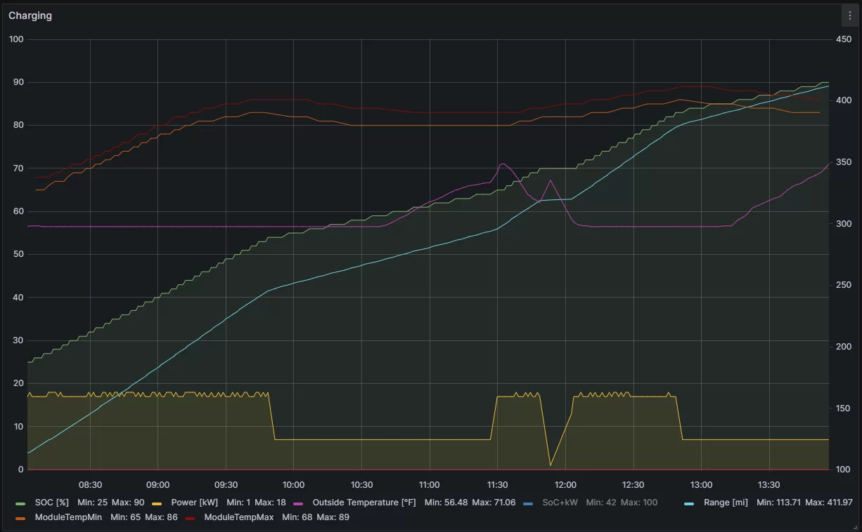

In case this is useful for anyone from Lucid, here is data from today's charging session courtesy of TeslaLogger. Power [kW] is in yellow at the bottom, you can see the 18-19 rate dropping to 8, then back up, then dropping to 1 (when I tried the mobile charger briefly per Customer Care's suggestion, then back up to full speed for around 45 minutes before throttling back again. This is with a LHCS hardwired with 80A setting on 100A breaker.

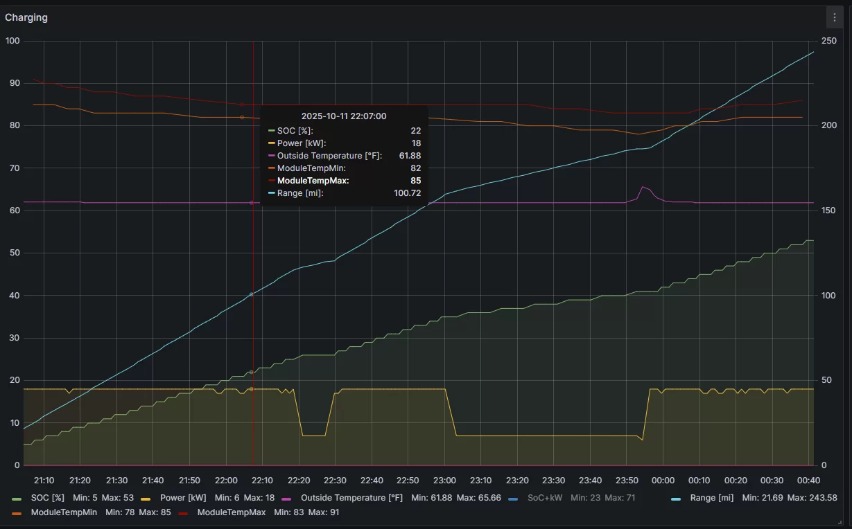

And here's another one 2 days prior:

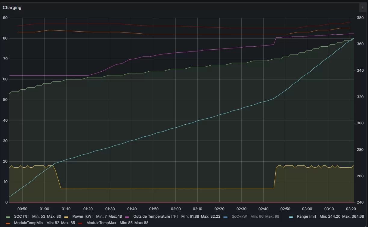

And the day bfore that:
This is in your Air, right?
I just started a charge and the usual. 11kw then 20 mins in now down to 6-7. Wipp remain that way until the end. Tesla Gen 3 wall connector with lectron adaptor.
yes, in the Air, '22 GT
Yup, this is exactly what mine does. If you unplug it once it has dropped, then plug it in again, it starts back up at full speed before dropping again after a bit.
