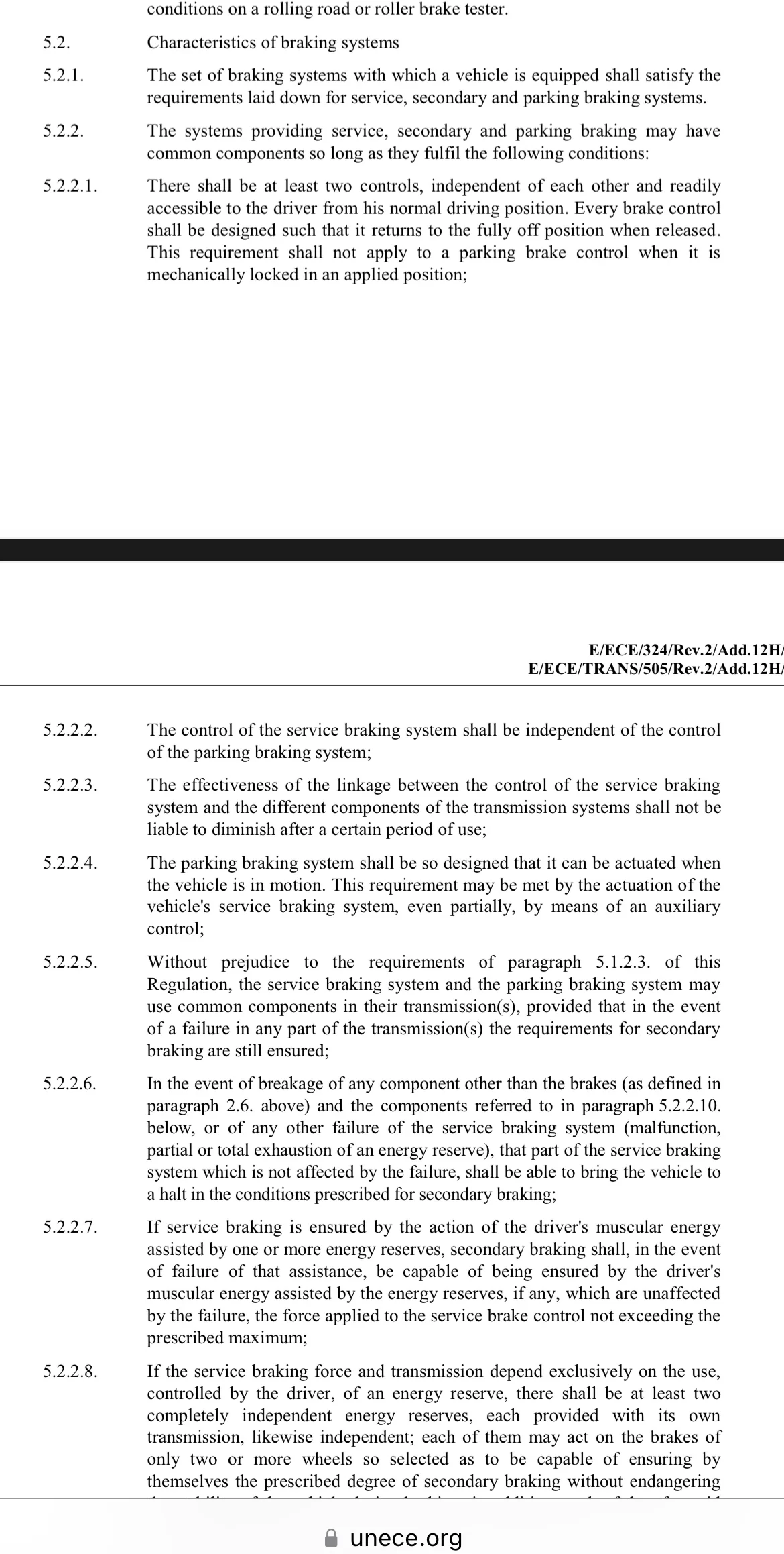

Hi TakeDuo,
That is intentional and by design, it’s mandatory in order to meet European regulation ECE13-H “Uniform provisions concerning the approval of passenger cars with regard to braking”, sections 5.2.2.1 & 5.2.2.4. OEMs will usually design so that a vehicle meets most global regulations, hence North American cars having this feature.
The feature is there for two reasons - to allow a driver to bring the vehicle to a stop in case they aren’t able to apply the brakes via the pedal, and to allow a passenger to bring the vehicle to a stop if the driver is incapacitated.
What a driver will experience when this feature is activated is a noise and vibration while the brake modulation unit (aka ABS module) builds hydraulic brake pressure at the four brake calipers, slowing the vehicle at a defined rate, then the car applying the parking brake when at almost-zero speed. The user can release the park button at any point to exit the function - i.e. an accidental short press followed by a release won’t stop the car.
Most modern cars do the same thing, this isn’t unique to Lucid.

Well, thanks for the info! It was still alarming and not something I expected albeit my dumb mistake. Neither did my passengers obviously. As @joec pointed out, Teslas will basically ask if you are sure you want to do this though maybe as first warning. And, my modern-ish Honda will not allow me to put the car into “park” while driving and the e-brake is by my left foot. Where is the redundancy there? Push button engine kill I suppose?
I am certain that my first thought would not have been to push the park button in an emergency though. Maybe my subconscious will activate this reaction now that this has been discussed. Again, thanks for the research and info. Love this forum!

If that's the case, how do they satisfy that European rule about a redundancy for stopping the car?
I would be shocked if the US does not have an equivalent requirement for an e-brake. Whether anyone thinks to use a stalk mounted e brake in an actual emergency is another question but then again these have gone from hand levers, to foot levers, to buttons so it’s not like there is a standard anymore.
