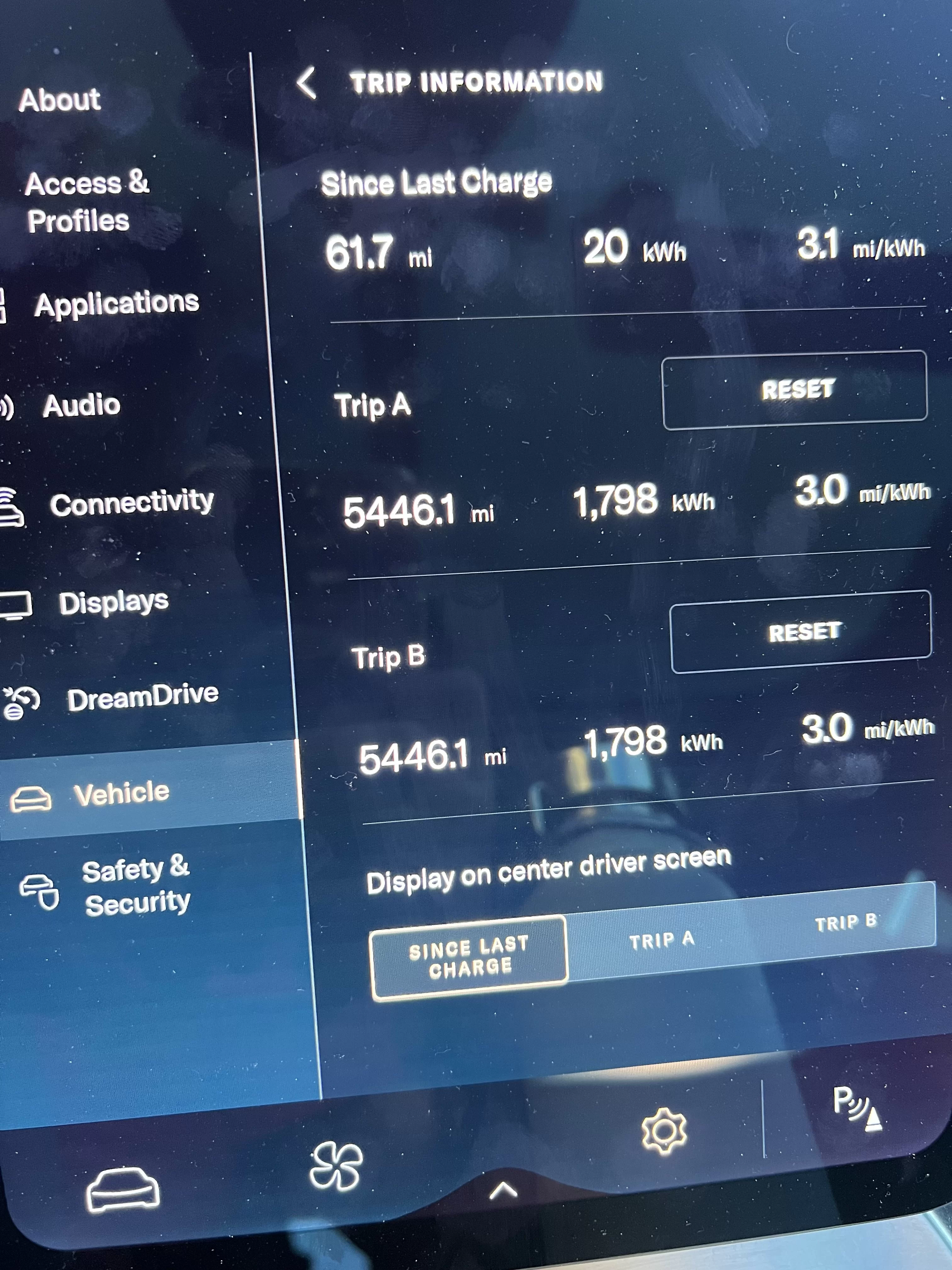

The ac for first 5 minutes seems to force most air up the winshield. Then after that it’s like it goes back to normal mode and more air in face. I didn’t make a note of the rear. With all the tint we have been comfortable at keeping it auto and 70 and not messing with any vents. My garage is garaged most the day covered parking. Commute 30 miles each way and today avgex 3.1miles per kWh mostly freeway
I was trying to pay more attention my ac is set 70 degrees auto and our outside az temps are ranging between 80 in morning to 97 afternoon.
The ac for first 5 minutes seems to force most air up the winshield. Then after that it’s like it goes back to normal mode and more air in face. I didn’t make a note of the rear. With all the tint we have been comfortable at keeping it auto and 70 and not messing with any vents. My garage is garaged most the day covered parking. Commute 30 miles each way and today avgex 3.1miles per kWh mostly freeway View attachment 12957
