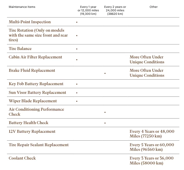

Lucid recommends 12,000 miles for the 19 inch wheels only. The general recommendation isHow often is tire rotation needed? Mine had 5k miles and I asked for one when it went in for some other service, and they did it.
But if it was only required at 12k, maybe they should have asked me to wait. It was $60.
Lucid does not recommend moving the
wheels between the front and rear axles, or
from side to side on the same axle pair.
