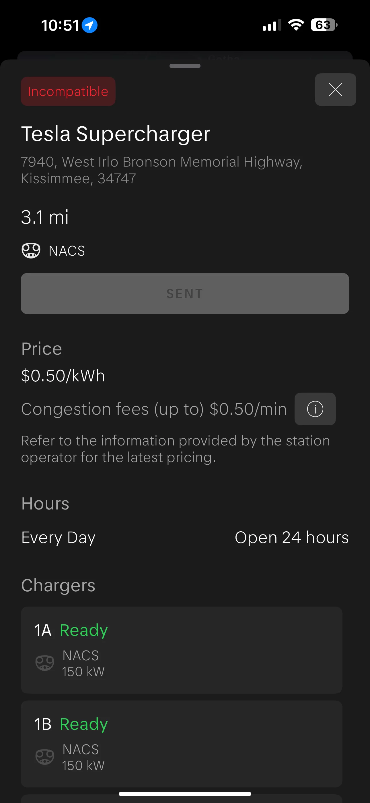

It has been widely stated here that the nacs to ccs adapters are not smart adapters. I ordered the approved Lucid adapter (which appears to be identical to the lectron adapter sans the lucid branding) but it hasn’t arrived yet. So, i decided to try my spare Levtron nacs to ccs charger again. Of course, it did not work last week or so when I tried it the first time at a Tesla Supercharger. Tonight, I tried it again after updating my app and confirming it listed Tesla SC in the app. After a few seconds of connecting to the car the lights tirned red and stated that i needed to disconnect and then reconnect the cable. It would not work at all. I have long had a credit card on file with Lucid in the app. I suppose that my Lectron adapter could be bad?
Thanks. My Lucid adapter should arrive early next week. No, the Lucid iPhone app did not indicate compatibility or noncompatibility with the location as it didn't appear on the app at all. It was a generic Tesla Supercharger station. Maybe I was supposed to do something with the app? It's been a long time since I used EA (we charge at home) but I do not recall doing anything other than plugging the cable in when charging there. Tesla Supercharging may require an additional step(s) on the app.Did Lucid's app list that particular supercharger location as compatible? I'd wait for Lucid's adapter to arrive, then try it out. By then, more details should be available on exactly how to initiate a charge manually - or plug'n'charge might be working, which would be easier.
Tesla Supercharging does require interaction with Lucid's app.Thanks. My Lucid adapter should arrive early next week. No, the Lucid iPhone app did not indicate compatibility or noncompatibility with the location as it didn't appear on the app at all. It was a generic Tesla Supercharger station. Maybe I was supposed to do something with the app? It's been a long time since I used EA (we charge at home) but I do not recall doing anything other than plugging the cable in when charging there. Tesla Supercharging may require an additional step(s) on the app.
You nailed it! That SC location is not compatible with the Air as shown on the map in the app (screenshot attached). There is another Tesla SC close by that is compatible so I will be testing that this afternoon. Thanks!Tesla Supercharging does require interaction with Lucid's app.
More importantly, not all Supercharger stations are compatible with non-Tesla vehicles. If a Supercharger location doesn't show up in Lucid's phone app, that location isn't compatible with the Air or Gravity.
