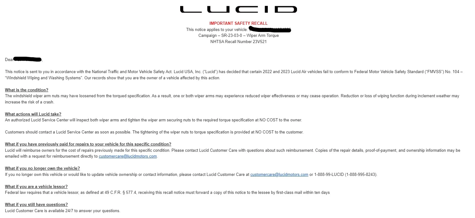

It seems that there is a service campaign for wiper related issues including setting the torque of the wiper blades. I had my car in for the tow hook recall and found this service item in my paper work.
Corrections: PDC-22-10 Wiper Harness - Verified vehicle needed PDC-22-10 per main harness to wiper
clearance. Performed PDC fallowing procedures. Removed frunk apron covers and tub
hardware. Verified little to no clearance. Repositioned the Fir Tree Cable Strap. Measured the
distance between the wire harness and the wiper arm linkage. Verified that distance was
PDC-TSC-Stories greater than 15mm. Reassembled vehicle back. Torqued wiper blades to 27NM. Verified proper operation of wiper blades. Vehicle is working as designed.

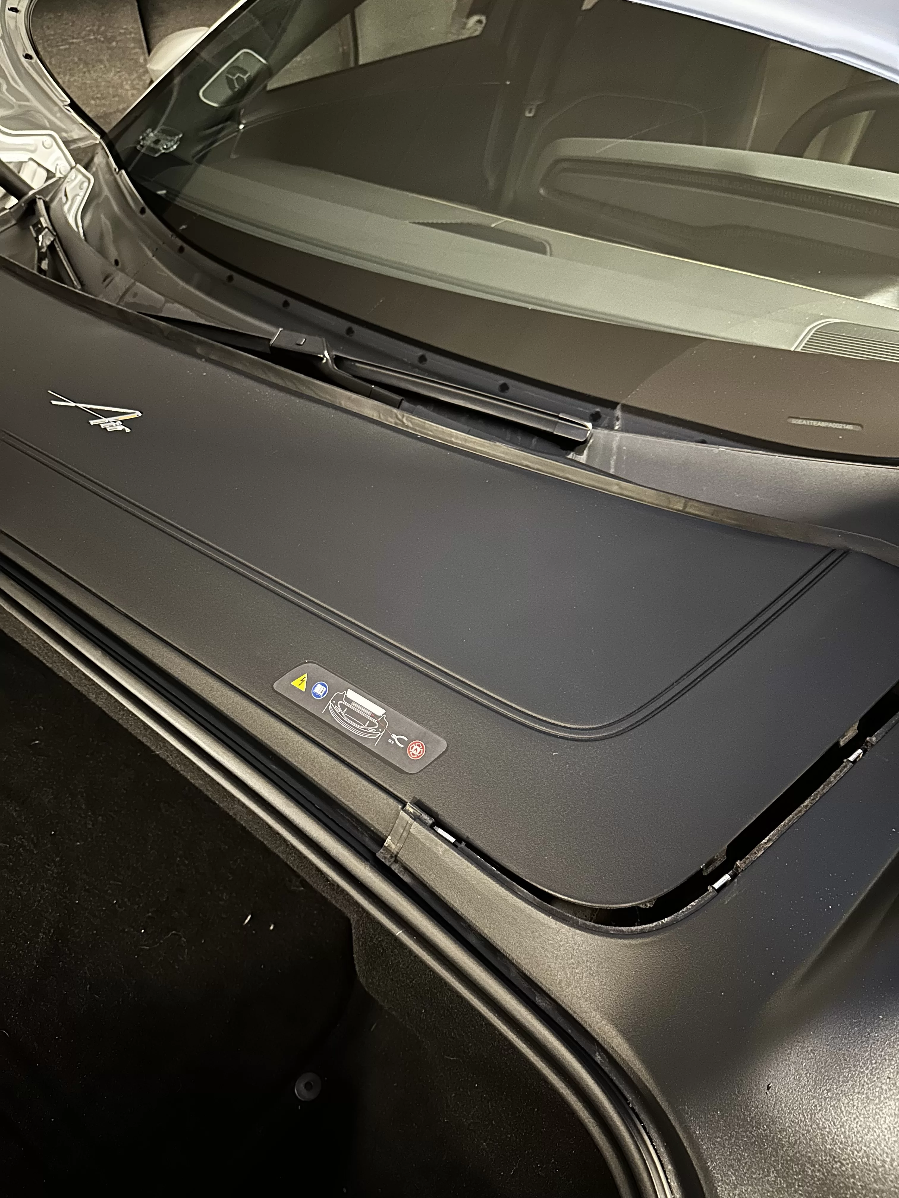

Start by opening the frunk and taking off the upper plastic cover that protects some important bits under the bonnet. It's connected via clips, so you have to pop them off to remove.

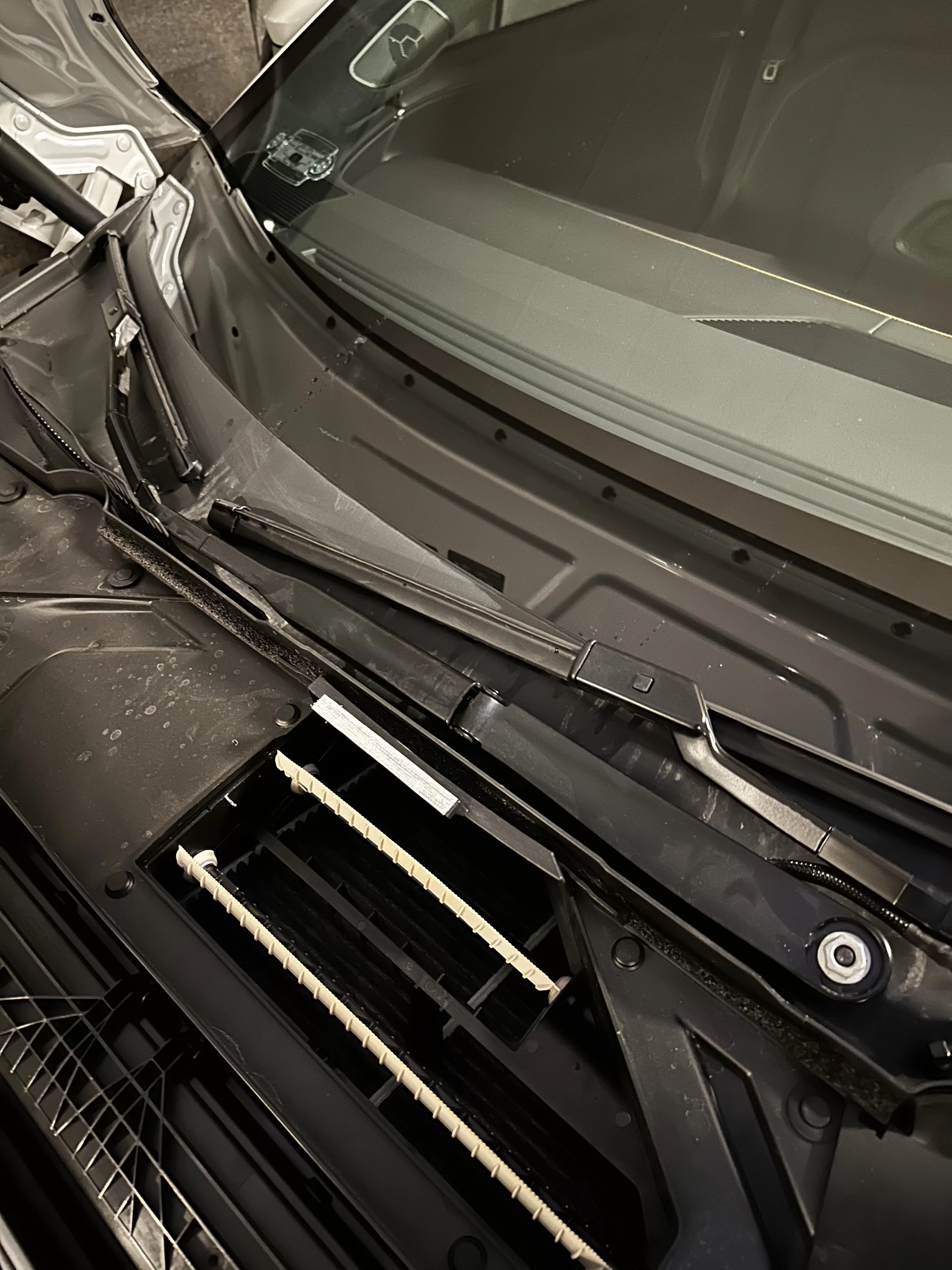

Once you have the plastic cover removed, you should see at the connected end of each windshield wiper arm, there's a round plastic cap. Pry that off with a flathead screwdriver.

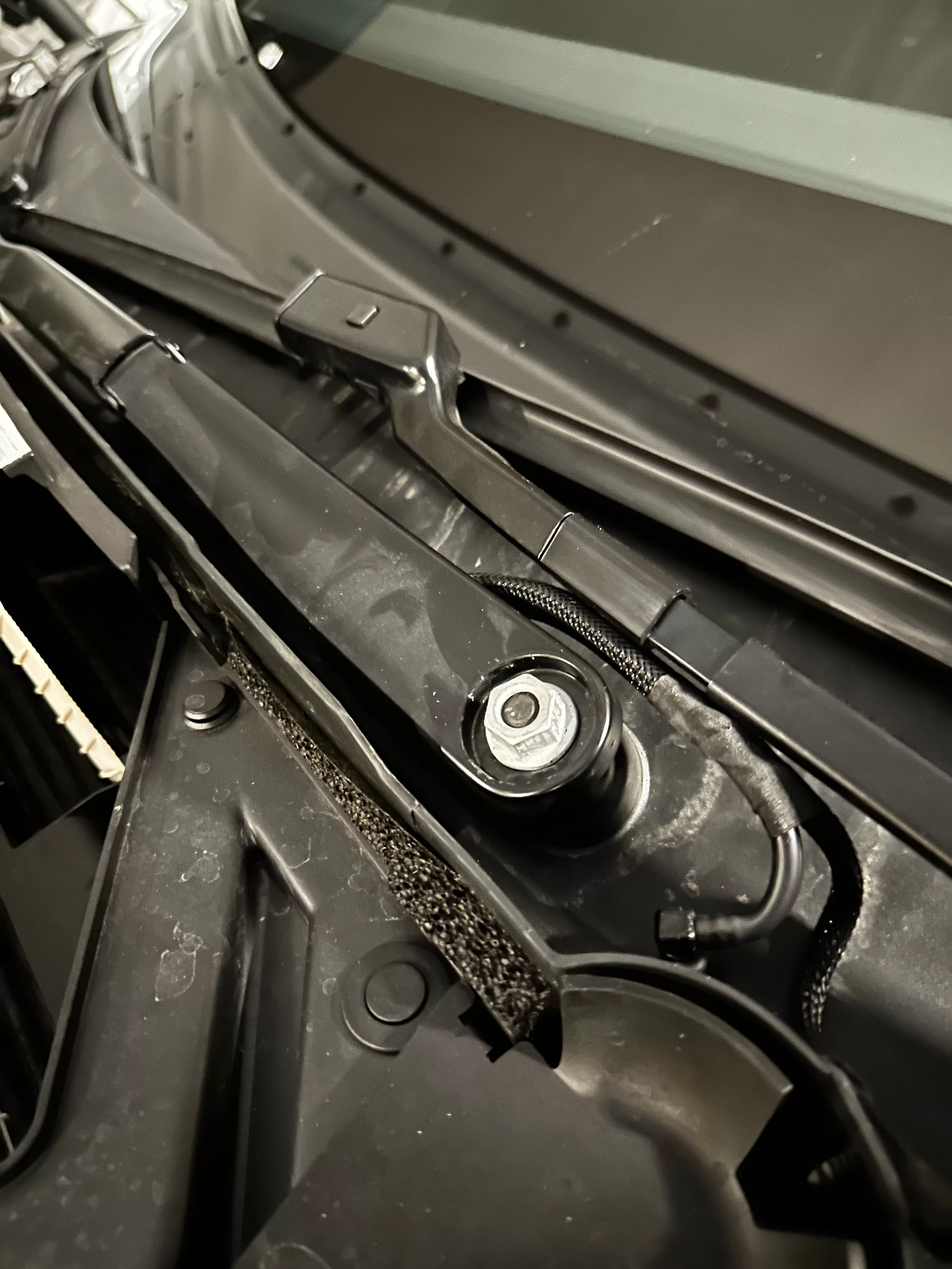

Once you have the cap off, you'll see the nut beneath. Using the wrench, tighten the nut.
Be sure when you are tightening that the wiper is fully down and at rest along the plastic edge at the bottom of the windshield. If the wiper is turned up when you tighten it, the wiper will not go all the way back down, and it may bang into the other wiper while deploying. Tighten with the wiper in its resting position, in other words. Like so:

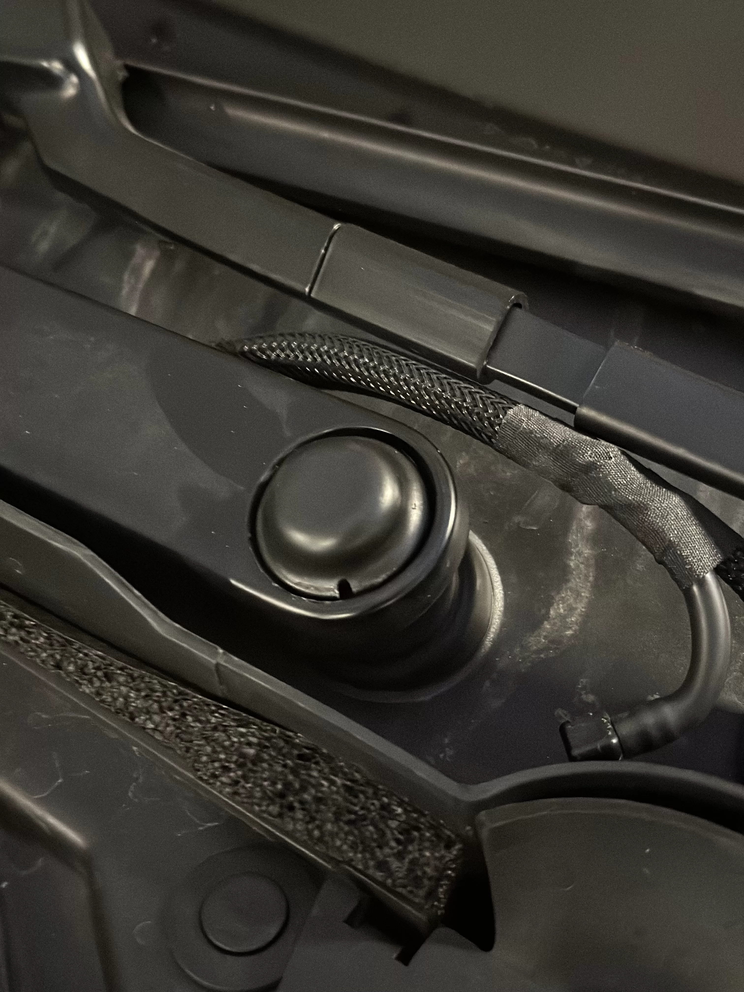

Once you have the nut nice and tight, replace the round cap, replace the plastic cover, and you should be good to go. Close the frunk and try out the wipers. They should function normally again.
