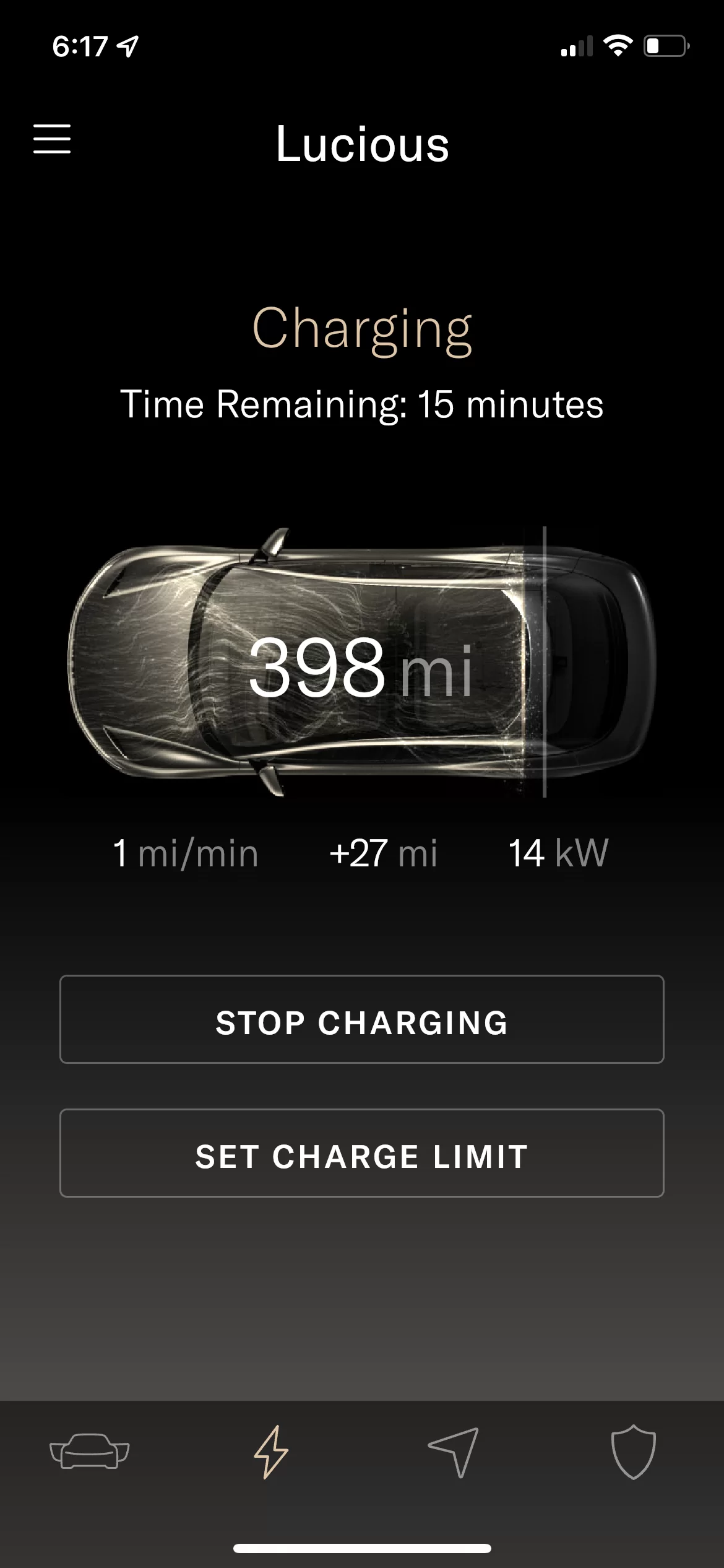

Yes; if you hardwire you can charge at up to 50 amps (48A depending on the charger). If you use a 14-50 you're limited by code to 40A.Deane .. just curious, how does hardwiring charge the car faster? I'm waiting for a VIN assignment and was going to install a 14-50 outlet (and then decide which charger to buy), but if hardwiring is better, then I may order the Chargepoint home flex now.. thanks
