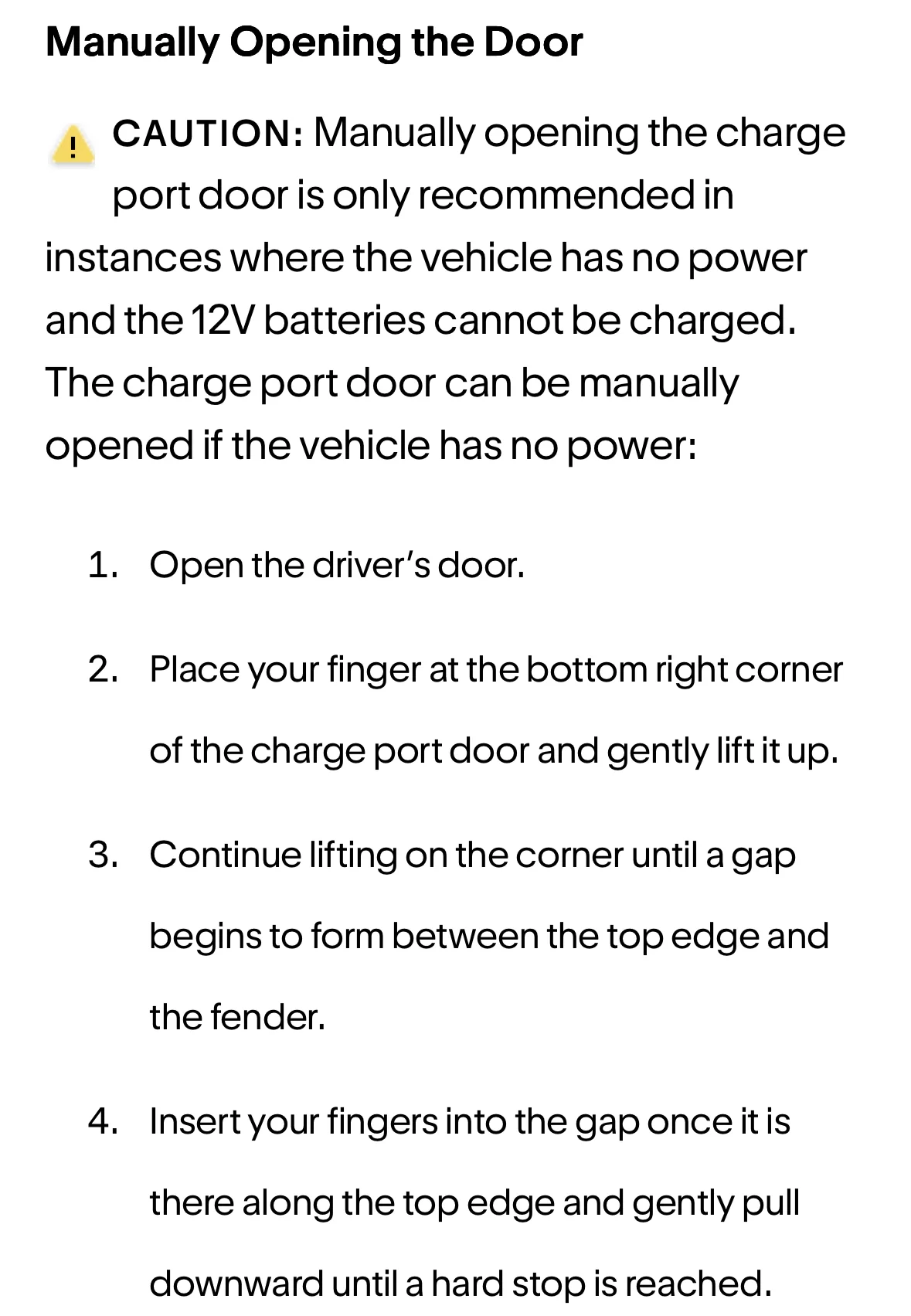

From the manual:
The charge port door (and access in general) is powered by the 12V. There are instructions in the manual for both manually opening the charge port door and jumping the 12V externally - leads are buried up in the rear right wheel well. I would guess you need 12V power in order for the car to initiate charging as well.

Step 1 made me wonder, how would I get this door open if the 12v was dead? Turns out you've got to jump the 12v door circuit via leads in the rear right wheel well, underneath the liner. Hope I never need to know that.
Some people have a habit of keeping their windows down even when the 12V is dead. In that case, just reach through the window and manually open the driver's door from the inside. It works as mechanical leverage system to unlatch the door if there's no 12V.
