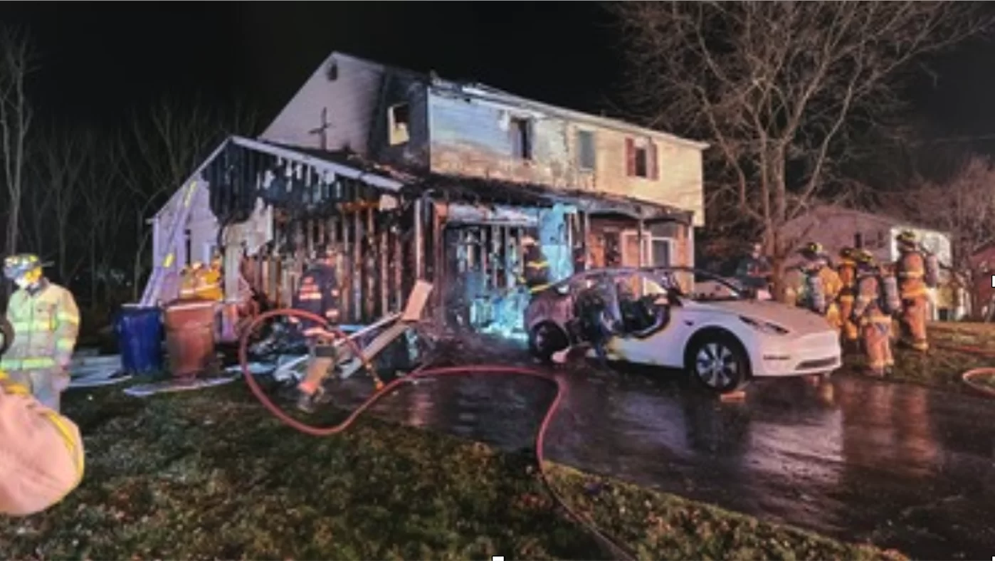

This is no joke. It you have any doubt about your electrician (like the guy above)...fire him. I had to send my electrician back when he showed up without a torque screwdriver/wrench. The terminal lugs must be tightened to spec. with the correct torque, using the correct tool.
Do not use a "dryer" outlet for charging your car. This is not designed for repeated plugging/unplugging. EV chargers are cheap and add value to your home. The cost to professionally install and have township inspection is trivial. Go hardwired. Make yourself happy. It's the future.
The cable gets hot ... good to know it's been properly installed and inspected.
Lots of help available from users of this site. It's good to do some basic research so you know if your electrician is cutting corners. My township inspector never looked at the work = he just asked who I hired and gave me a sticker. At least I'm legal if the house does burn down.
