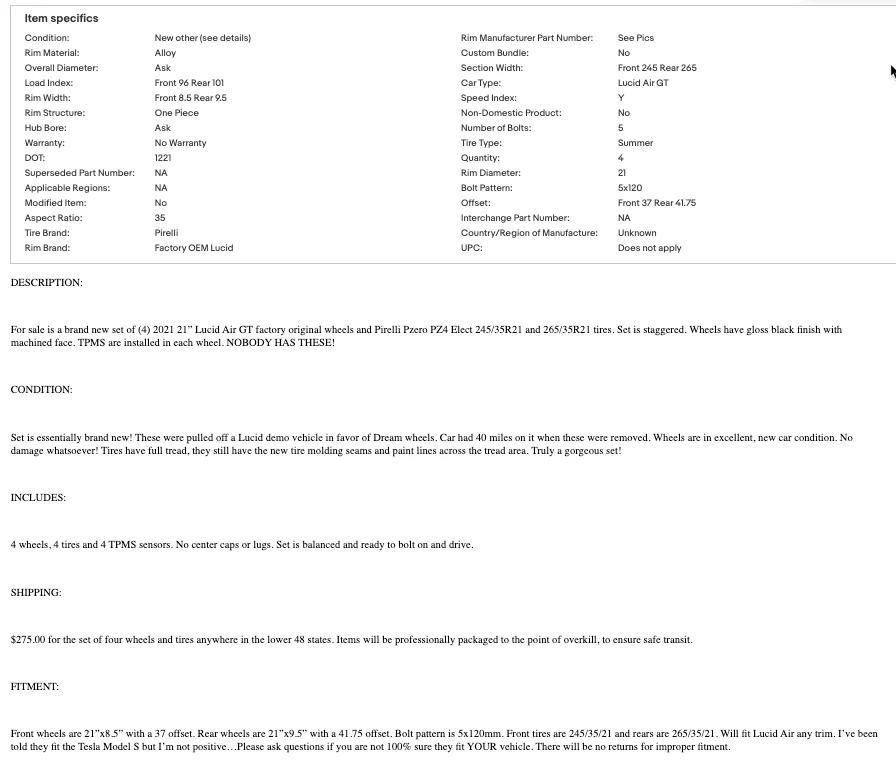

I've just learned that the Lucid likely has the same bolt pattern as Model S. Details are here (whether to trust, I don't know) https://www.ebay.com/itm/124911184843
@TheNewAero_Alexander if you send me a set of wheels, I would be happy to do a fit test on my Dream Edition with 21" wheels.
I wonder what the error was that caused the seller to remove the listing?
If the data in this listing were accurate, it does suggest that Lucid and Tesla wheels would likely be interchangeable. The only missing datum is the center bore. The front and rear offsets would be compatible with the 40 mm offset of the New Aero wheels (as that is probably an average of the offsets between the front and rear wheels, which would probably vary slightly due to the different rim widths).
Thank you, that is super interesting. We just need to know the centerbore to be sure. That is probably not even in the manual. As soon as I know this I am interested in sending rims for testing.
