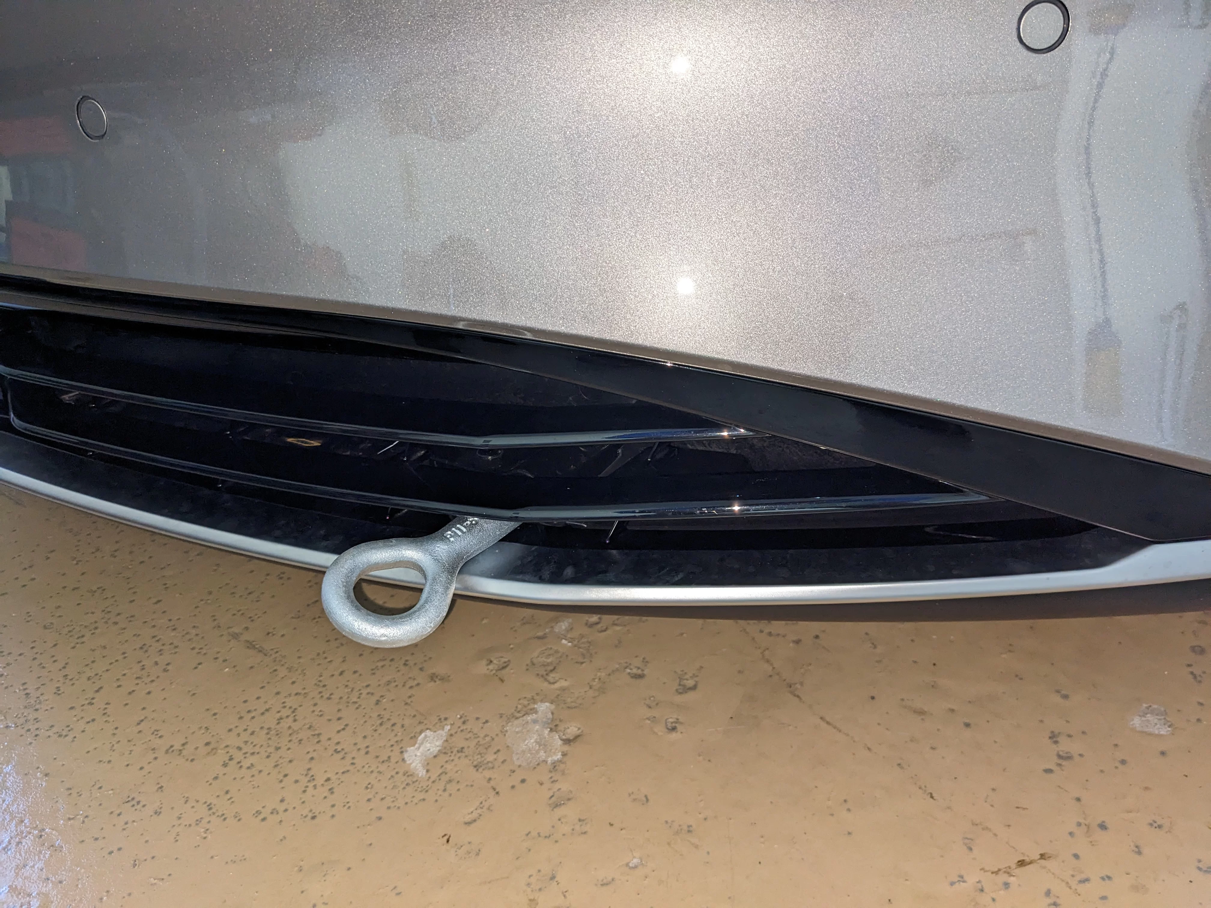

Software engineers don't want you to know this simple trick to prevent bugs:
haven't had a single issue since i installed the tow loop
Well when you screw that thing in it pushes the “easy” button.

...it was raining and I was in the front at the 4-way red light in rush hour...on my belly looking for the cover flap for the tow loop...when the tow truck appeared. I finally managed to thread the bolt, when I went to put the car in neutral so he could winch it on the flatbed the car lit up clean. I paid the tow guy, thanked the cop, and I drove it home. I decided to leave the tow loop in. Haven't had a problem since.
i'm just sayin' the tow loop is a data point
