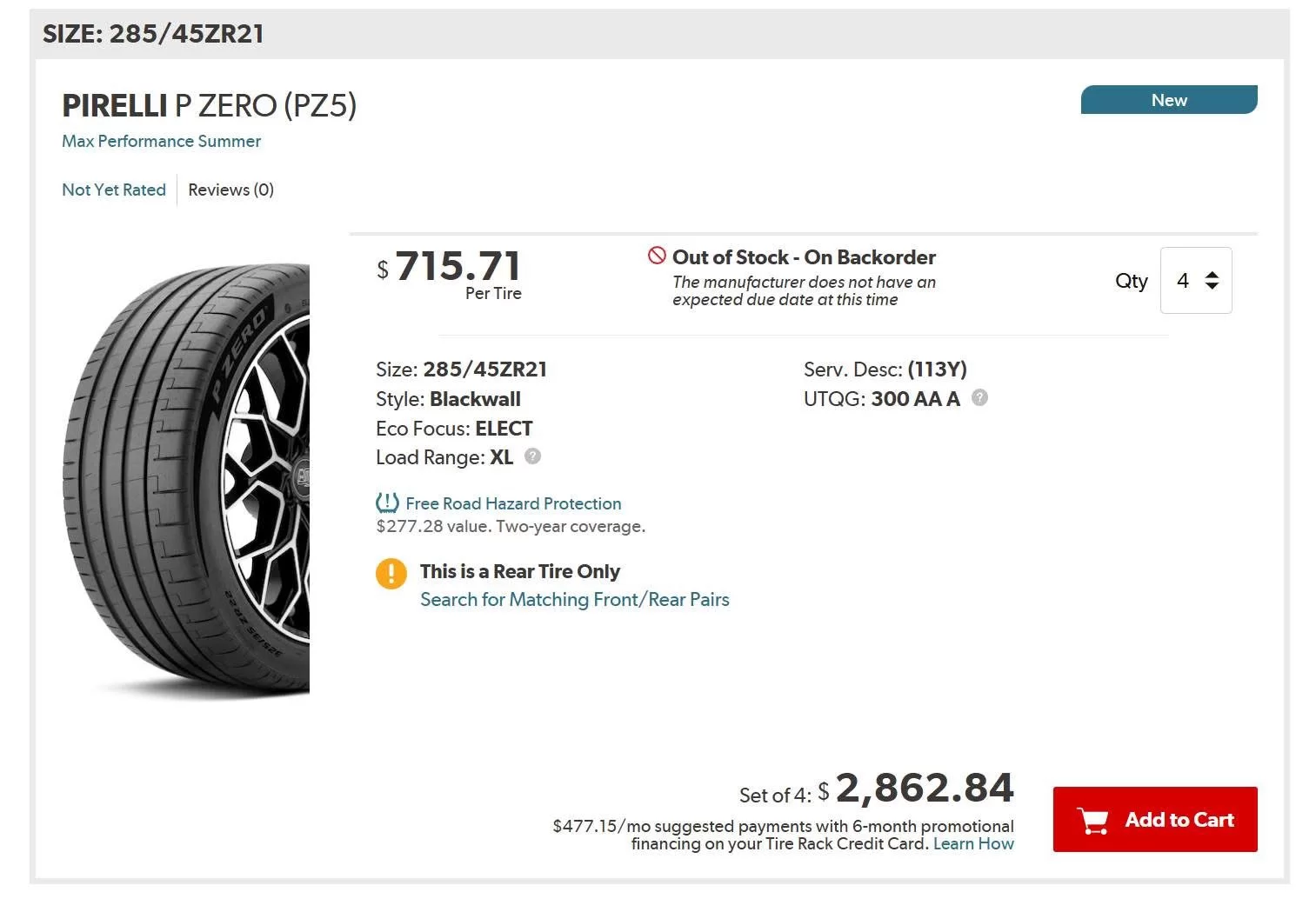

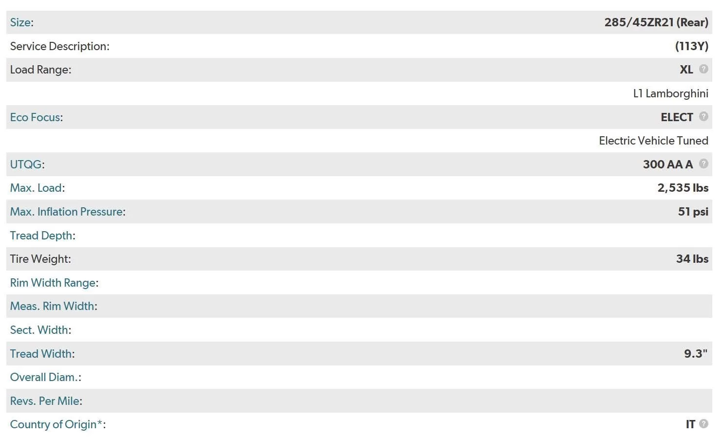

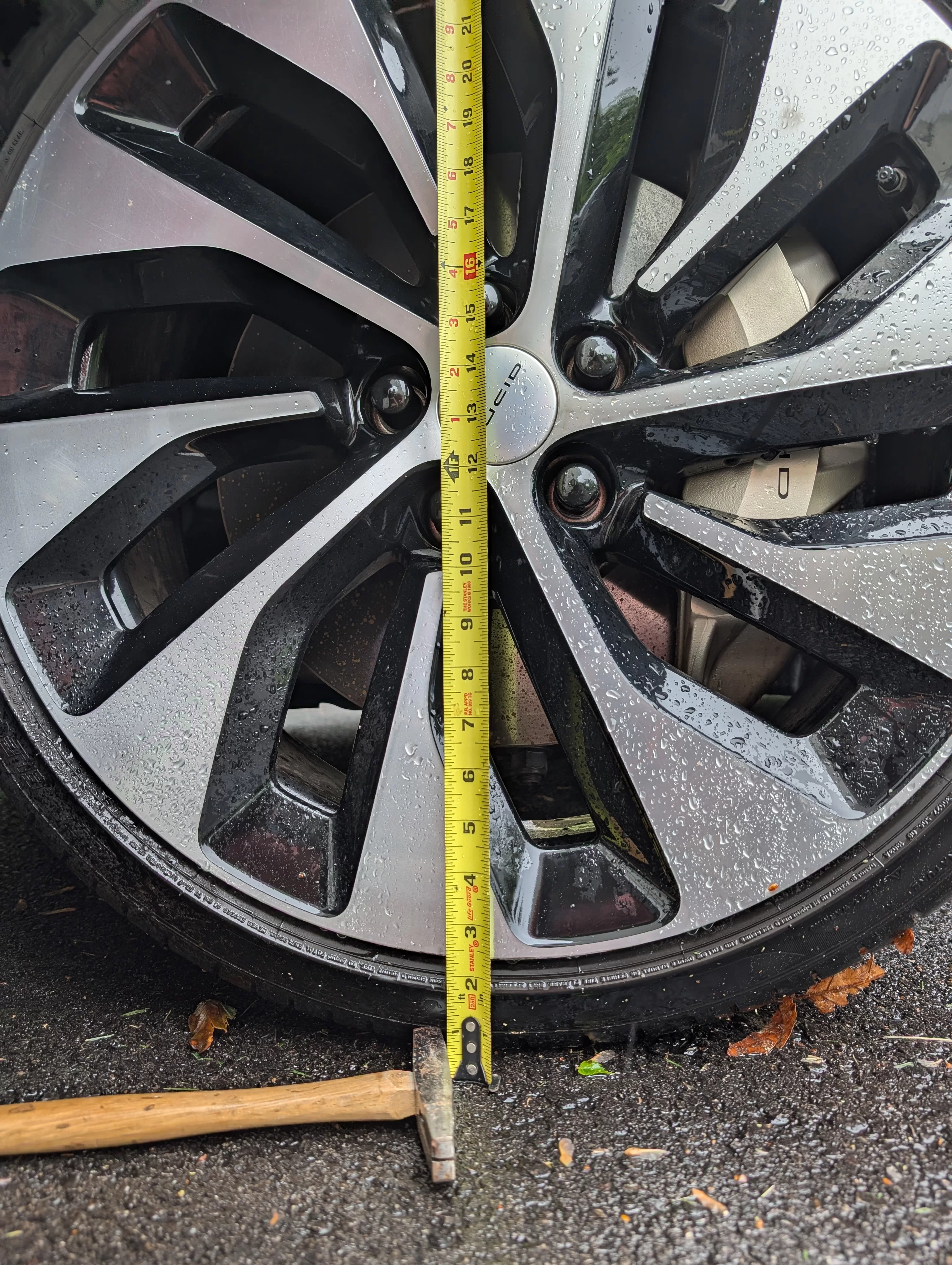

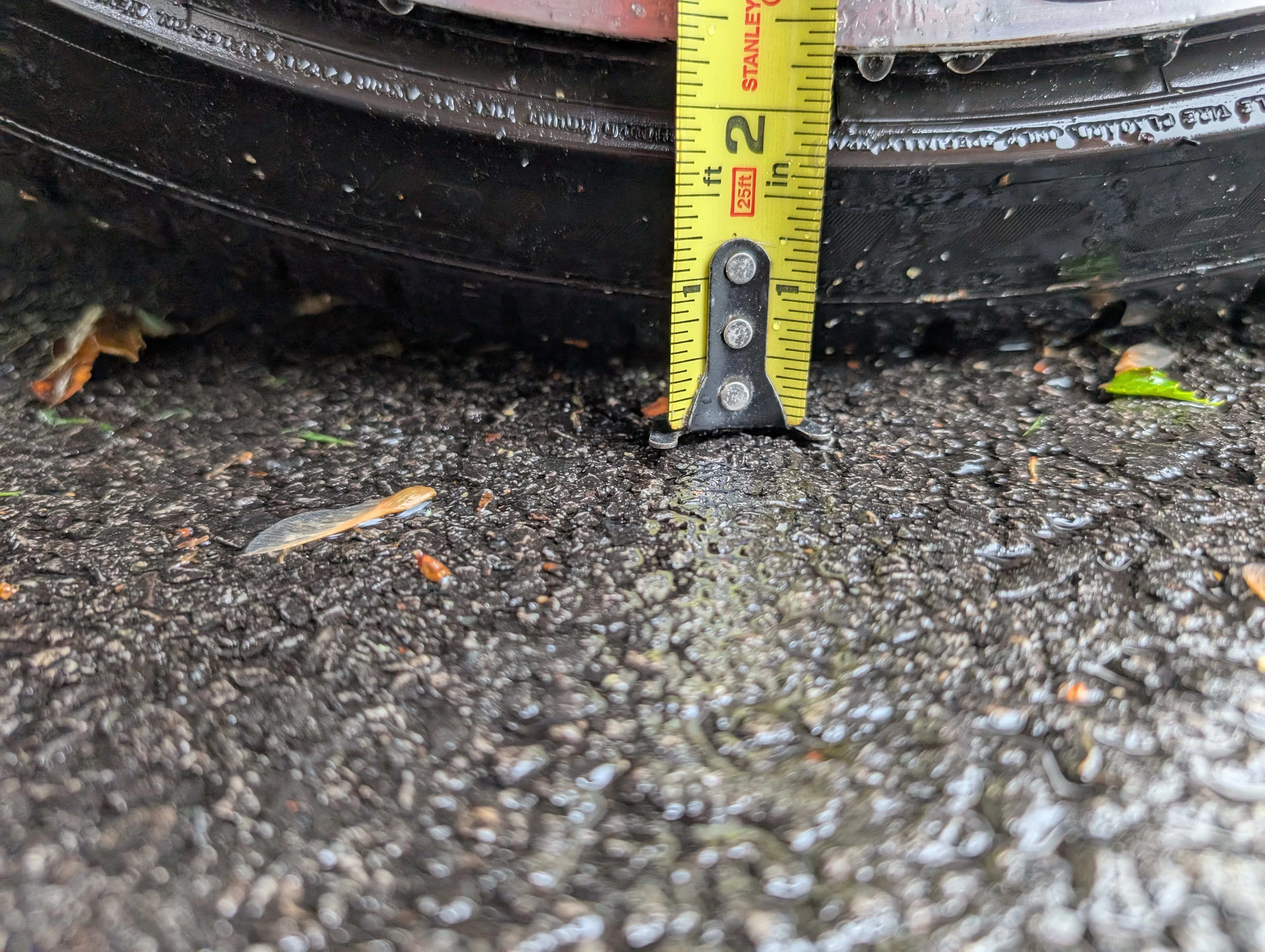

The tire game is rigged, they are labeling things 285 while making a much smaller part of tire touch the road. Difference between 21” rear and 23” rear is 1.4” in the same size! Difference up front is 1”.

The Pirelli PZ5 on the largest Gravity wheels is a very "square-shouldered" tire that seems to put more of the tread width on the ground, as shown in this short video (1:50):

I compared to a Vredestein all season tire too, wishful thinking only gets one so far. Over 1” difference on the 285 side

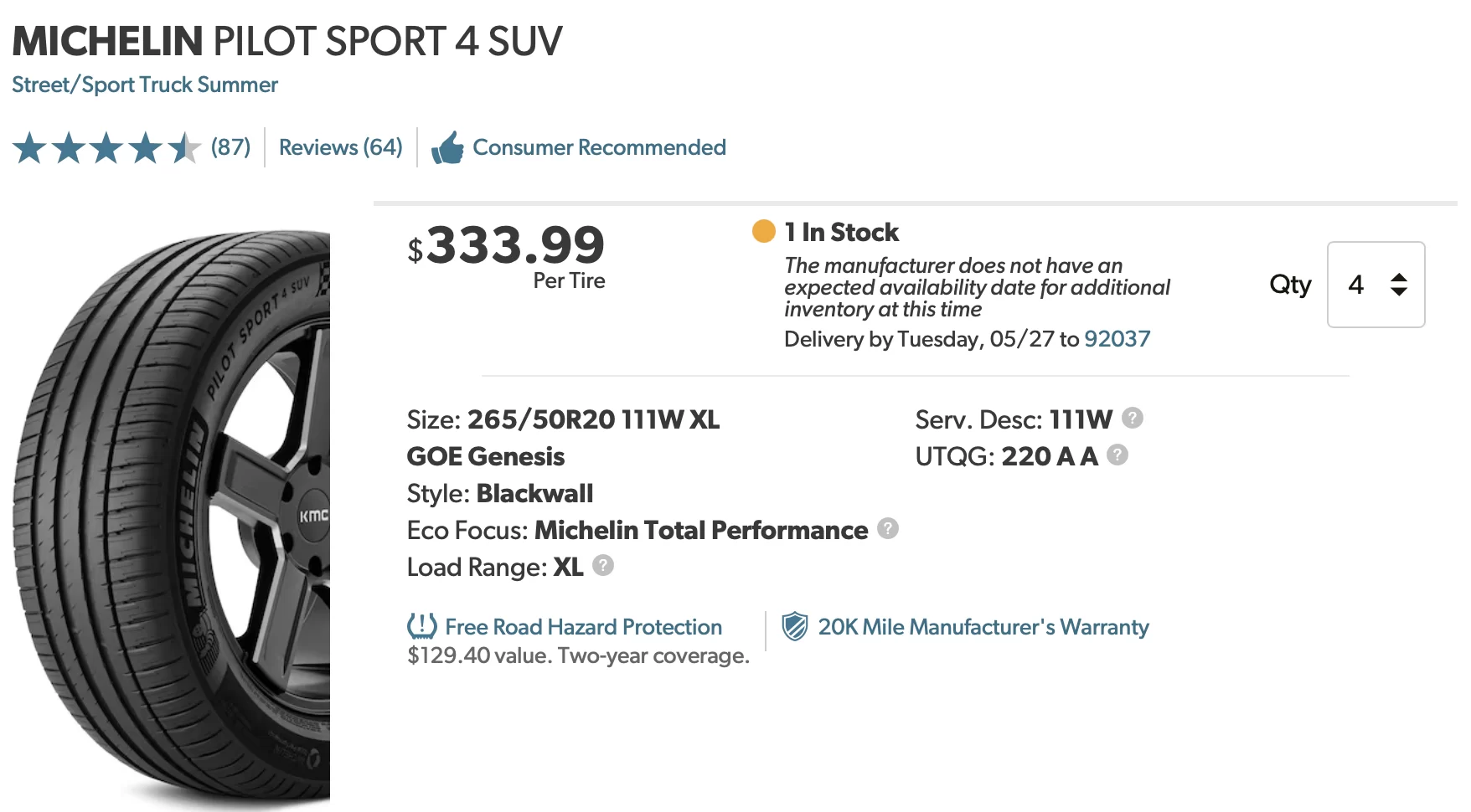

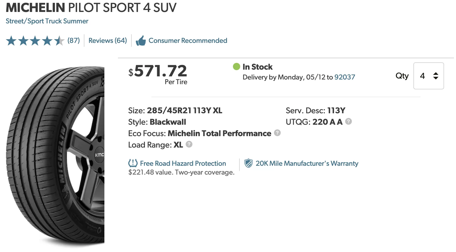

Just found a summer tire for the rear on smallest wheels. Hope Eric is not reading as if that’s my only option I will mix and mismatch!

Pilot Sport 4 SUV looks right too. Doesn't show up when you search though (maybe because front is an OEM tire?)

Probably because front is W rated and the tires must go as fast as the vehicle they are mounted on, in this case the Dream as it has the same exact wheel and tire. Have to conclude the Dream should go over 168mph, napkin math and all.
Ah. That makes sense. Didn't notice that Hankooks are rated for 186mph!
