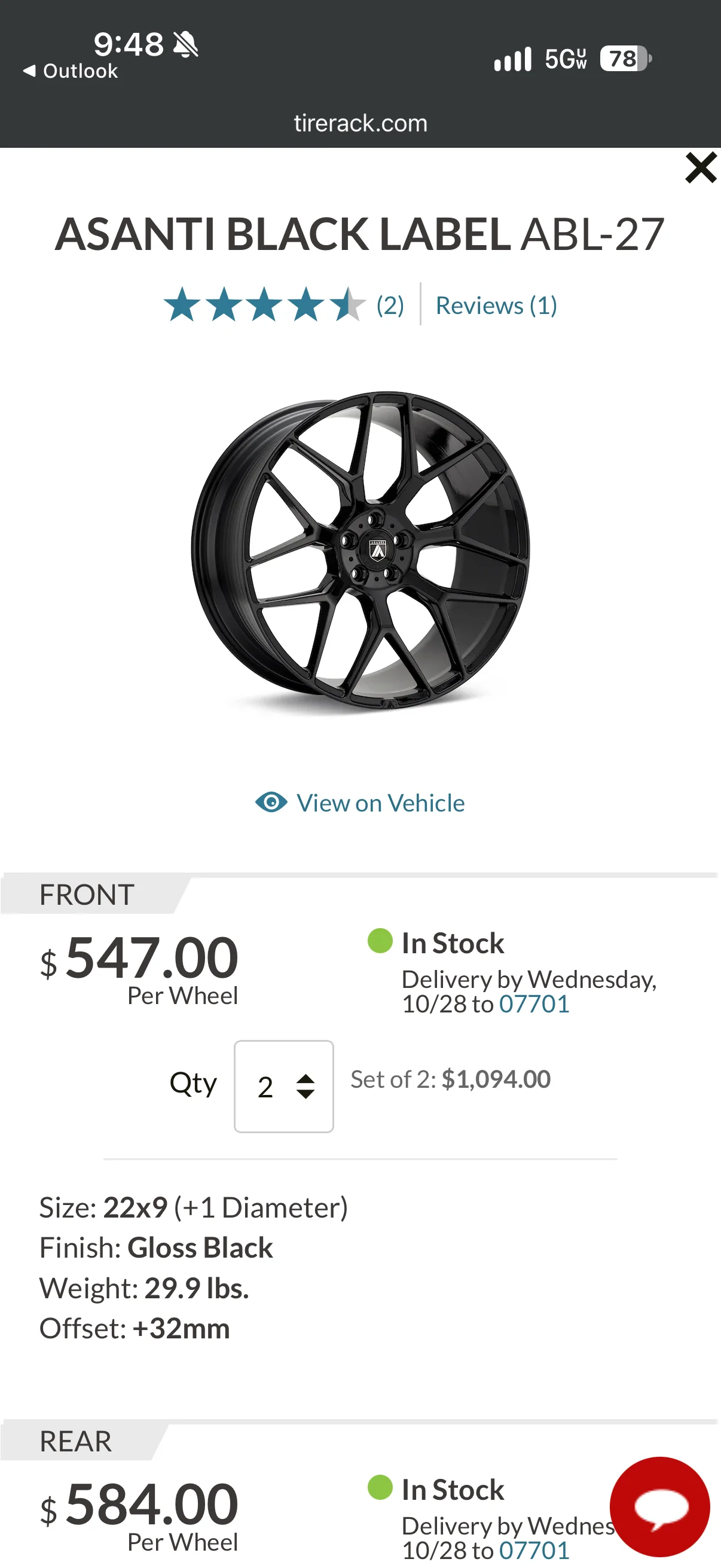

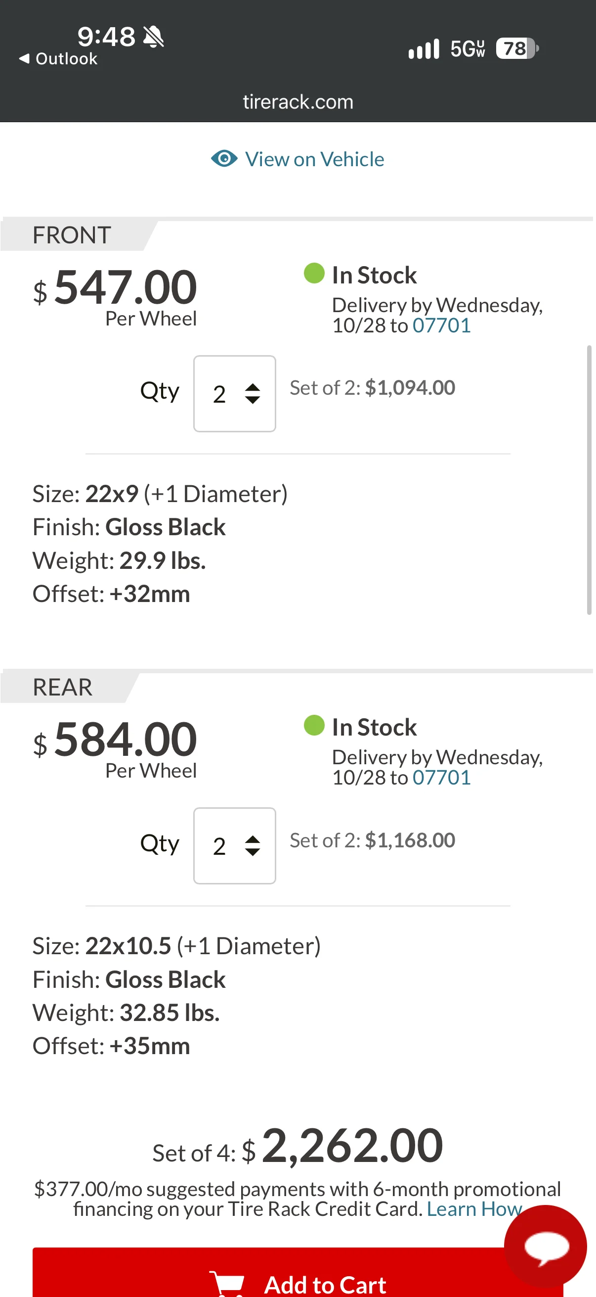

You can get custom 22s and pick whatever tire you want.
Attaching one easy off the shelf example, can be found by looking 2015 Comaro SS as vehicle.
All I will need is proper center rings, otherwise a good direct light weight fit for a 2100lb capacity wheel.

Soulds like a $2300 one time ticket for wheels and then cheper and wider selection for tires as long as I own the car?

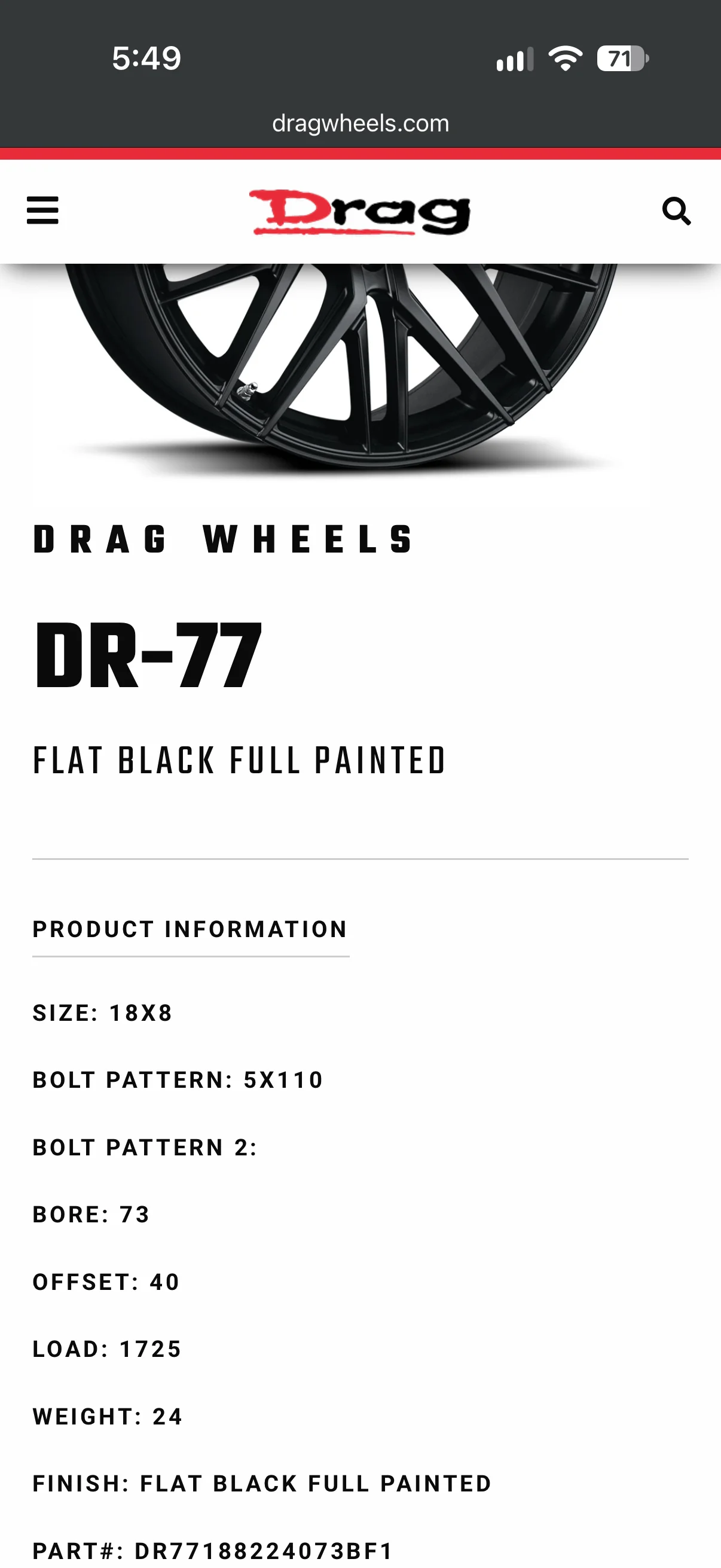

Drag DR-77 wheels 19" front 20" rear, Yokohama Geolandar X-CV all seasons. They guaranteed everything will fit or I get my money back. Load bearing all checked out in their system.
I hope the car will look OK with these smaller wheels, larger walls compensate for smaller rims.

The load on the Drag wheel is completely insufficient. Gravity manual lists a 2100/2200lb maximum load front to back. You would be fine with 2100 all around if you aren’t towing while full of people and luggage but under 2k is asking for trouble.
Whoever you spoke with has no idea what they are dealing with and the tire is not one I would put on a 6000lb missile.
I could be just performance biased, of course.
