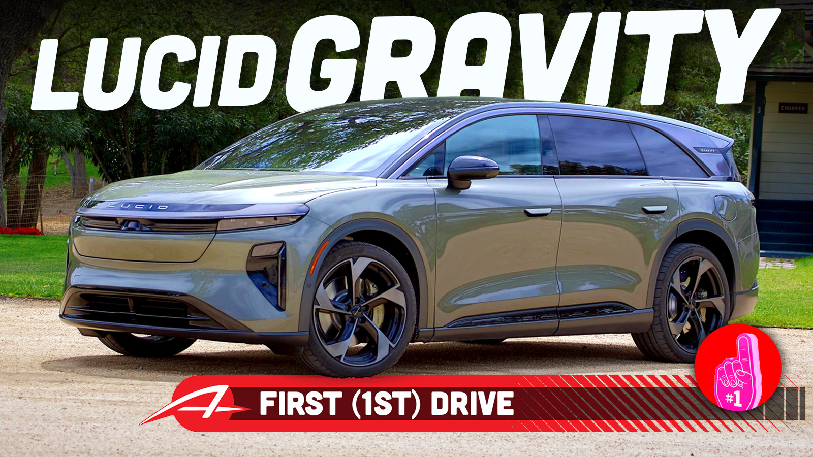

FWIW, the new Pirelli P Zero PZ5 that will be on the largest Gravity wheels has a considerably squarer shoulder than the PZ4 it updates. This is interesting, as European tire brands usually stay with more rounded shoulders due to the more pronounced crowning of most European roads compared to U.S. roads.

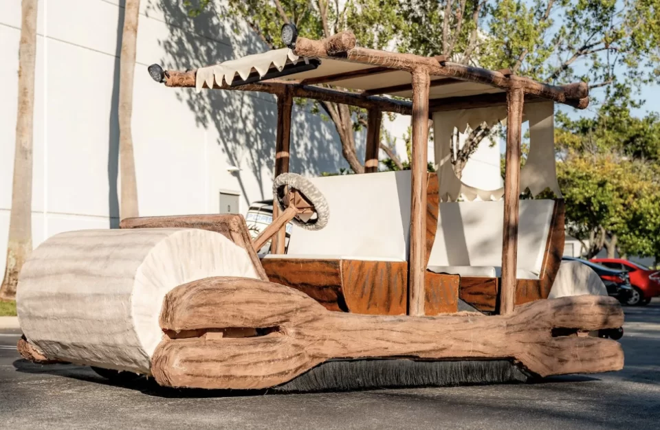

So you stole Fred Flintstone's sports car, didn't you? :)
Oh, I didn't realize. It came up on a google search for Henrik Fisker's next prototype . . . . 🥴

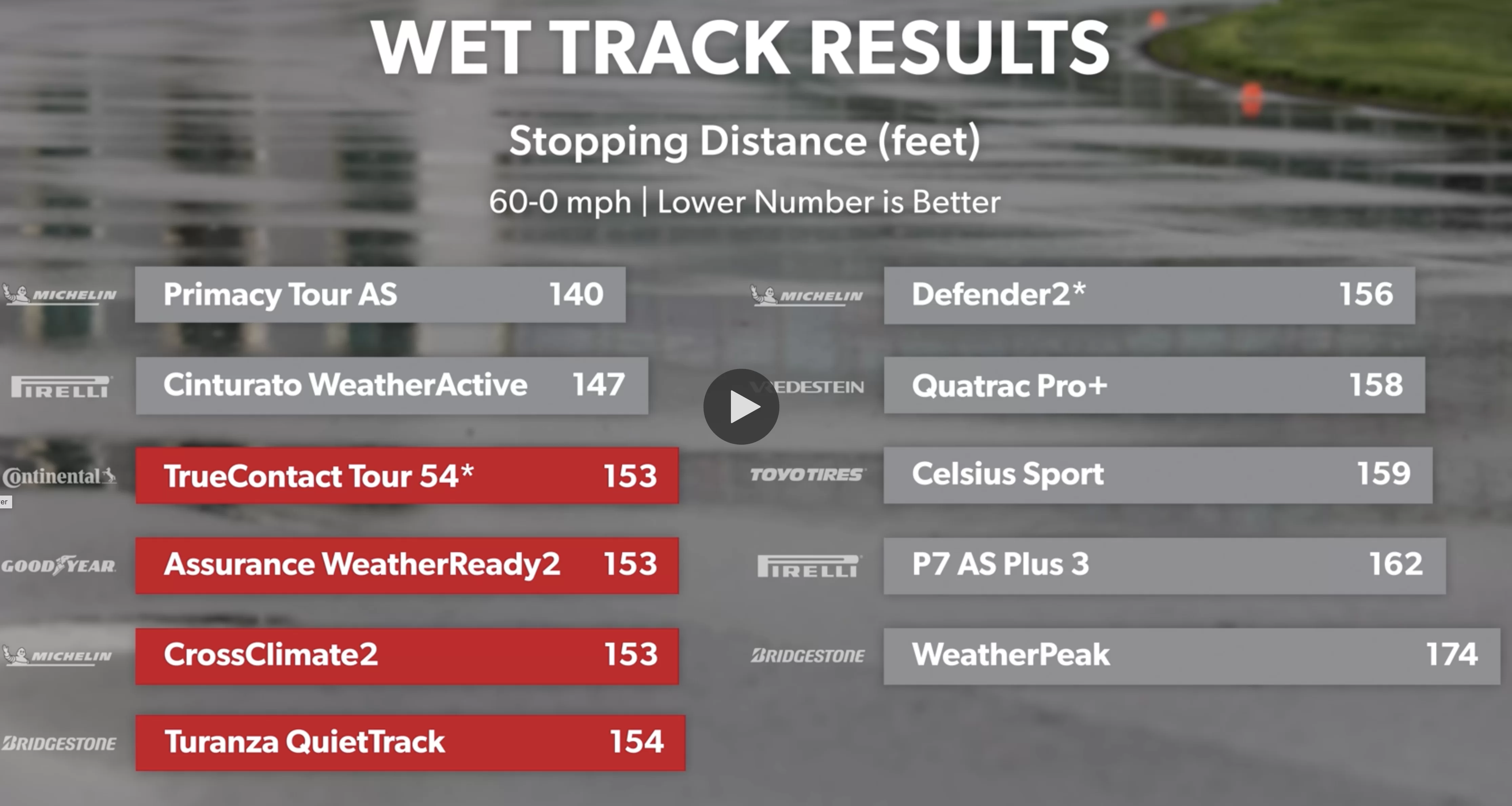

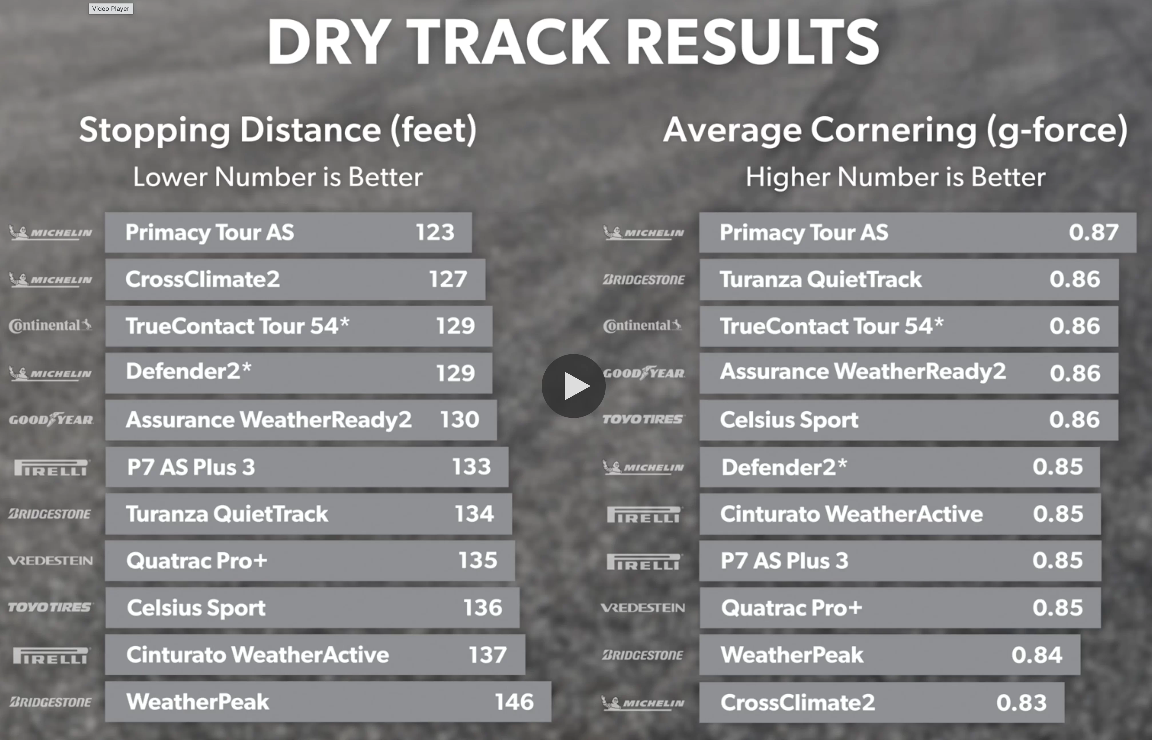

This tracks the test results from Tire Rack on the Primacies. In fact, of 20 all-season tires tested, the Primacies were among the quietest and had the best wet and dry braking numbers -- by a considerable margin.
The downside is that they're not particularly efficient. Unless there is are erroneous entries on both the Lucid spec sheets and the order configurator, the EPA range for the Primacies is the same as the Pirelli PZ5's, although the Primacies are on smaller wheels that also look to be more aerodynamic than the largest wheels.

I saw that test from The Tire Rack too. I considered the Vredestein Quatrac Pro+ instead, as those are also available in 20-22" sizes for Gravity. (I've considered buying a Gravity with the 20/21" wheels, and eventually replacing the tires with the Quadrac Pro+ if I didn't like the Hankooks.) They don't seem to handle as well as the Primacy, but may have less noise and better efficiency, and they seem to get better grip on snow and ice. But there are no dealers selling Vredestein in my area. So, I tried the Primacy, and I like them a lot. The ~8% loss of range compared to the Hankooks seems like a good tradeoff to me for the much better handling and safety.

I haven't seen the Tire Rack tests before. But, they do confirm my sense of what the best tire for me is: CrossClimate 2. I'm looking for a tire that performs great in the snow, while still being perfectly acceptable in warmer conditions. I do a lot of driving between San Francisco and Lake Tahoe, and one road trip commonly includes both snowy conditions and 70 degree driving. I've configured my GT with the smallest wheel choice, and I figure there's a good chance that I'll replace the stock rubber with a 3PMSF rated tire as soon as winter hits.
