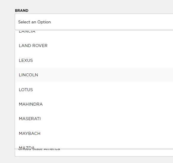

How do you register when Lucid isn't an option?

Pirelli told me that the Brand and Model were not required.
I entered Lucid Motors as my dealer with an address of 7373 Gateway Boulevard, Newark, CA 94560
