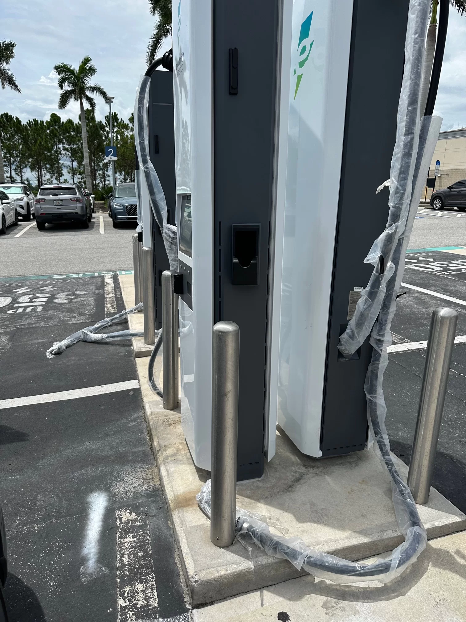

We went to the EA chargers at The Mall at UTC, a huge shopping/dining complex in Sarasota, FL right off I-75. We have used those chargers before, always with the usual mixed result from EA: half the chargers malfunctioning and cars queued up for the few that were working.
The site was not operating. They had installed new chargers . . . and all at once instead of phasing them in to keep the site at least partially operational. In fact, the installers had just left the cable plugs lying on the pavement where they could get rained on and/or run over. I guess this is meant to continue the tradition of having half the EA chargers at a location out of service. Also, they were all CCS plugs, with no NACS plugs available -- something I thought EA was going to introduce with new charging installations. In short, it was the usual EA shit show.

EA has installed a few new 400kW Alpitronic HYC400 dual-cable NACS/CCS plug charging stands as a pilot test, but those less reliable slant-top balanced 350kW CCS stands will be around for quite a while.

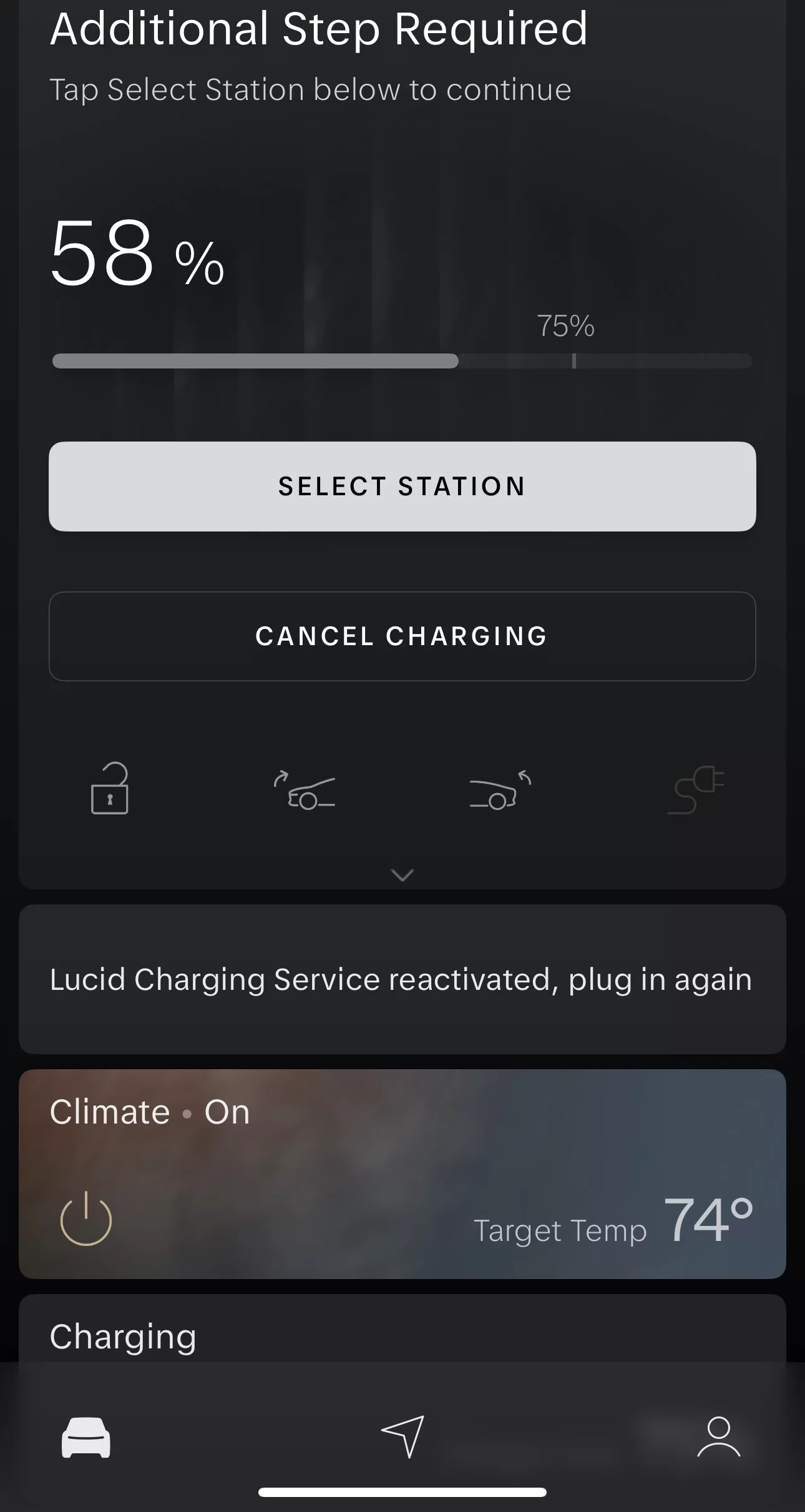

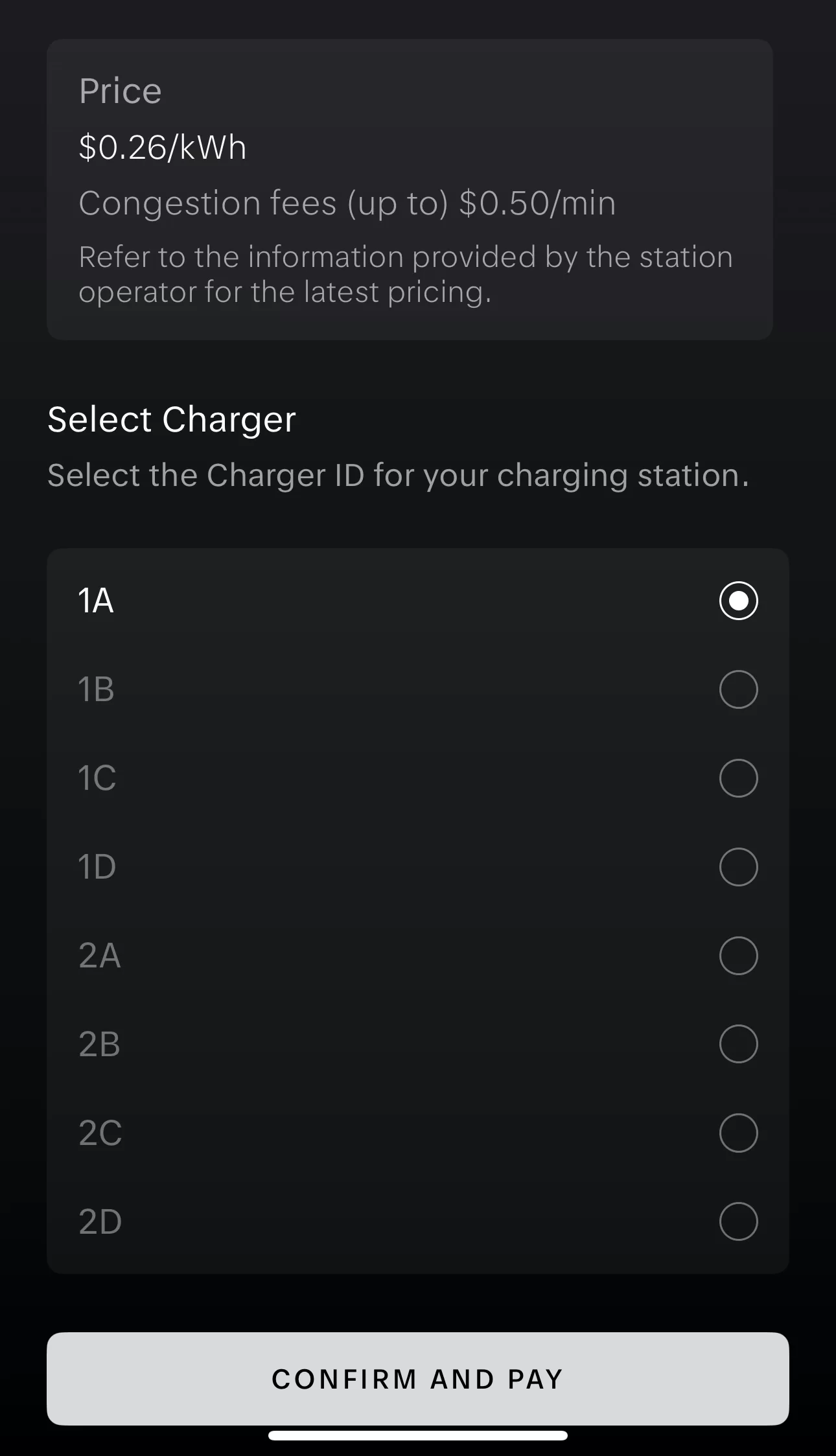

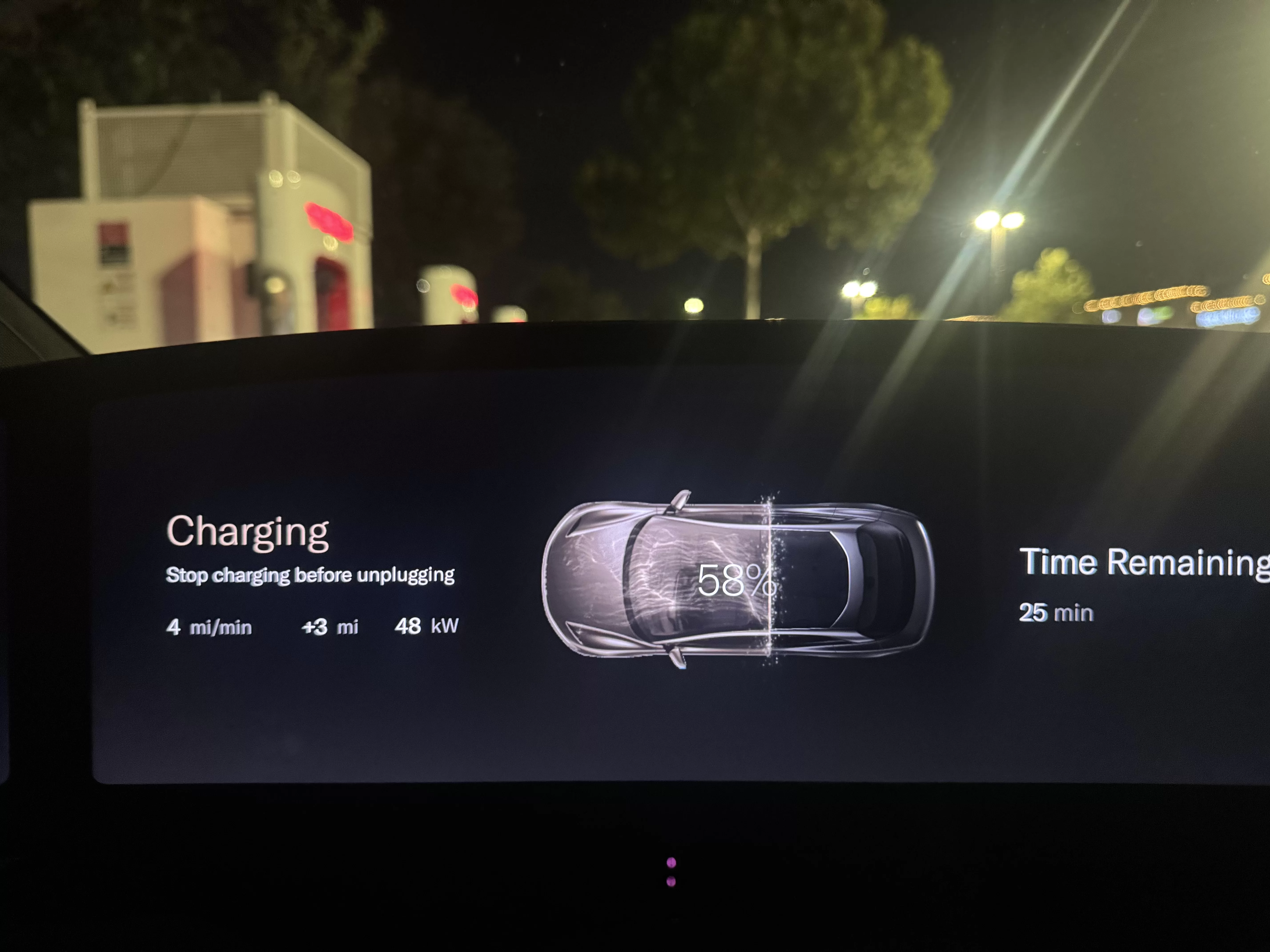

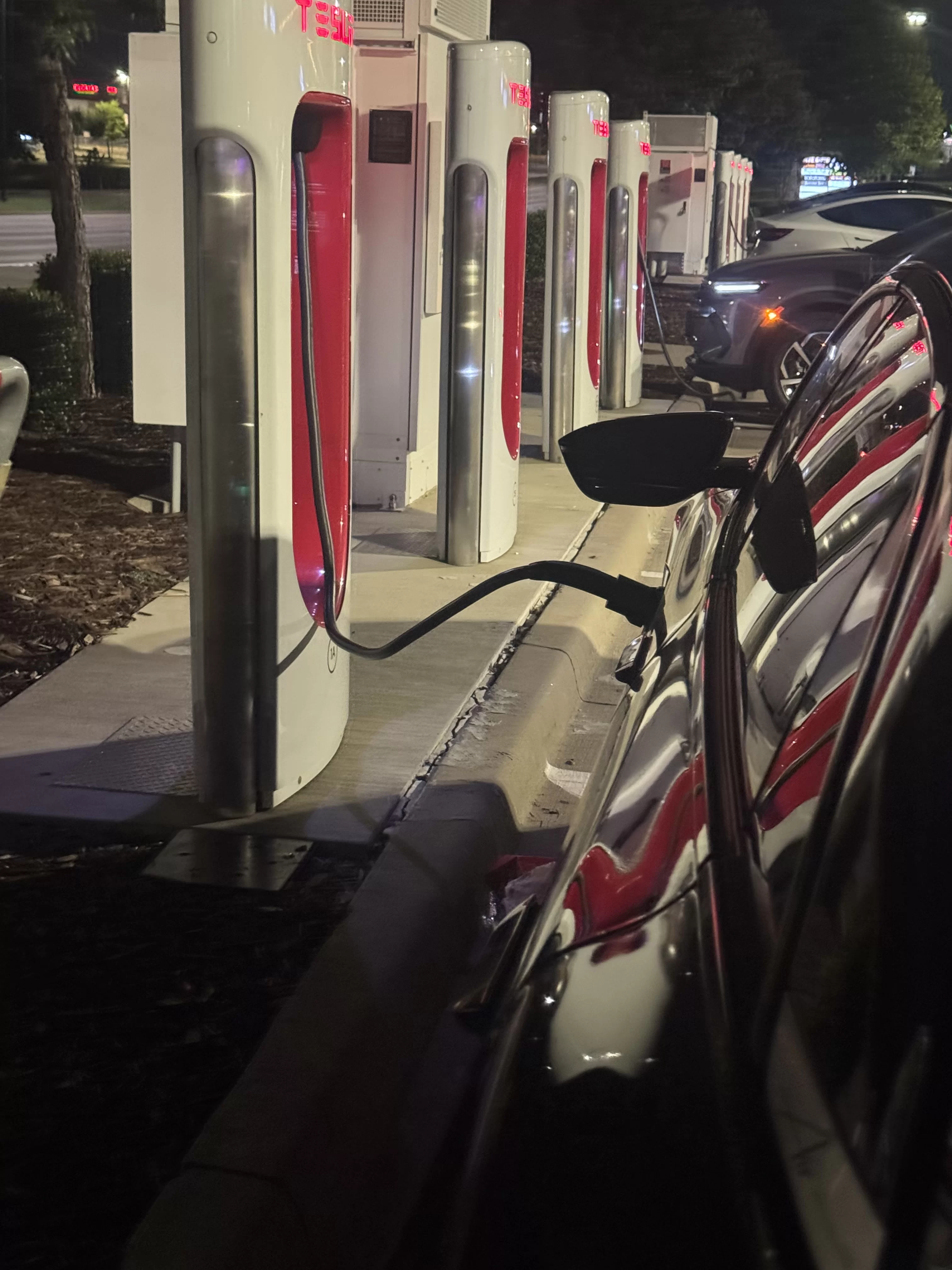

I was finally able to check out a v3 super charger - had to wait till 11:30pm for it to be relatively free. Parked parallel to the first station, as that was the only way to get the cable to reach. However, plug and charge worked fine without using the Tesla app. Car prompted me to open the Lucid app for additional steps, asking me to confirm I have the adapter and let me select the station. It charged sustained 48kW to 80% from 58%. Attached are the screenshots showing various prompts in the Lucid app.

. . . plug and charge worked fine without using the Tesla app. Car prompted me to open the Lucid app for additional steps, asking me to confirm I have the adapter and let me select the station.
I think "plug and charge" means you don't have to use any app to initiate a charge. For example, with the Gravity you simply plug into a NACS-partner Supercharger, and charging begins immediately. No apps involved -- except that if you have the Tesla monthly subscription to get lower charging fees, you have to initiate the charge through your Tesla account on the Tesla app.
Since the Lucid app asked you to verify you have an adapter, I wonder if having to use the Lucid app for the Air is a first-time thing only or will be required every time? When we used a Supercharger with our Air, the Lucid app said additional steps were required but did not give access to any such steps, so we had to initiate through the Tesla app, anyway.
I think "plug and charge" means you don't have to use any app to initiate a charge. For example, with the Gravity, you simply plug into a NACS-partner Supercharger, and charging begins immediately. No apps are involved—except that if you have the Tesla monthly subscription to get lower charging fees, you have to initiate the charge through your Tesla account on the Tesla app.
That's a good point. I guess plug-and-charge is the wrong terminology to use in these cases. In my case, the app's home page showed what needed to be done, as indicated in the screenshot. I need to see if similar steps are required in the future or if it truly is plug-and-charge.
Several other posters have reported also not being guided to the next steps on the Lucid app, while others are reporting your experience. It's another one of those Lucid software introductions that have random outcomes across the owner base.
It is possible that some of these users had not updated their app to the newest version.

From the posts above, everyone seems to be experiencing charge rates of less than 50kW. The Lucid adapter I received claims it is good to 500A, which would be enough to enable the full speed of the Superchargers. So is Tesla throttling non-Teslas?
I only need these SuperChargers when I am on a long road trip, and on road trips charging at <50kW is a non-starter. Remember, I purchased the car because they advertised "up to 350kW" charging rates. And the charging rate curve is workable - run down to 10% (still have 40 miles left) and get some nice fast electrons until you reach around 50%. 48kW might work in a rare circumstance, say, when I want to get a few miles at a SC while I am grabbing an In-N-Out Burger. But it's not the needed get-250-miles-while-I-visit-the-restroom charging rate.

I don’t know how many times this needs to be stated in this forum! Lucid Air will only charge at 50kW max on 500V chargers which is what Tesla chargers are. Add on heat loss and you’ll get 45-47kW.
Let’s stop with “Tesla is throttling non-Tesla’s”. It’s absolute nonsense.
Uh, I asked a question, not made a statement.
But thanks for explaining that the <50kW limit is a constraint that comes from the 500V charger infrastructure mis-match with the higher voltage design of the Lucid.
