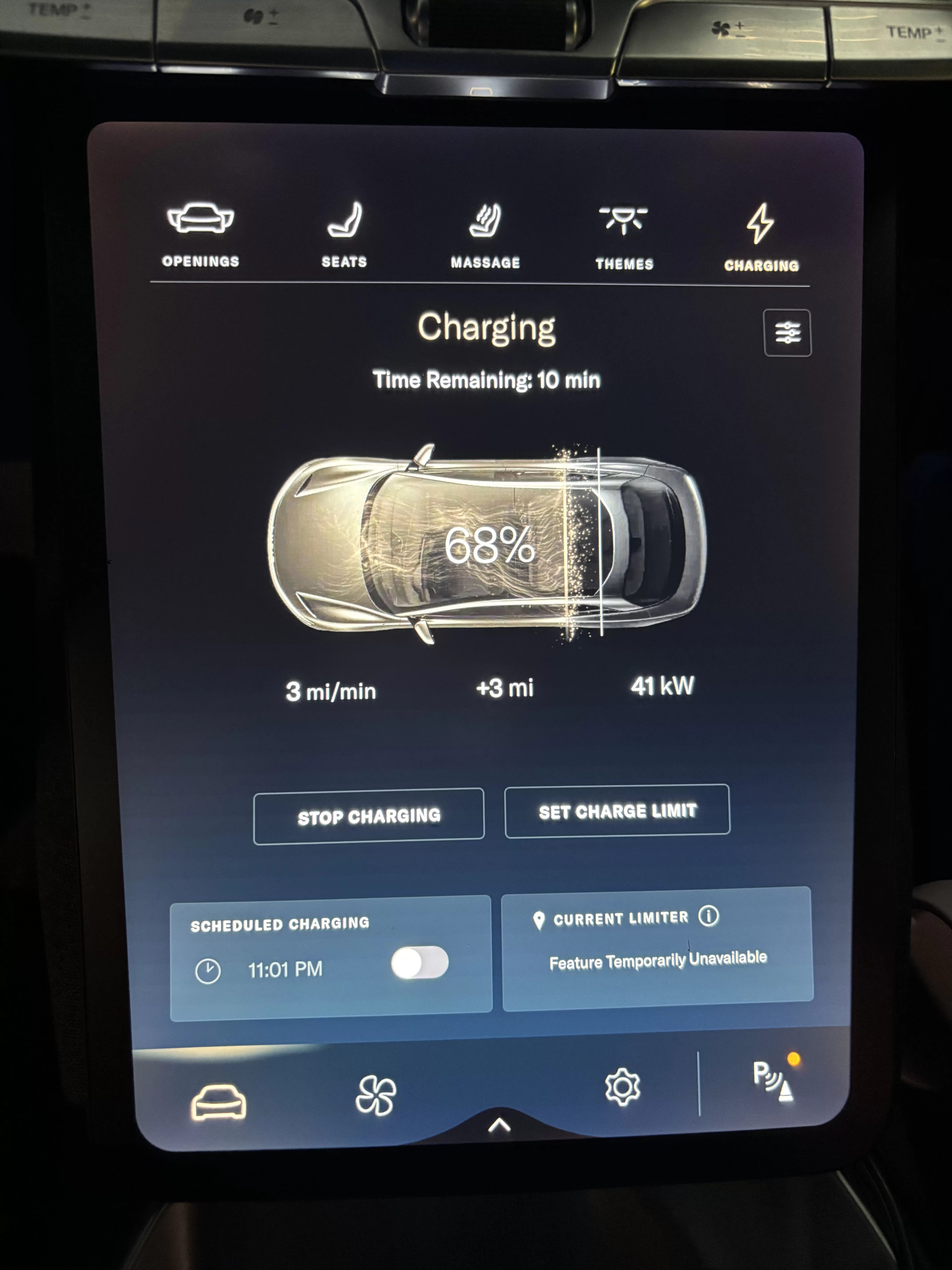

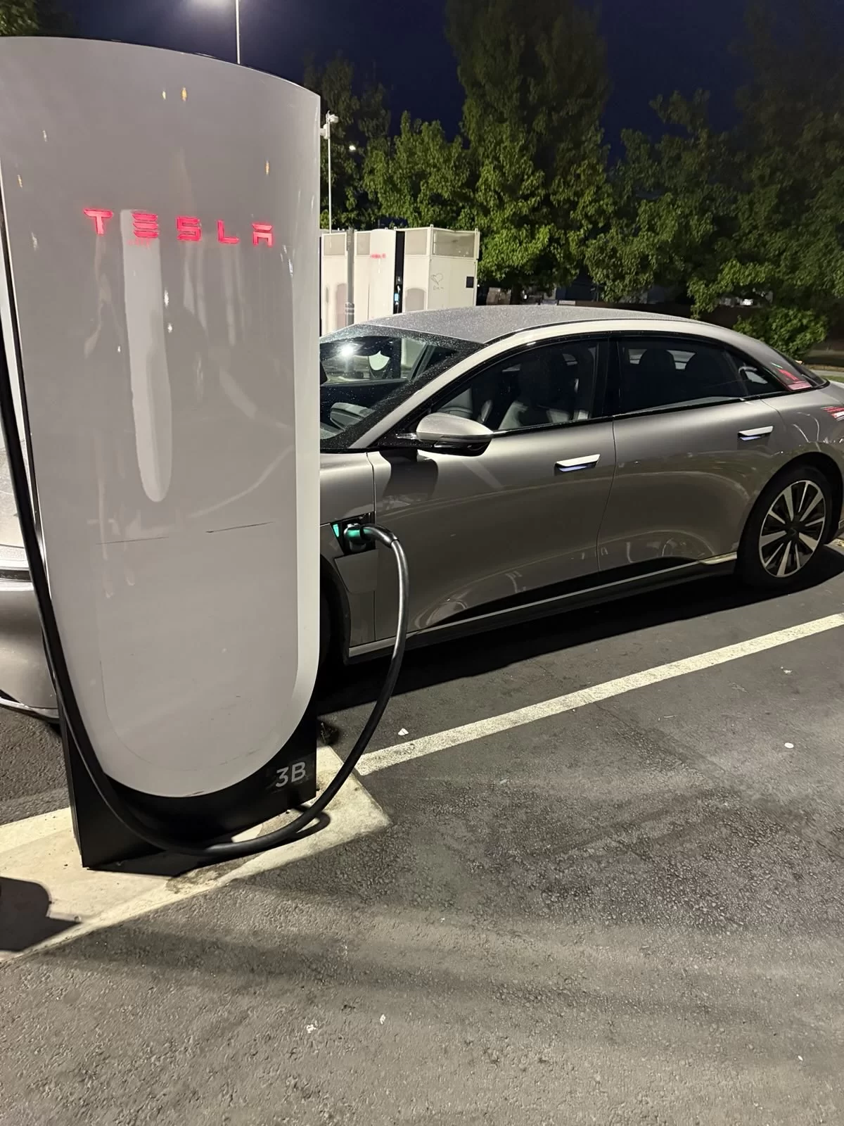

Sorry for redundant post with other thread -- I just tried it tonight here in Seattle and it all just worked super-smoothly. Plugged Lucid's adapter into Tesla's cable, then into car, then the app asked me to confirm which stall I was in, then boom, charging, 48kW (from ~59% up to 66%.) <$4. Happy to have it in the contingency plans repertoire.
That's great. I think they fixed something because I randomly got my charging service restored.
