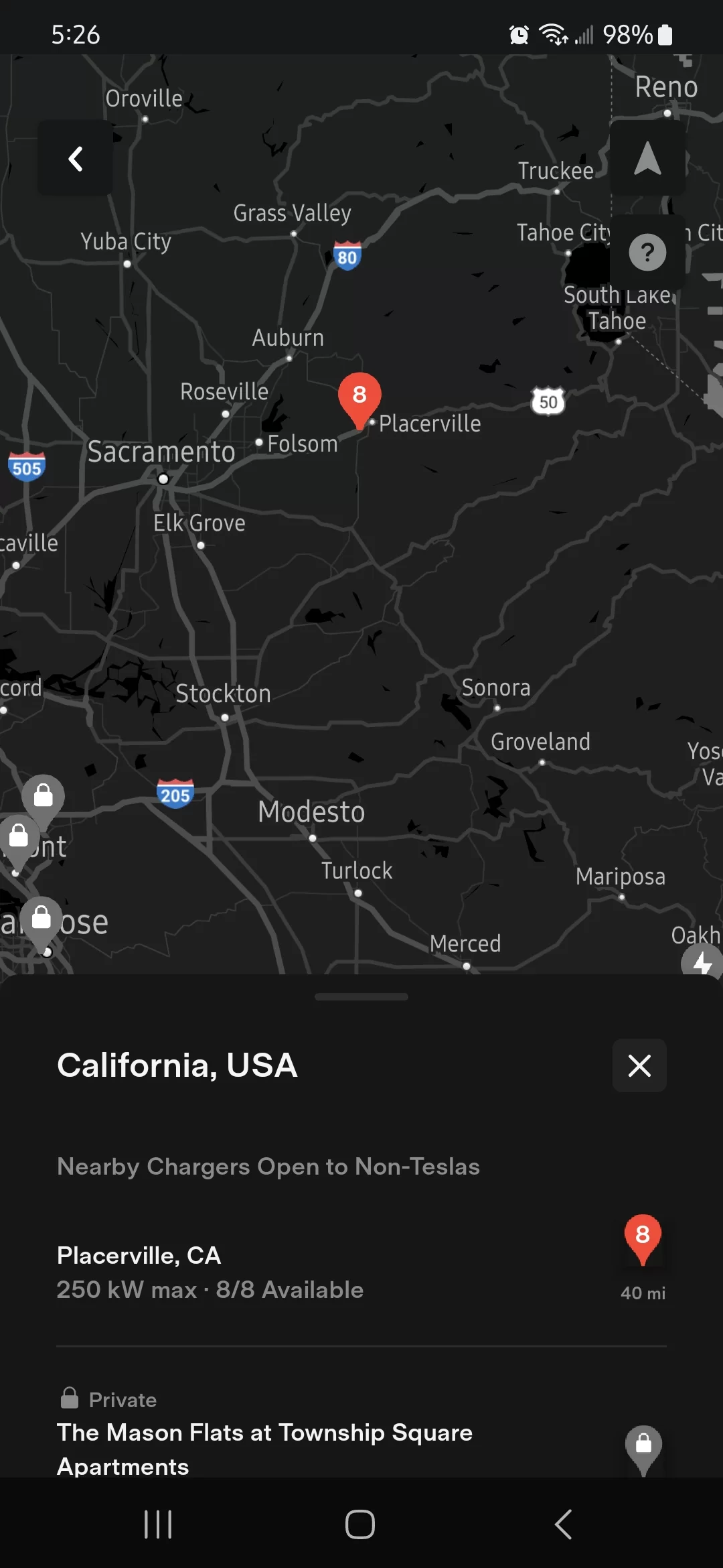

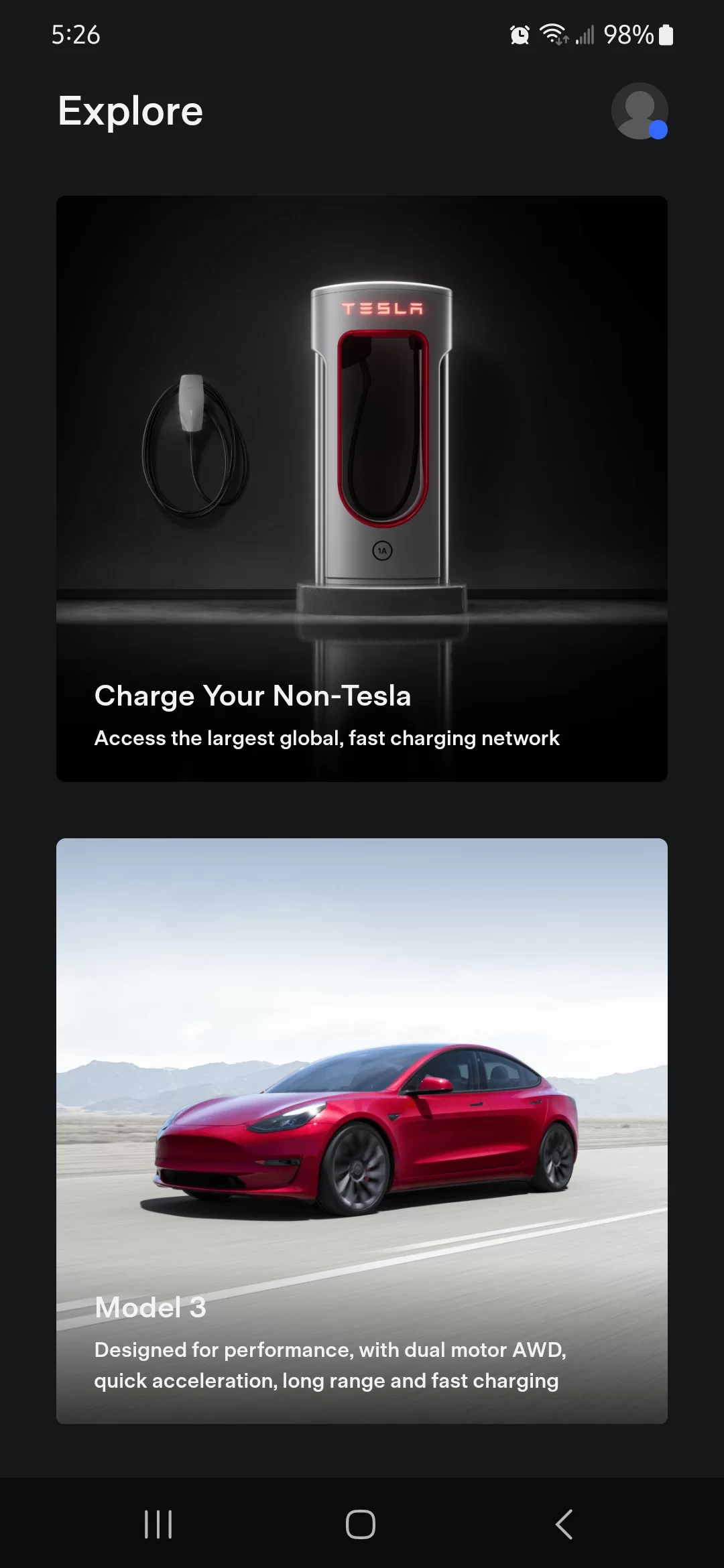

Open up the Tesla app and click on charge your non Tesla
Then when you search you will get a map like such
The available locations with a ccs1 adapter/magic dock will show up in red.
With older superchargers, V3 and below, you will max out at 50kw, so be prepared to take a while to charge
wow. Thanks. I see many in New York State but none in the mid Atlantic or south East. Although I see some destination chargers.
