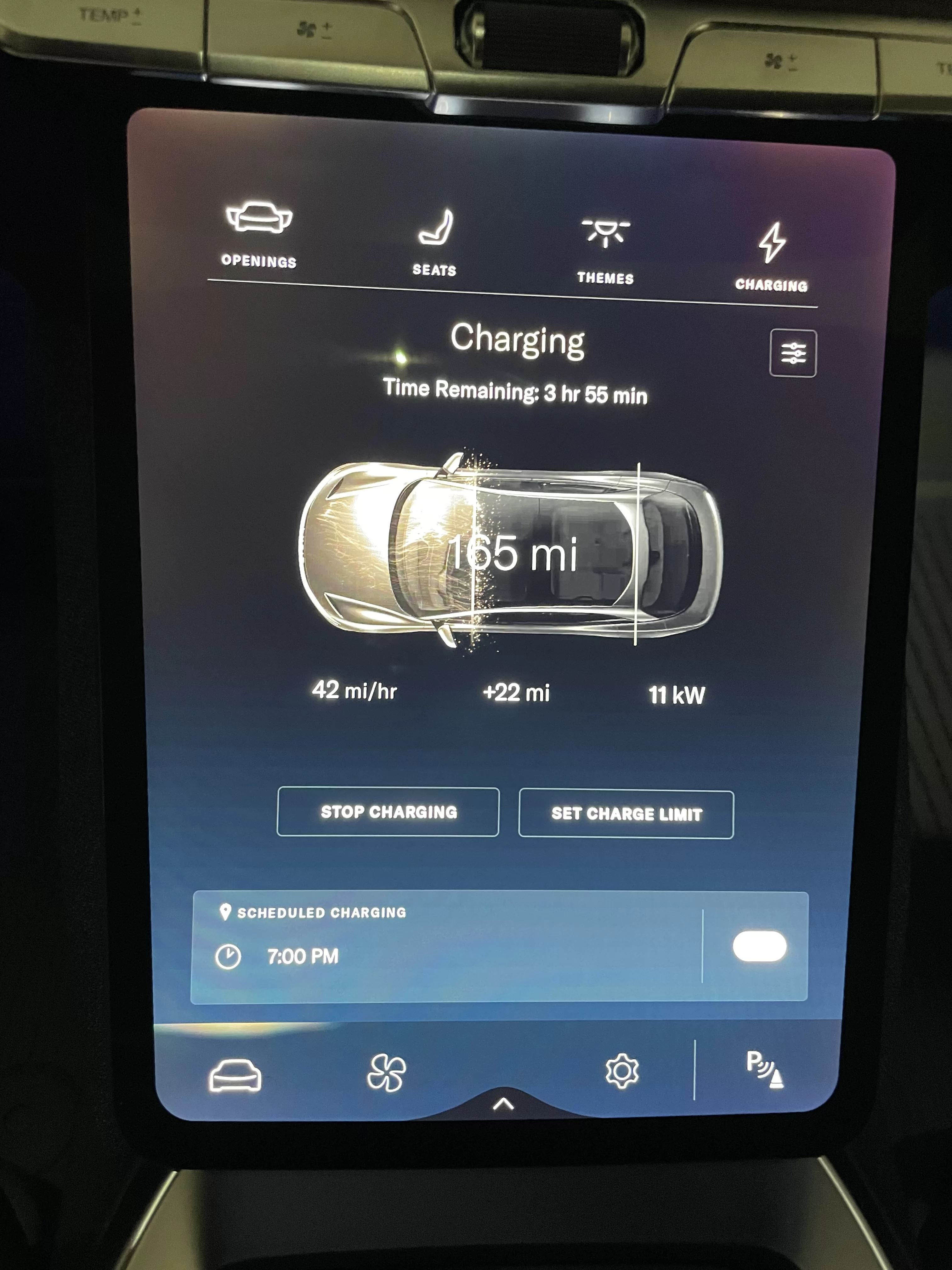

New Touring owner here as well with a Tesla Gen 3 Wall charger. I ordered the new Lectron NACS to J1772 adapter and it just arrived today. Car is charging at the same speeds as my Model S did - about 11kw at 48A.
As for heat, it’s been charging almost an hour and the Tesla handle is warmer than the Lectron which was very cool. The heat on the Tesla handle is what is normally feel
