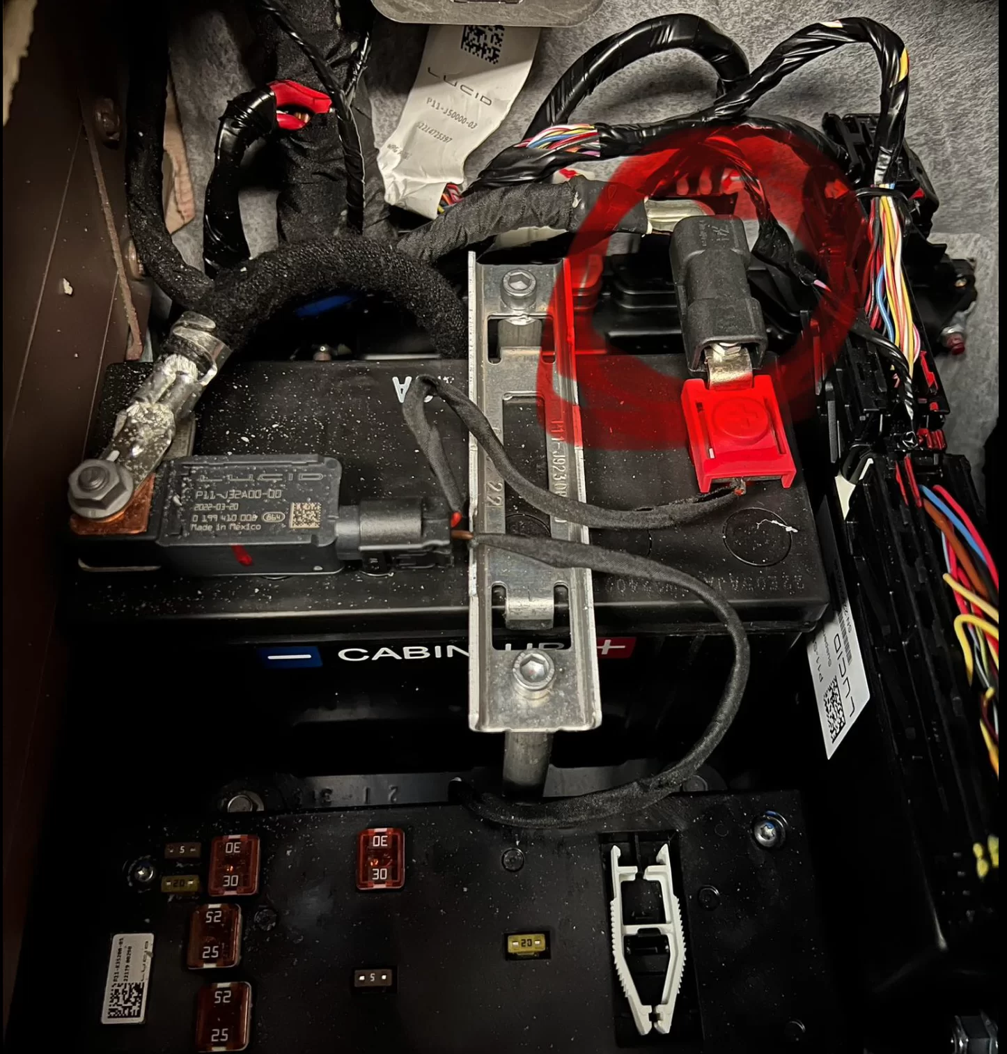

This youtuber was getting an electricly dead lucid back to life and did a big teardown and magically for just a moment at around 4:36 he shows the suspension control module and says where its located: in the back right corner of the car with the 12v battery. Now since I'm currently not at home and cant look for myself I looked into where i could find the module since i've been at that battery once or twice for something else and didnt see it before.
Then on the lucid owners club facebook group this image appeared: The dang thing was literally sitting right next to the battery the whole time and i missed it. The black box in the bottom right of this image with the white lucid label. Part number is : P11-SESD10-xx with xx being the revision and i've seen 05 06 and 07 around before and its made by continental and from what i could find was originally used in a certain mercedes models (C class - W205, E-Class - W213/W238, and GLC-Class - x253). Funny enough in this image at the top you can see the part that caused the 2022 recall p11-j50000-03 which is the car wiring harness(?)
So while i still dont have it solved, I figured since this thread is the only real resource anywhere about this issue, that I would post all the info i've learned so far
So I have good news! I was able to find the issue and solve it. On the suspension control module at the connector furthest from the back of the car the first 2 wires in that connector are the power and ground wires and there is absolutely NO slack in how its wired. Well the furthest thing in that is the power terminal, which once i used a back probe to check it.... it reseated the terminal and the error has completely stopped. I know there was a recall in 2022 for that wire being too lose in places but at that location the wire doesnt even have enough slack to properly handle shrinkage from temperature at the very least let alone if something jarring happens.
Part of the recall (I don’t remember) may have been to lengthen that wiring harness. It might be worth asking service to see if it was ever done on your vehicle.
