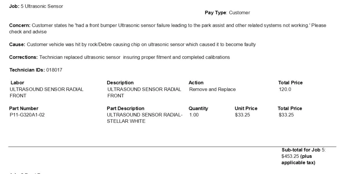

Well I'm not paying the $2,300 that's for sure. Out of curiosity which one of the front sensors did they have to replace on your car? Was it one of the two that are basically on the sides of the front bumper? Or was it one of the more centrally located ones? Evidently that can make a difference
Attaching snapshot from my service receipt so you can shove it in the face of whoever is asking you for $2300...I don't exactly recall which sensor it was but I think it was the one towards more the middle of the bumper.... not the extreme side of the bumper...good luck...

Thank you. I know it kinda stinks. But, with the amount I drive, it's unavoidable. But, that shop is basically trying to commit highway robbery. I really hope it's not because they know I'm 6 hours from the nearest actual Lucid Service center.
You can’t PPF the sensors; shops will cut out the PPF for the various sensors around the car.
I paid $553.96 in 2023 for one sensor on the front left closer to the center than the side. I could not see any damage until they pointed it out...a tiny crack in it.
