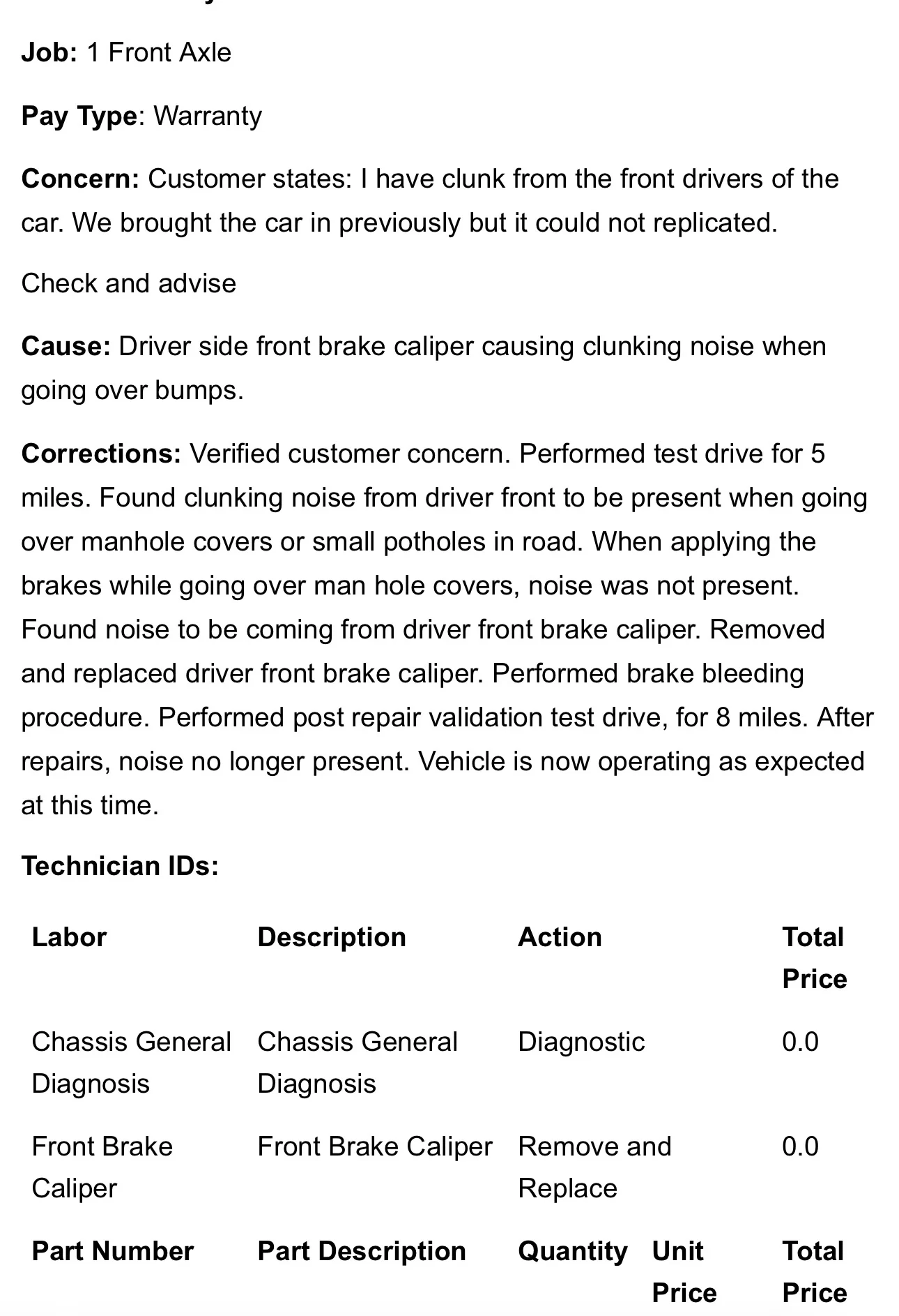

Looking back on the service invoice it reads that they replaced the LH Front Damper Spring Assembly. I can provide a copy of the report if you like. The clunking noise was eliminated.

Did you ever get the clunking issue repaired and if so, what was the cause?Based upon your earlier video, I am experiencing the very same. Thank you.

Thank you for your quick response. I am expecting a call back from the Richmond Virginia Service Center with an appointment. It is a two hour drive for me, so not the most convenient. I will post my experiences once the visit is completed and hopefully, include information regarding resolution. By the way, when you experience the clunking, do you feel vibrations through to the steering wheel? As best as I can discern, I do not feel such vibrations, which may or may not help isolate the cause. Again, thank you.
