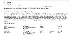

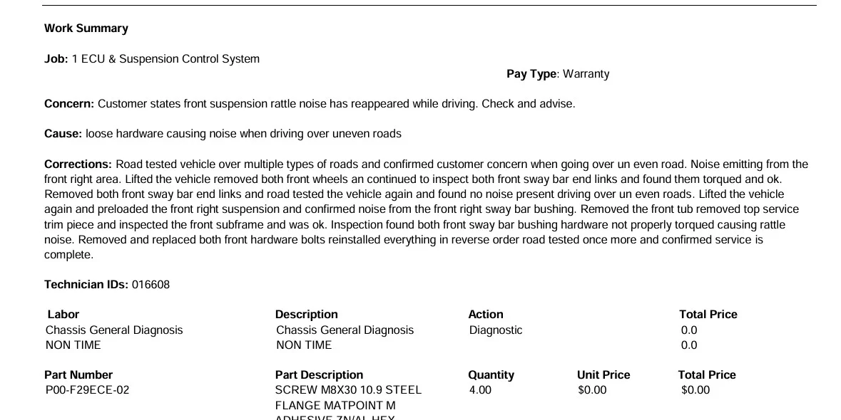

Yes had this with my 25 Touring. Was in the shop for three weeks and they think they’ve found it. I’ve had it the entire time I’ve had the car but progressively got worse. Started with once a day and then got to once every mile.
