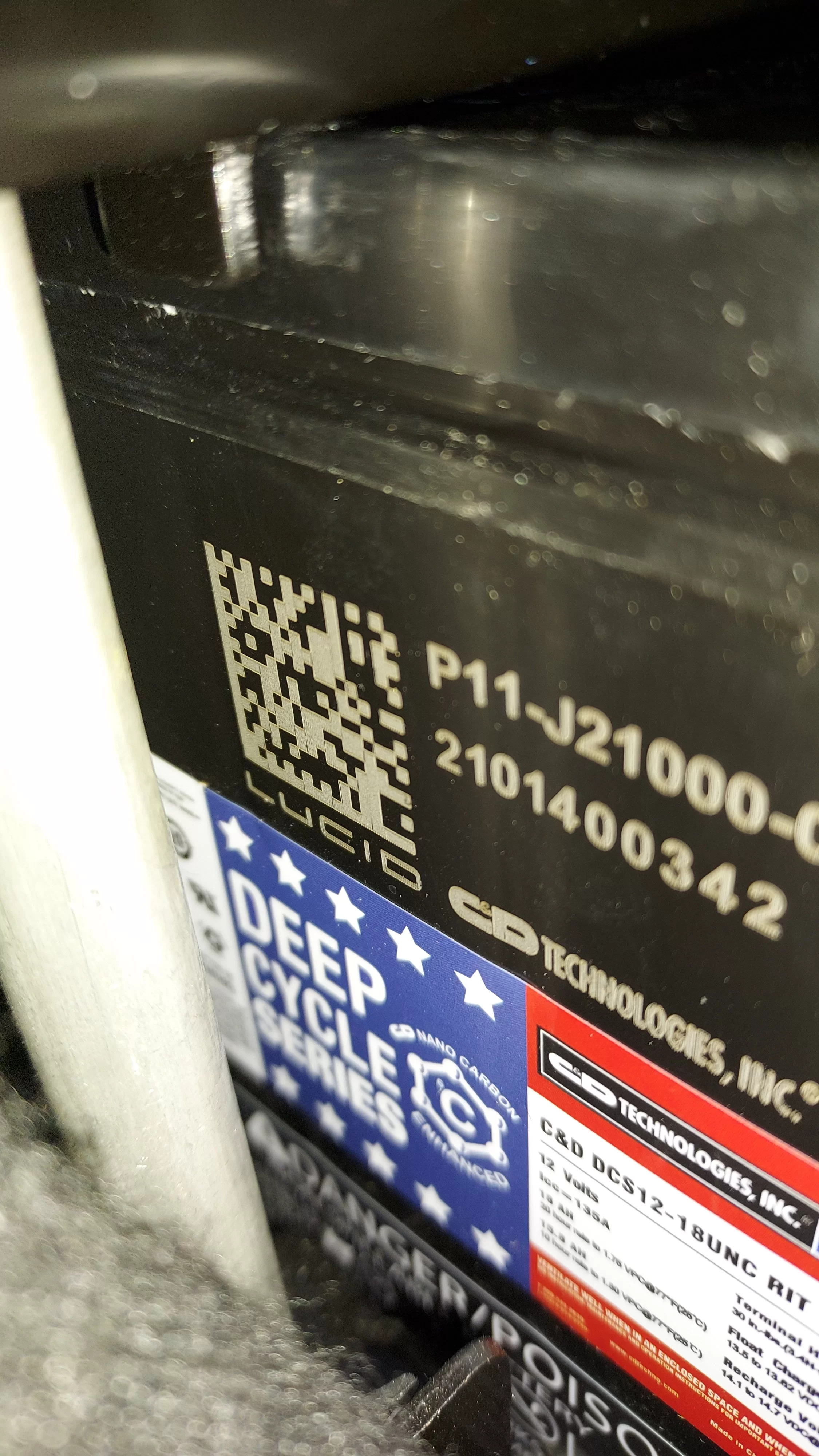

Lithium or Lead Acid?
Hmm the rear one is easy to access front not so much. Let me try tomorrow when service comes to take my car, again...4th time now
Here's a picture, maybe someone can decipher.
All of the batteries on their web site are lead acid, either AGM or VRLA. I beleive this is VRLA.
