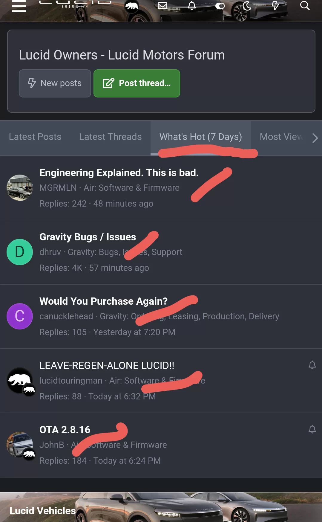

Agreed...someone at Lucid needs severe re training on how not to mess this up again...I'm very quickly losing patience with Lucid after 3 years of rolling with the brand...! Unacceptable
I think it's telling when over the last 7 days the hottest topics are ALL about issues with the car...! Arguably, the forums do attract more negative comments but still...doesn't inspire confidence 😞
