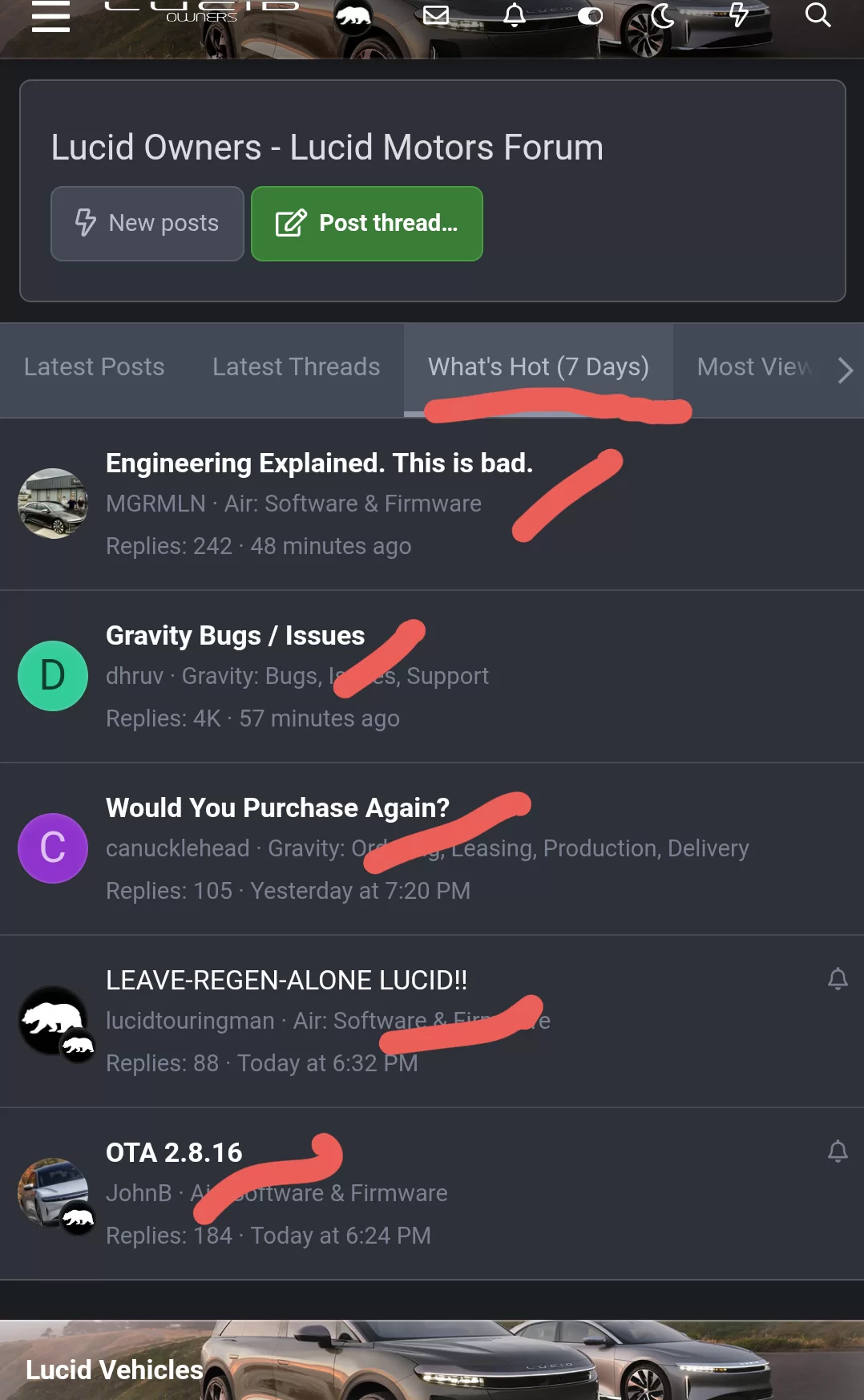

I think it's telling when over the last 7 days the hottest topics are ALL about issues with the car...! Arguably, the forums do attract more negative comments but still...doesn't inspire confidence 😞
