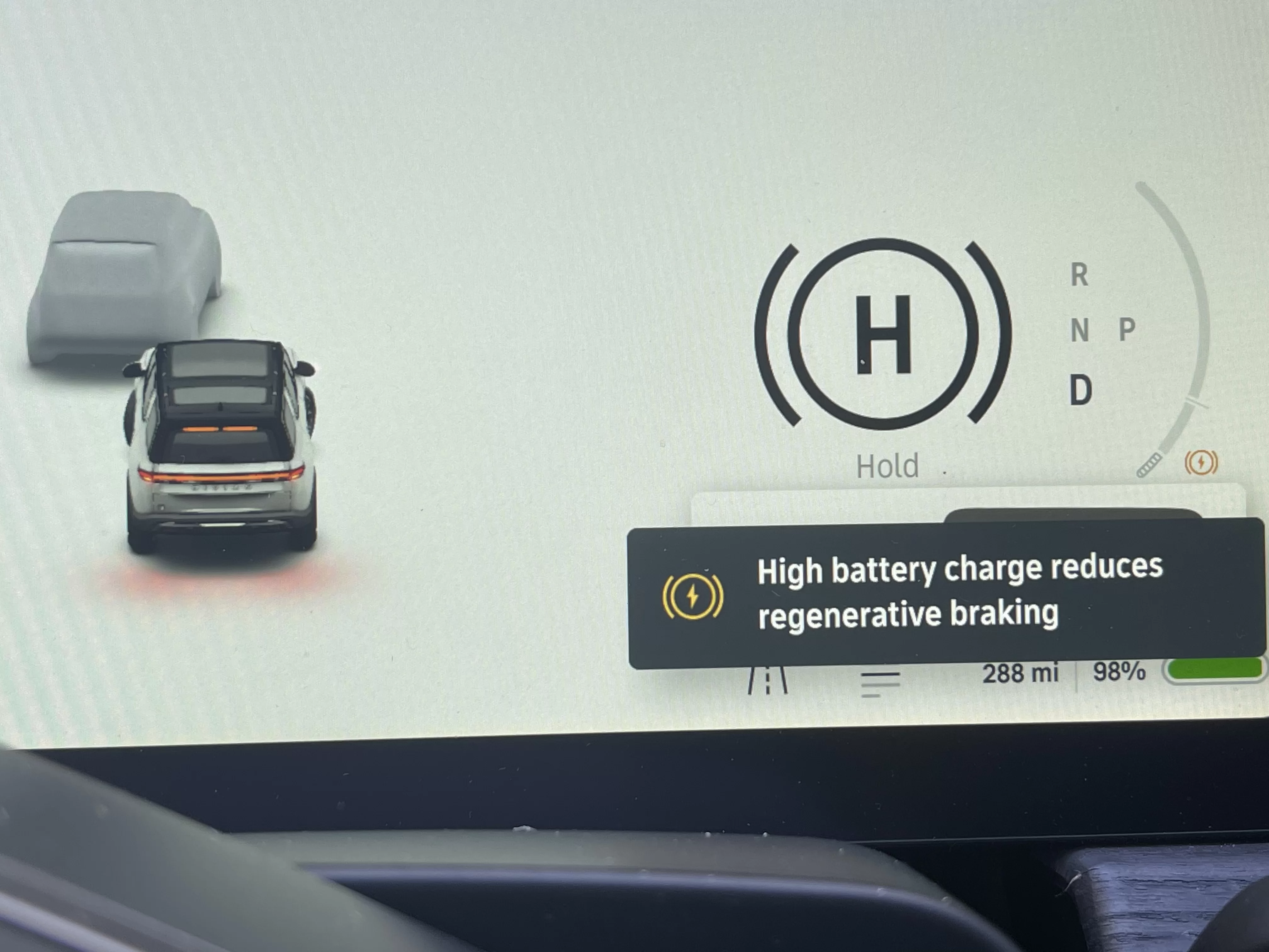

I was not aware of this and had concerns that something changed in my settings. I fully charged to go on a trip and the regen not working was a complete surprise.
I do wish there was some kind of indicator when power/regen is reduced because of SoC or weather. I live in the North East, in the winter months my Tesla would indicate on the power/regen radial how much was unavailable until the battery warmed up. Hopefully Lucid implements something similiar. Especially for regen, its jarring and potentially a safety issue when you expect it to be there and its not active!
I had trouble with my regenerative braking that I couldn't fix through settings but "went away" Then I stumbled onto this thread. Looking back I set the maximum charge for long trip shortly before the issue started. Assuming it was high SOC that impeded the regenerative braking and it went away once I reset the max charging point to 80%.
Agree that there should be some warning if braking is altered from expectations. Maybe even setting full charge at less than maximum capacity so that the regenerative brakes still work? Definitely a safety issue that should be put on the "wish list".

It’s neither unexplained nor unexpected. If you have cruise control or HA engaged the car will accelerate when traffic clears. If you have charged to 100% regen is not available.

thank you. This answered my question. I noticed this on driving after a full charge and it was quite a surprise.

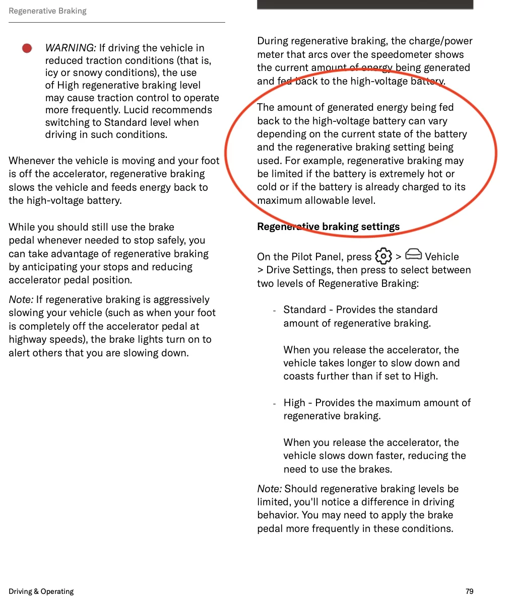

It may sound silly, but it's really important to read the owners manual.

In this case, I think the point was that reading the manual would have kept this from being a surprise and potentially dangerous. There are lots and lots of other things in the manual that are important to know for safety, as well.

I absolutely think Lucid should add a warning about regenerative brake loss when the battery is fully charged. But I also think every car owner owes it to themselves to read the manual before driving.
